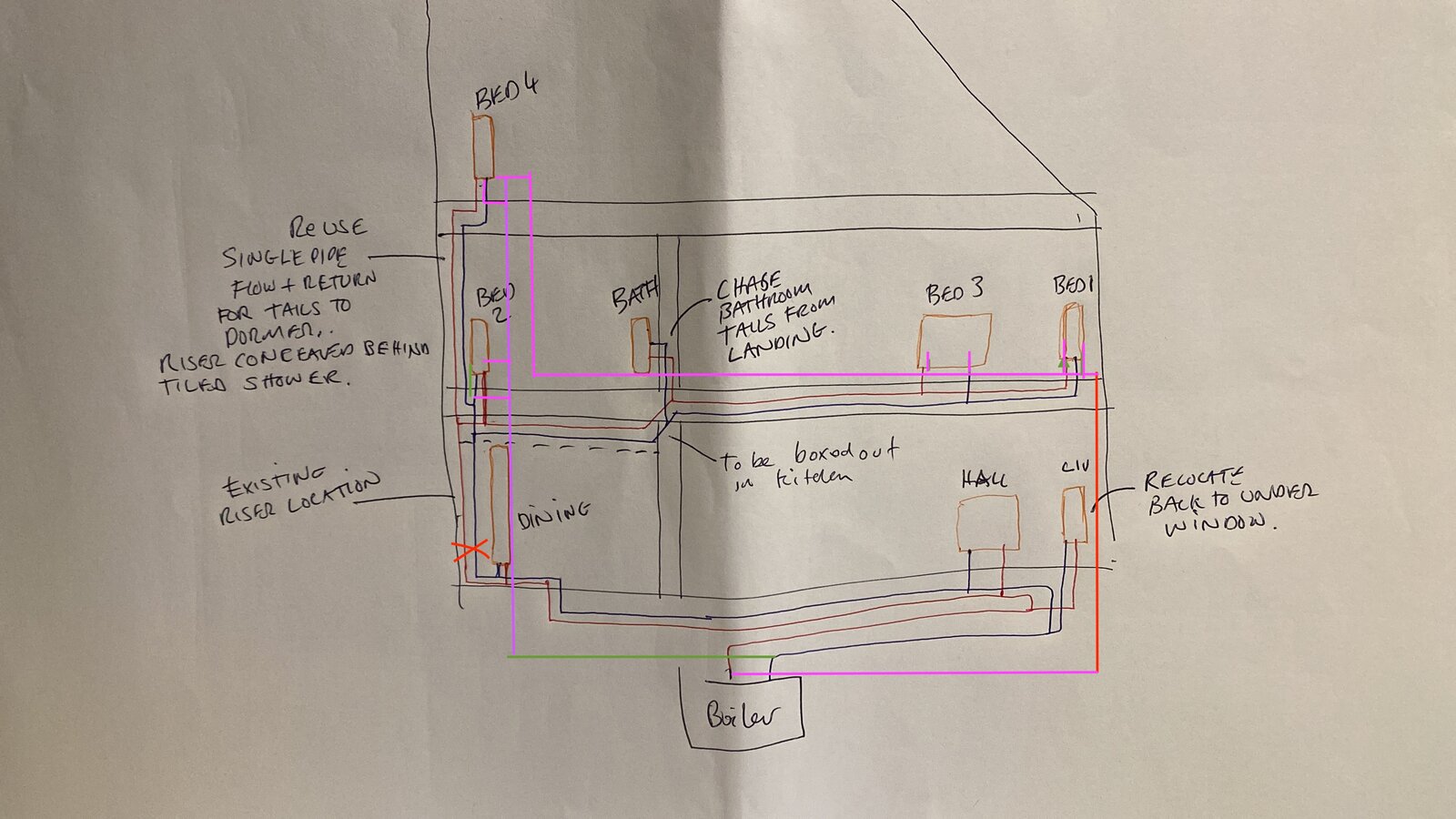

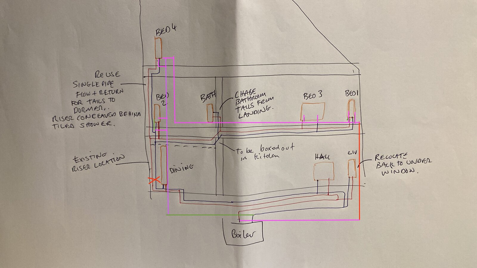

Is it possible to phase the rollout of the two pipe, ie T off flow and returns for the ground floor rads only as two pipe leaving capped connections for rolling it out to the upper rads later.
Yes, although it may affect the one pipe rads you leave in place.
All, not sure trains are quite the same, but I do appreciate the not broke don't fix, they changed the Bristol London line to electric then failed to complete so made hybrid now its slower and heavier than the old diesels.
However at the moment we have no carpets or flooring down so best time to rip into it.
Its a simple design, a 1 inch loop feeds two downstairs rads, then the upstairs 5 then back down to the last one in the living room and back to boiler. That rad doesn't get hot but as the return is hot at the boiler I reckon its plumbed badly or possibly one directional or sludged up.
Plan would be to blank off the tails to the one pipe for the ground floor rads so the loop runs for upstairs only
We would then plumb new two pipe to the three ground floor rads and T into the flow and return near the boiler..
Do we need some sort of balancing valve on the flow to ensure adequate flow to each loop as they assume they will have different resistances, not sure we have any pump control with the Combi.
We would propose running all the new pipe work and installing new rads but have a plumber install any valve connections for the flow and returns and possibly pressure test it all first.
Makes sense in my head but have had one plumber suggest phased is fine and another say it categorically won't work and rip it all out now.
To go full two pipe now doesn't look that much work as only some locally lifted flooring required, awaiting a quote but not hopeful they can do it in time.
Any thoughts appreciated, my problem is we are supposed to fit carpets Friday to 1st floor and stairs and move in next Wednesday! EEEEEKKKKK so access will be lost.

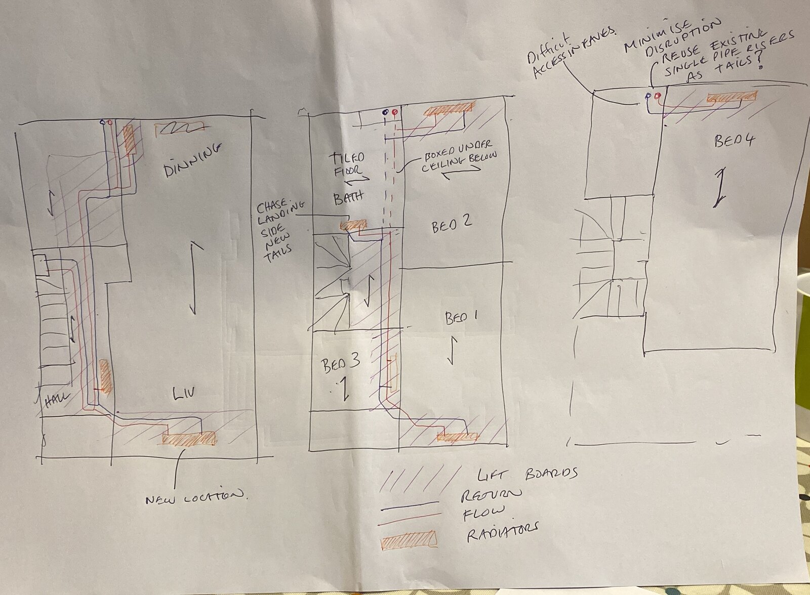

Schematics attached, one pipe in pink on the section, two pipe proposals only on the plan.

TBH if you are quite handy with pipework then converting the 1 pipe to 2 pipe isn't a huge amount of complexity, especially if underfloor access is easy. The hardest part is routing of the pipework then it's just the cost of the materials
Take a 22mm F&R pipe along from boiler up to the 1st floor and then into the hall, then it's just running branches out in 15mm and a 15mm feed up to the 2nd floor.
I'd suggest you do it before the carpets go down otherwise it will just be a large amount of grief later on.

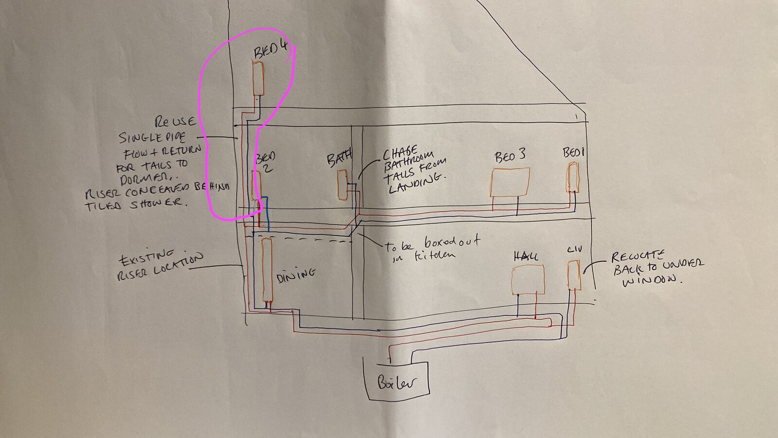

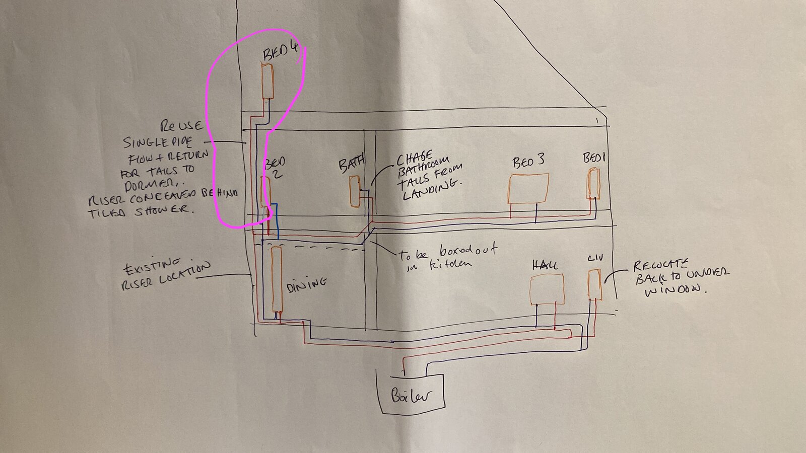

For the top bedroom 4 radiator, we can't easily run a new flow and return to it at the moment without boxing out into a bedroom, we might be able to connect the old one pipe connections as tails from the 1st floor level flow and returns. Tails would be a bit long though at 5-6m but the heat should rise for the flow or do we absolutely need to run the flow and return loop nearer to the rad.
