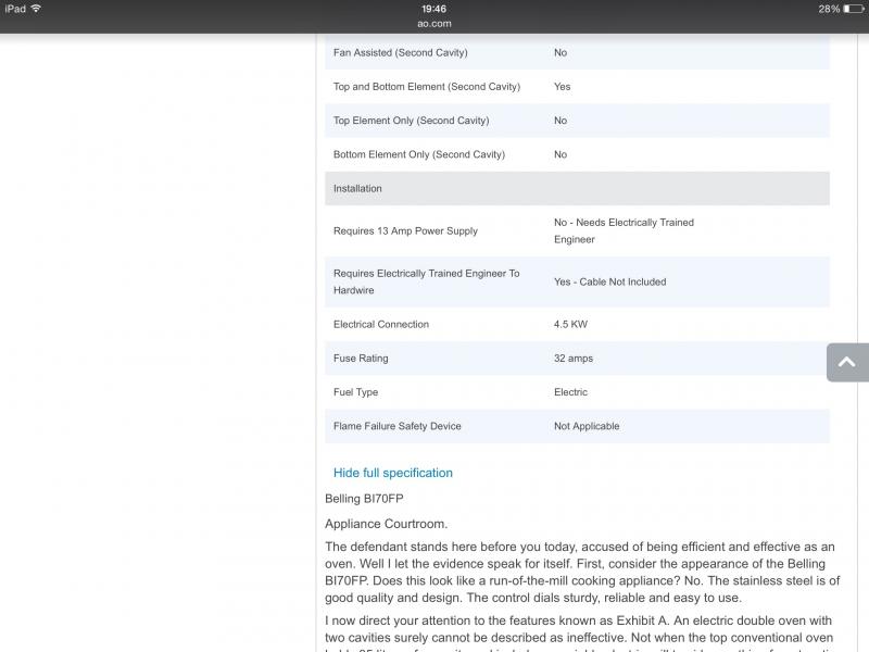

The current oven is hardwired into a 'cooker' switch on the wall but as it's a single oven only needs a 13 amp. The new oven we're looking at needs 32 amps.

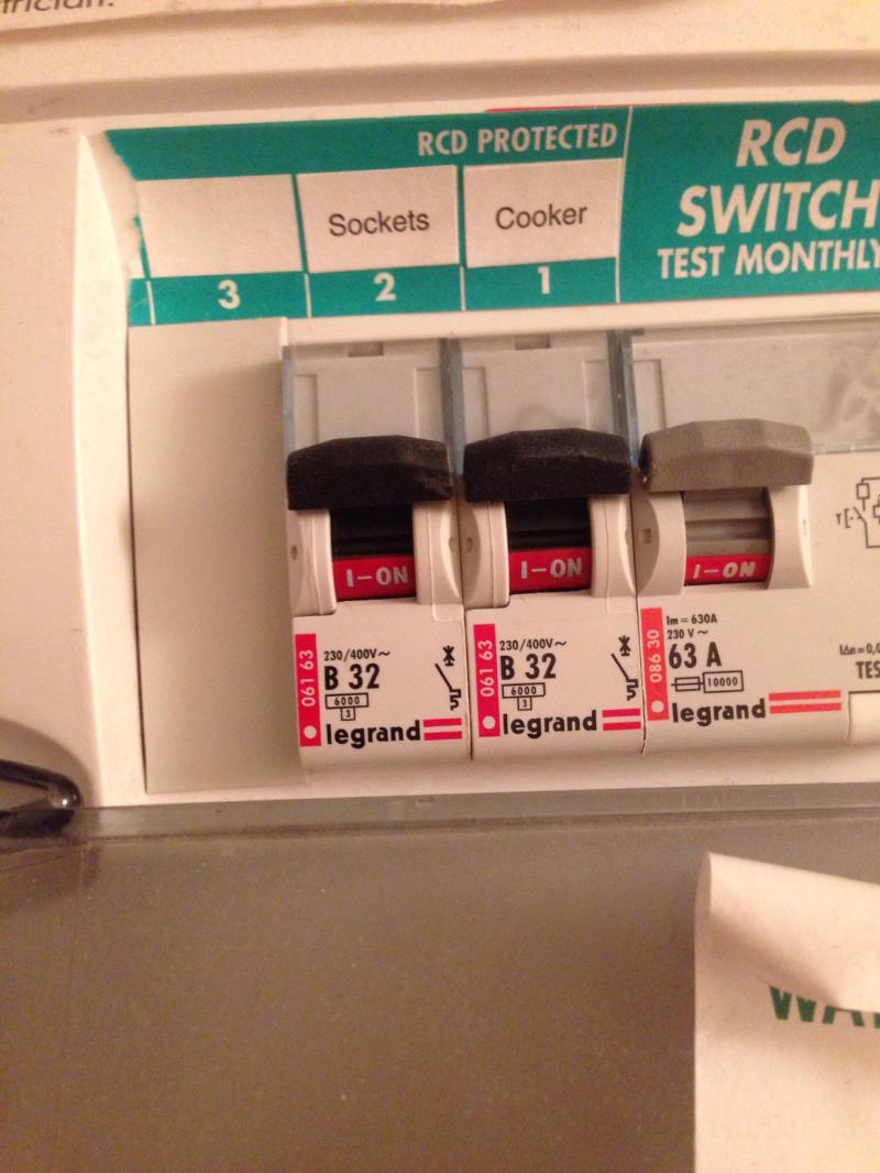

I've looked at the circuit breaker box to see if there's a clue as to whether the wiring will take the new oven or whether it needs redoing.
If I'm understanding it right, this is a 32amp breaker and I should be ok to get the new oven wired in to the existing socket, but wanted to ask and check.

Could we see a photo of this 'cooker switch'? What does the new oven say about its power/extricity requirements, and how it should be connected?
If the cable used to wire that circuit is appropriate (probably 4mm² or 6mm²) for the 32A breaker, then it should be OK for your new oven, but you really ought to get an electrician to confirm that the cable actually is appropriate/ adequate.

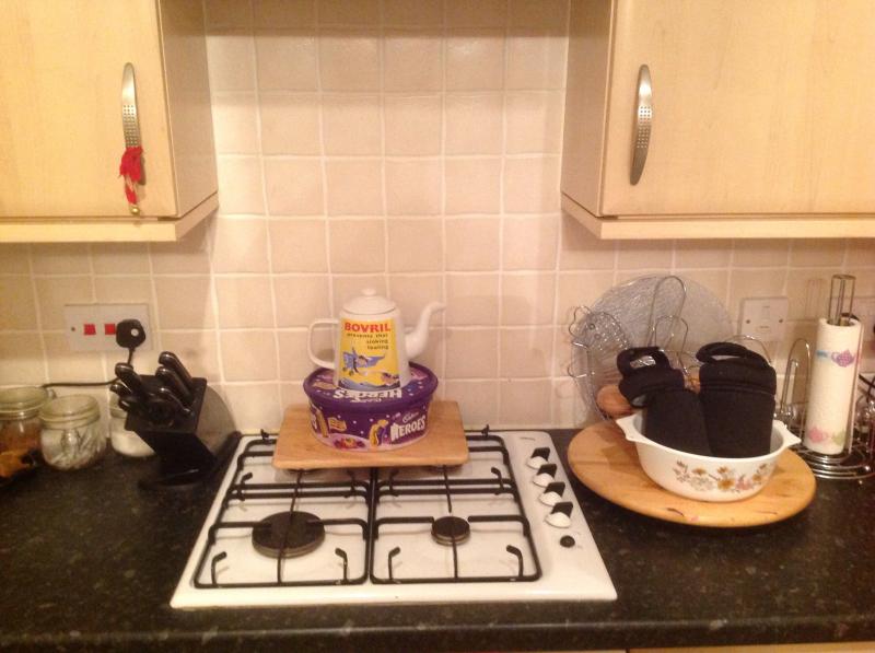

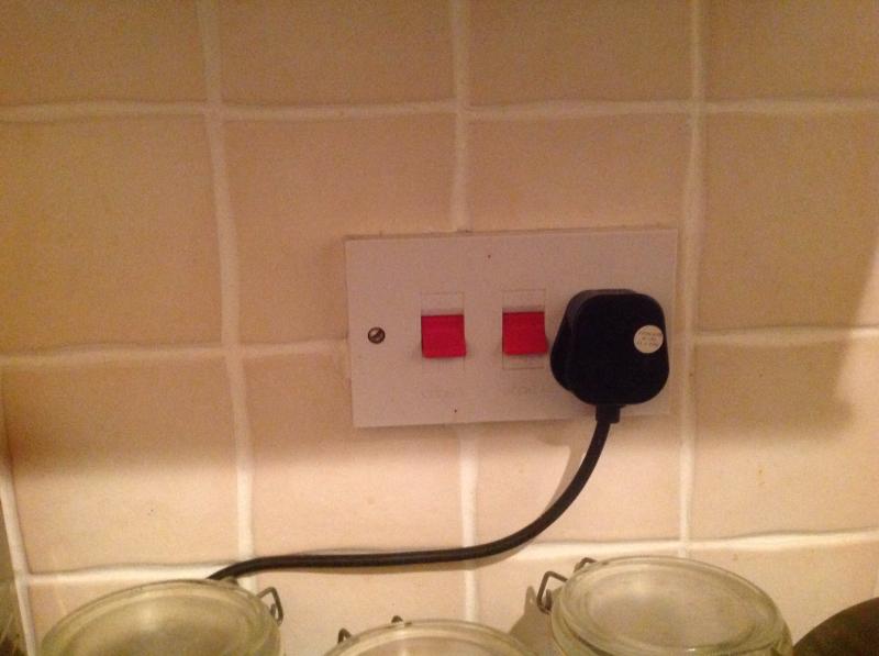

Attached pictures of the cooker socket - the switch for the cooker hardwire is on the left. The other picture is the screen on ao for the electric requirement. I guess I'll likely pay them for installation as I don't have the skills needed, but I need to make sure it will work and won't need a massive rewire.
Thanks for the replies. ... Attached pictures of the cooker socket - the switch for the cooker hardwire is on the left. The other picture is the screen on ao for the electric requirement. I guess I'll likely pay them for installation as I don't have the skills needed, but I need to make sure it will work and won't need a massive rewire.
The crucial question is whether or not the person who installed that cooker control unit connected the 'cooker' side of it to some sort of outlet below worktop level. If (s)he did not then (a) there is probably no solution which would not disrupt your tiling and (b) the suppliers of the oven would almost certainly not be prepared to install it. With any luck, the person who installed that cooker control unit will have thought ahead and wired it to some sort of cooker outlet plate below counter level.

As JohnW2 said, there is a chance there is a connection plate under the work top sunk into the wall. Should be fairly obvious. Don't poke around until the supply is off !

The gas hob does have an electric sparker. Again, not sure where the power comes from, but on this photo (excuse the mess) the fuse and switch for the sparker is over on the right.
