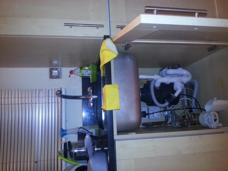

Hi guys i have just moved into an apartment and none of the wall switches seem to work. I have changed all the fuses (like for like) but the lights don't come on.
On the same subject the switch that controls the sink incinerator doesn't work (I am assuming it's for the incinerator) I have uploaded images.
Does anyone know how i can fix this?

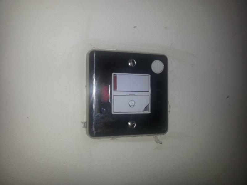

The second image shows the wall switch for what i assume to be the underfloor heating.
Thanks guys :D
The second image shows damage to fuse holder, so that would need replacing.
Have actually checked that power is being supplied at the board?
Are they wall switches for lighting or are they fused connection as displayed in second photo or are they a mixture of both?
There could be an RCD or an MCB at the board that needs resetting, I assume there was nothing to suggest an issue with the the electric installation during the purchase.

If the OP has replaced fuses 'like for like' the appliances still will not work.
He should replace blown fuses with new ones.

I take it you mean the switched FCUs for various appliances, and the neon lights in them, rather than the light switches and the room lighting?
As PBoD said - have you checked the CU?
How many "switches"? The plural suggests at least two but let's be sure. Even so, two fuses blowing is at least plausible, ten would seem unlikely and suggest one needs to look for a cause elsewhere.
As the saying goes: "to loose one fuse might be considered a misfortune, to loose two looks like carelessness."
