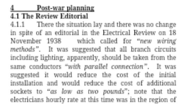

Interesting reading here:
https://docshare.tips/ring-circuits-history_59561033dc0d600757986b04.html
Apparently an editorial in the 1938 'Electrical Review' called for simplification of electrical circuits - although there is no record that this was discussed in the 'Wiring Regulations Committee'
... and again, this isn't proof that the ring circuit wasn't already in use elsewhere! :)

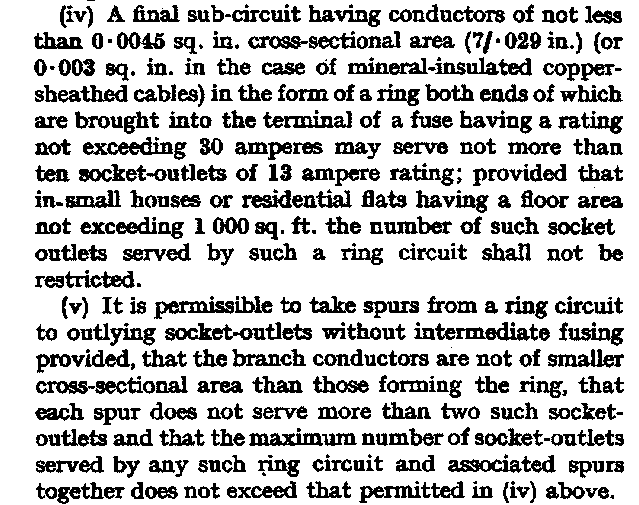

The ring final circuit, as in supplying 13A outlets, was first mentioned in the Wiring Regulations in the 11th edition, this example being the amendments from 1943 subsequently reprinted 1945.
Rings as a concept wasn't new, they had been used for submains previously, this example from the 10th edition 1934:
and even before that, any electrician or electrical engineer was free to design whatever circuit arrangement they considered appropriate for the particular installation.
The same applies today - if rings were deleted from BS7671, they and other variations of them could still be used. The difference being that proper circuit design and calculations would be required for each installation, including consideration of whether such an arrangement would be appropriate, rather than people blindly following the specification of one particular circuit design from over 70 years ago.

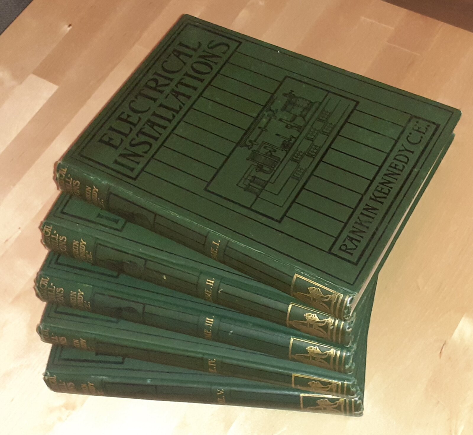

My presents have arrived! :D
...and nothing changes! ;)
As well of lots of mention about the benefits of using concentric wiring!
