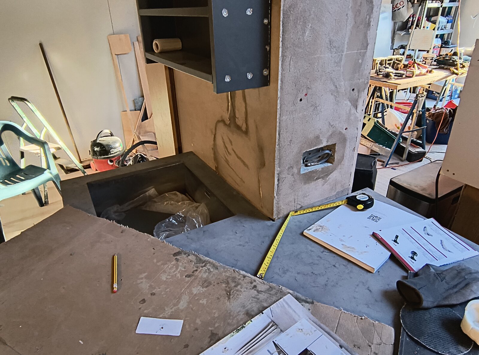

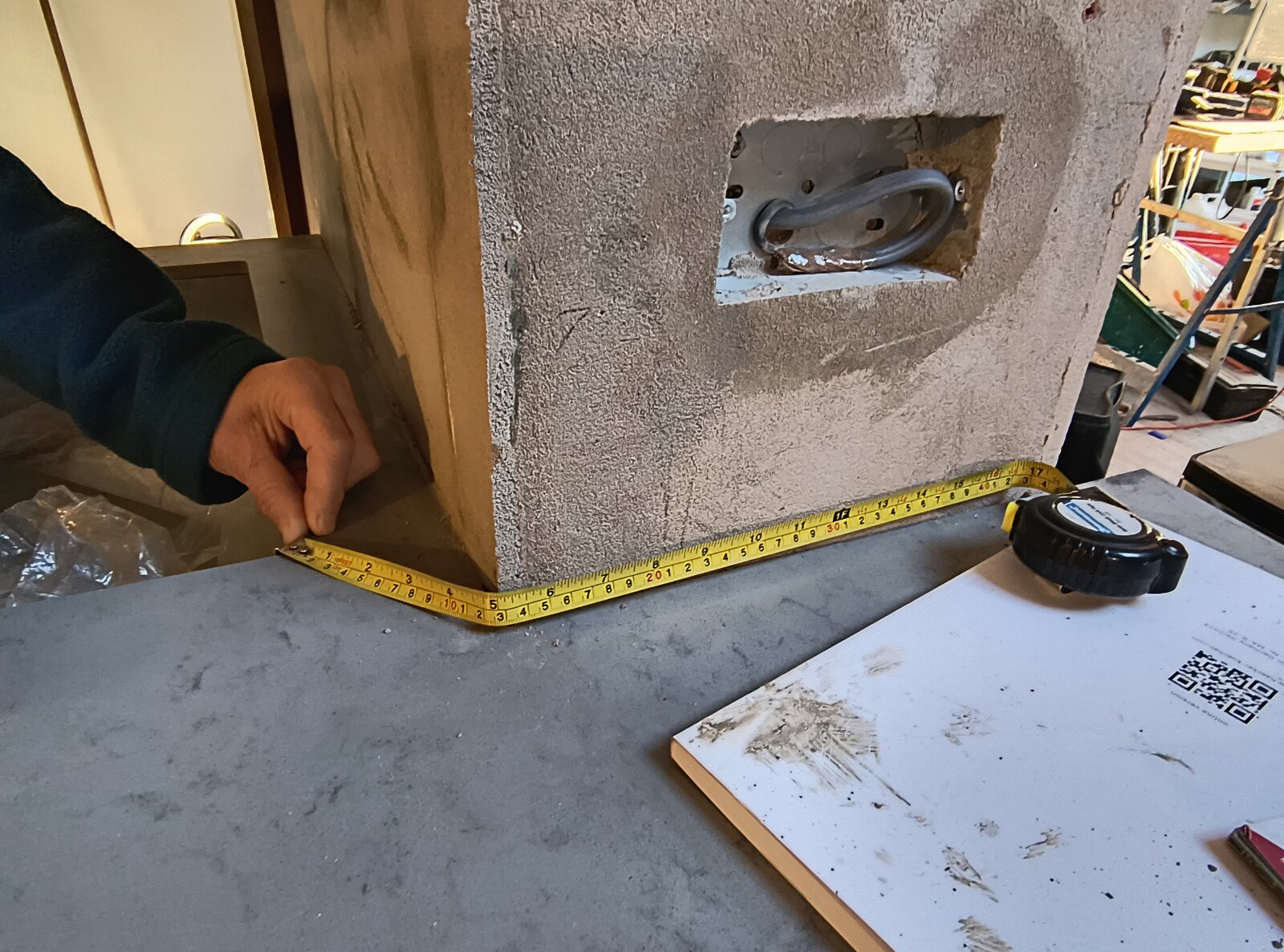

Sink to socket distance

I've believe 30cm - it isn't but it's round the corner?
Are you asking is this OK because I've done it? or is this OK because Kev the kitchen fitter has done it?
AFAIR there is nothing in BS 7671 but I try to keep to a minimum 600mm - at the end of the day most plugged in appliances have leads of over 300mm
I've done it, or rather my fickle wife has changed the location of the sink. I suspect the socket will be used on the breakfast bar side for phone chargers etc as there'll be a pop up in a more convenient location for appliances, and quooker tap so no kettle.
That has to be one of the weirdest places for a sink I have ever seen IMO. But apart from that where are the taps going - would that be the regs issue and not the sink itself
I think we’d need a plan view to make sense of what I think is an island. There are no regulation re socket distances in a kitchen. There is one re suitability for the environment.
