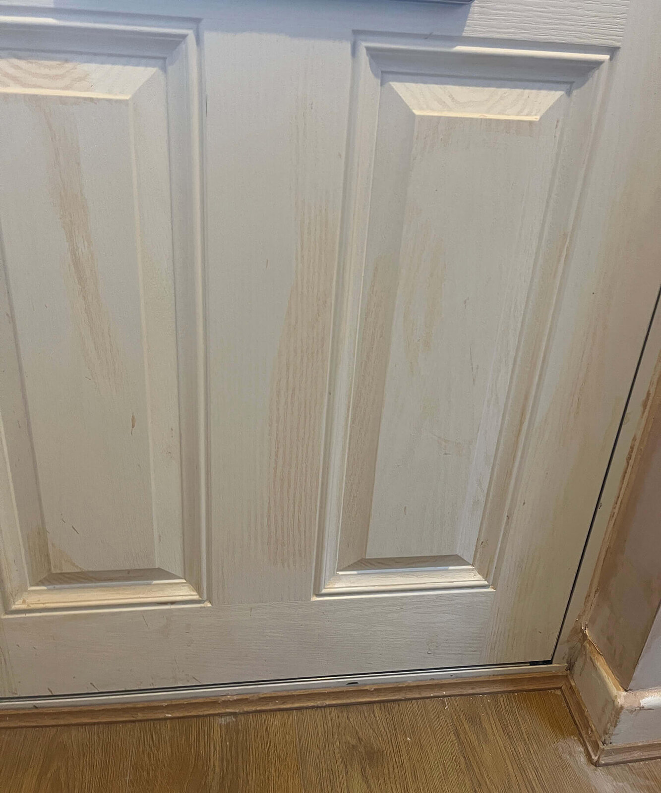

The finish on the downstairs apart from a couple of minor sections is actually good. It's just the rush job on the upstairs, and ngl the mess. Kind of concerned the plaster isn't going to come out of the skirting and the composite front door

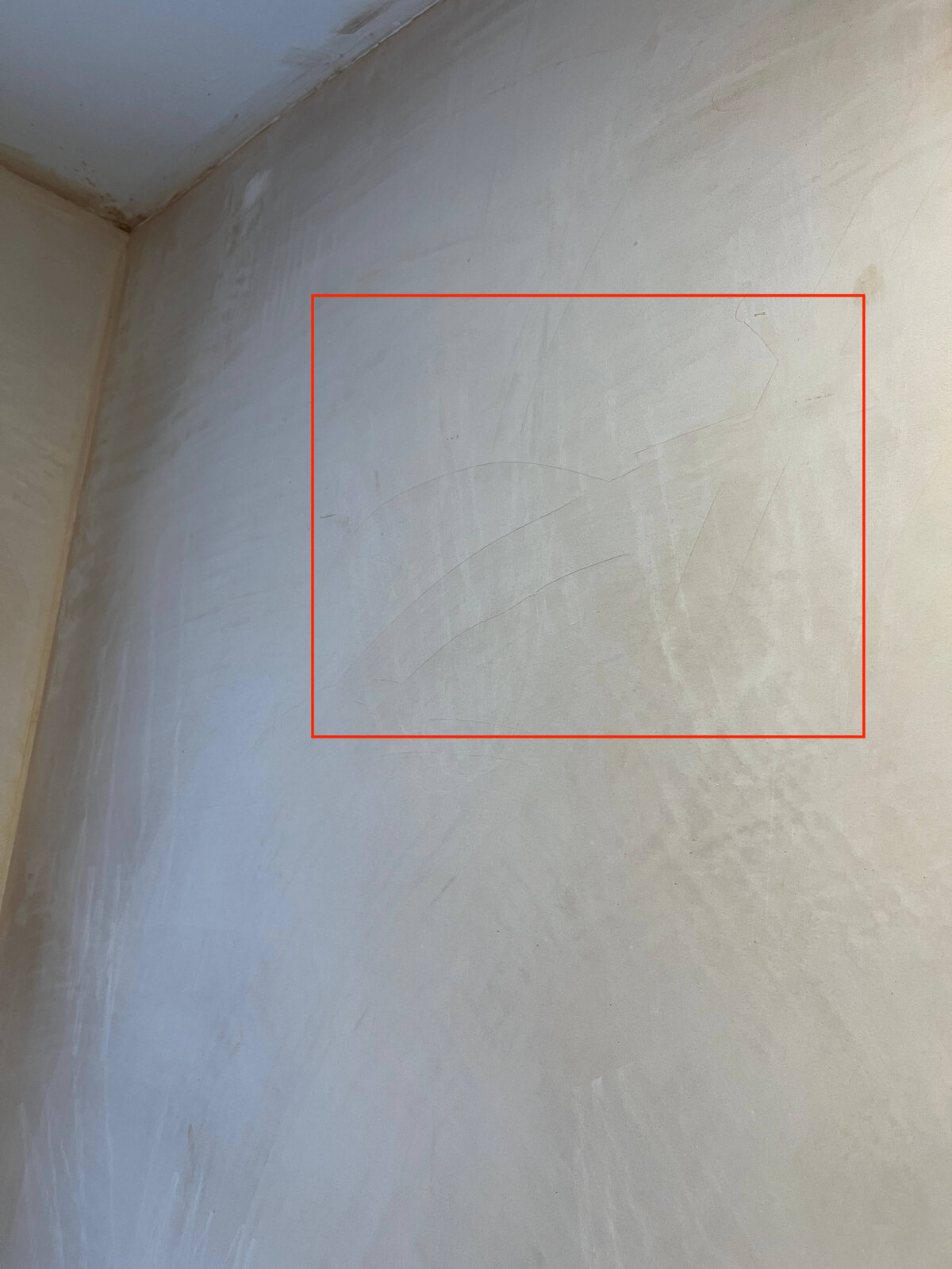

You should not need to sand anything .. have a grizzle

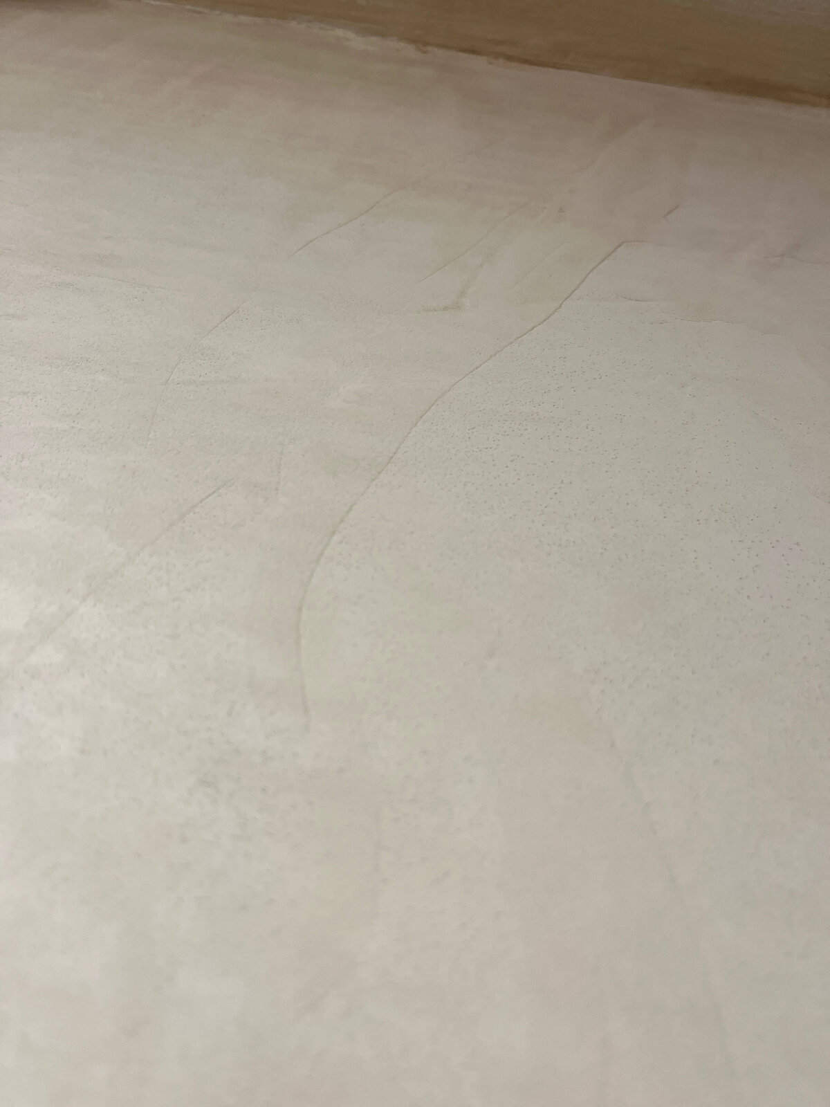

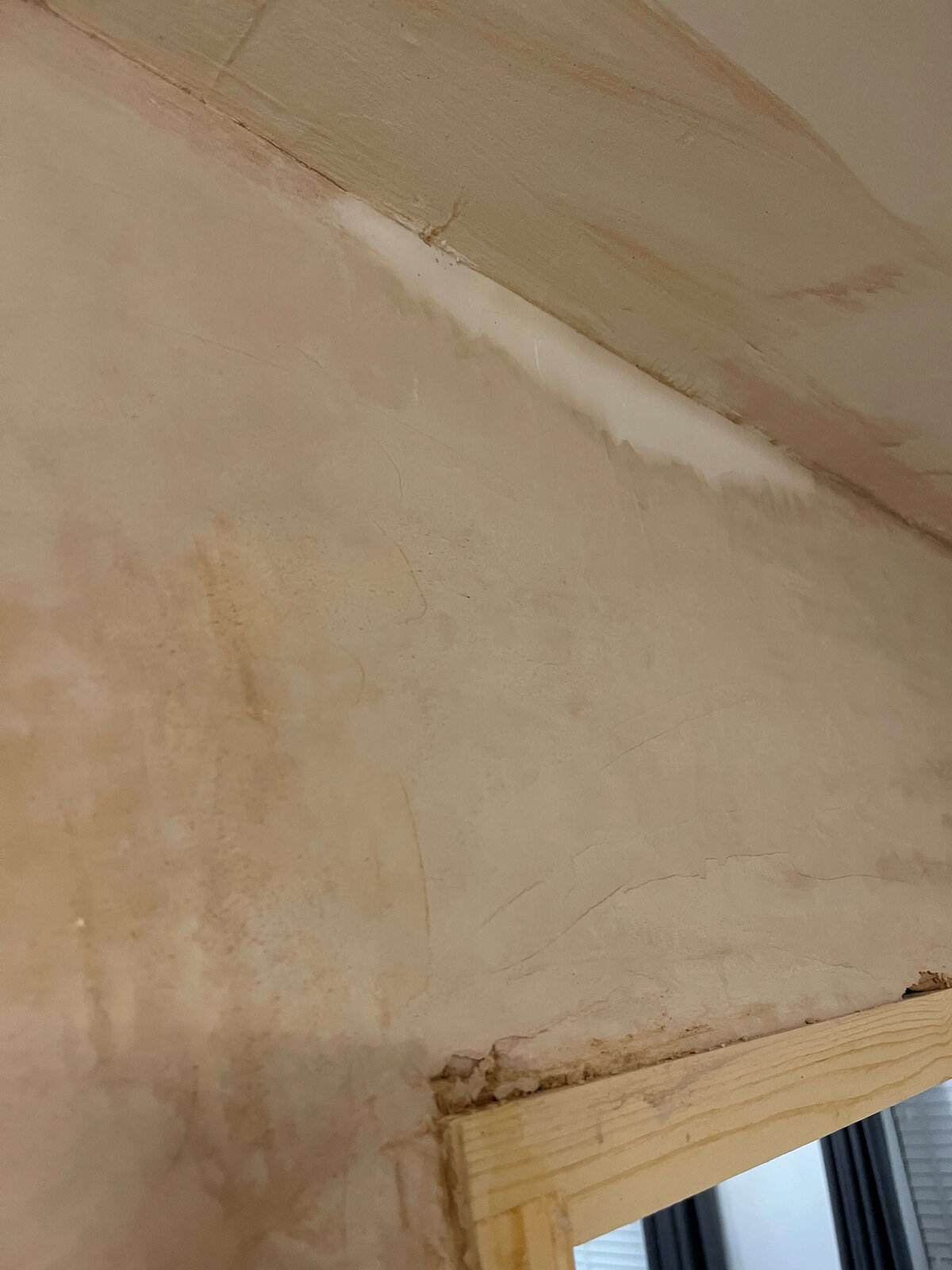

Thought so... Also noticed some tiger stripes today on the finish which is wonderful.
In my many years as a decorator, I have come across some extremely good plasterers. Even with their work, I expect a little bit of sanding.
I would not want to be the person employed to prep the OP's plaster.
That is crap plastering on the new photos. I assume you have paid them? I would phone them and complain again asking for a refund or for them to come and sort it to a good standard. Its unlikely to work but you never know.
Got them back out and they just sanded (with no dust bag) and left the place a state with my lungs taking most of it. Was coughing up **** for weeks.

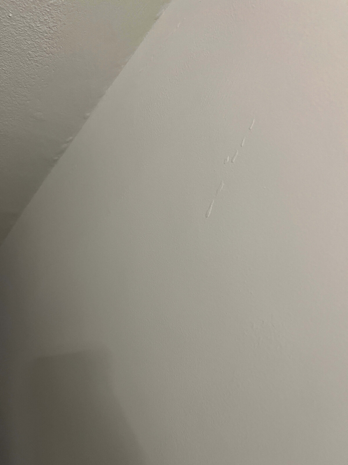

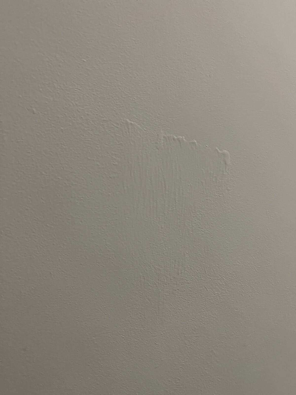

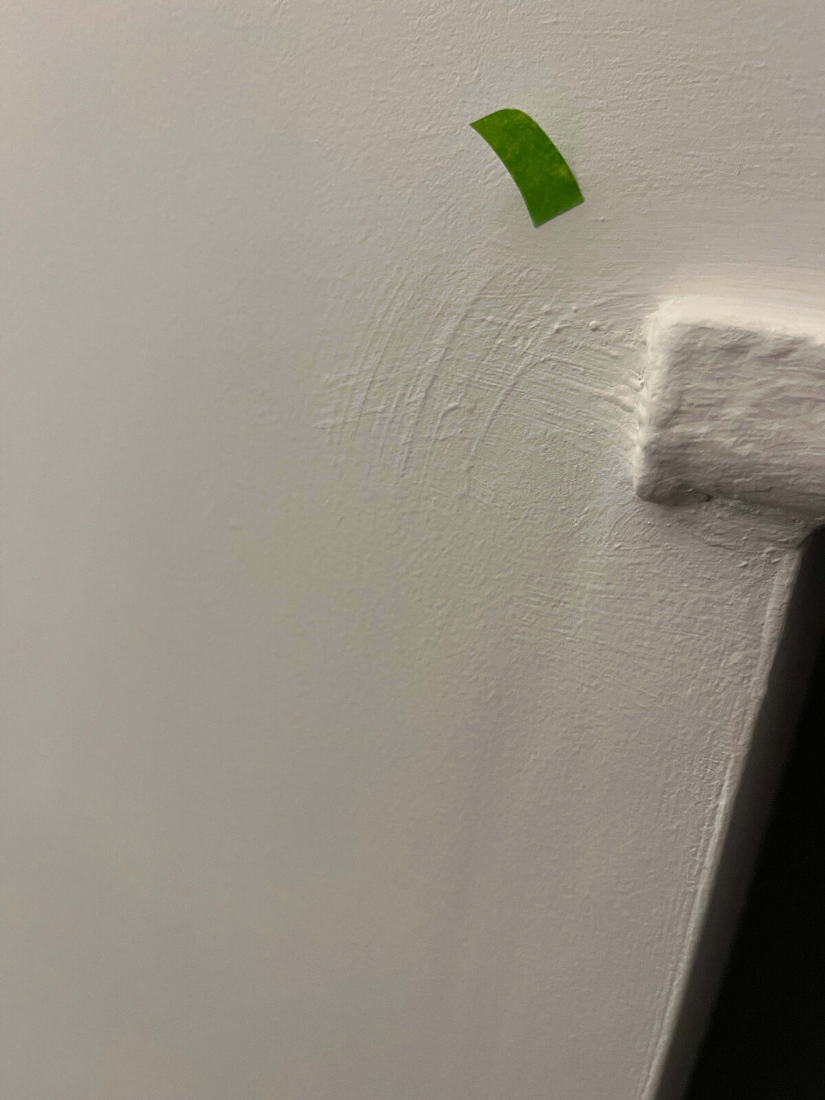

The decorator has been around and it's honestly not the best, decorator didn't do much prep either which has left a pretty crap finish on a lot of it, especially at night or in harsh light.
It seems that your decorator is as good as your plasterer...
Ngl this has all taught me a lesson in using word-of-mouth recommendations, especially from family... And a lesson in just trying a lot of things myself from now on...

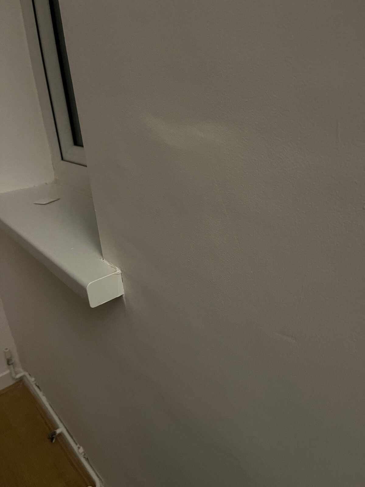

I know I can be a bit of a perfectionist but didn't think this was the finish of a professional decorator. Been on the tools must be 35+ years. Large parts are fine, but I'm going to have to just have to try and not look at the walls in a lot of places. Blamed the paint (LickPro), me, the plasterers etc.
I knew the prep wasn't as much as was needed but I did everything I could, told them in advance, said to come and please look at the job again now the plasterers have been etc. etc.

I have never used Lick paints, but I had a customer that recently did some DIY using Lick emulsion, and the walls were very patchy.
I cannot say if that was down to the paint or poor technique on his behalf.
--------edit-------- nah, your decorator is even worse than your plasterers.
Those photos are shocking.

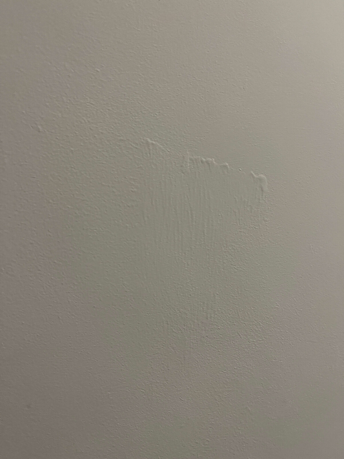

The first two images are down to poor application of the paint. The last one is a failure to fill the gouges left by the plasterers.
The build of paint is not acceptable. I have seen better work done by first time DIYers.
Sorry, I don't know what to say. You were mugged off.
Your decorator has taken bad plastering and managed to make it look worse.
And don't get me started on the roller build up...
