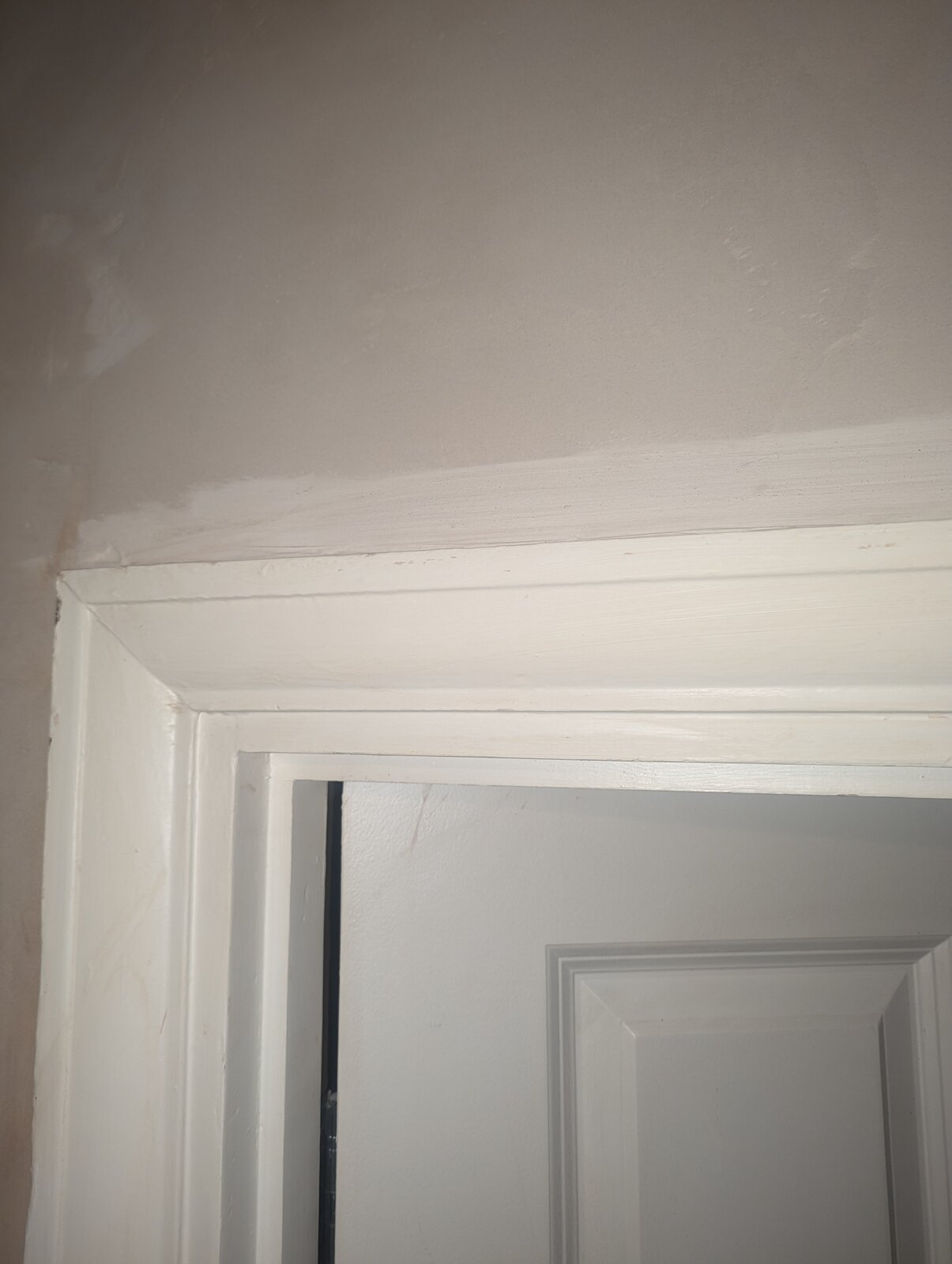

Hi people need advice
So I found a plasterer on check a trade he quoted me £2150 to skim two bedrooms including cellings upstairs hallway and downstairs hallway including celling . I am not sure if this is a good price as he was the first quote had good reviews so I accepted .
He has done the job and I am very unhappy with the work . There is skim splatter all over the walls. All of the edges are rough to touch. Small gaps in between door frames where he skimmed rough to touch .
I don't want him back in my property as this is clearly the best he can do
Question is when I sand down his poor work in the corners with 120 grit paper. The corners become even but still feel rough to touch. Will this be a issue after mist coat or should I put a light coat of filler on top
Also on some of the walls there are these indents in the skim. Do I sand back or fill with filler
Also what filler do you guys recommend ?
Thank you

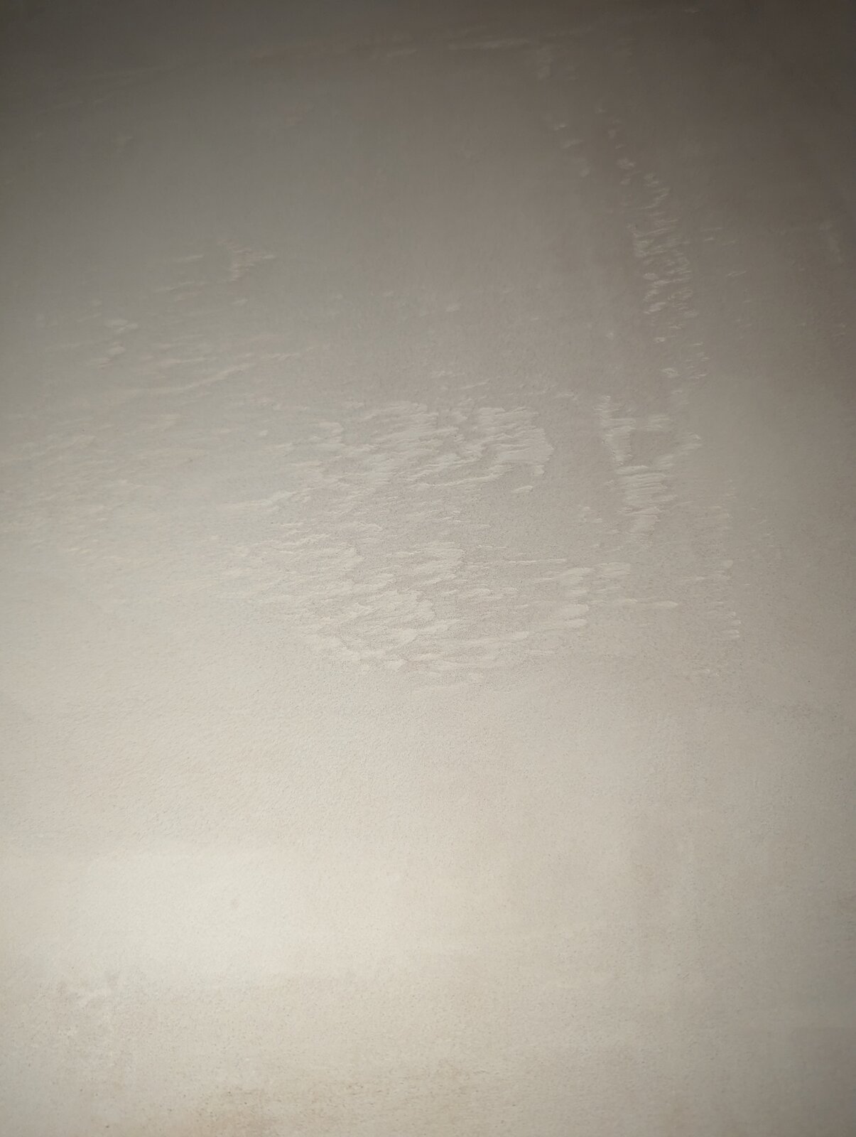

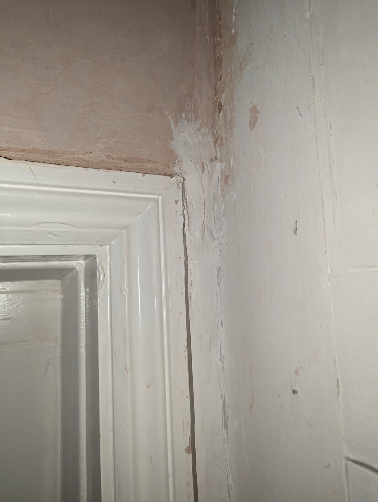

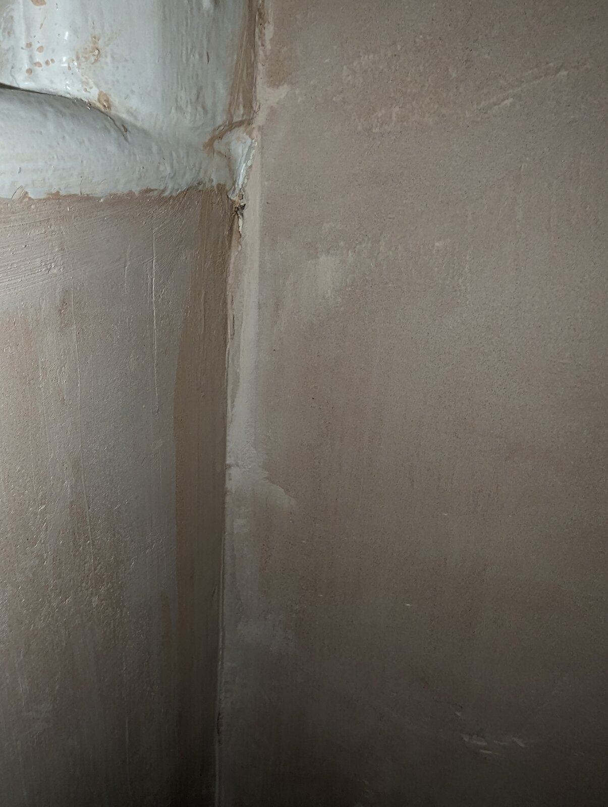

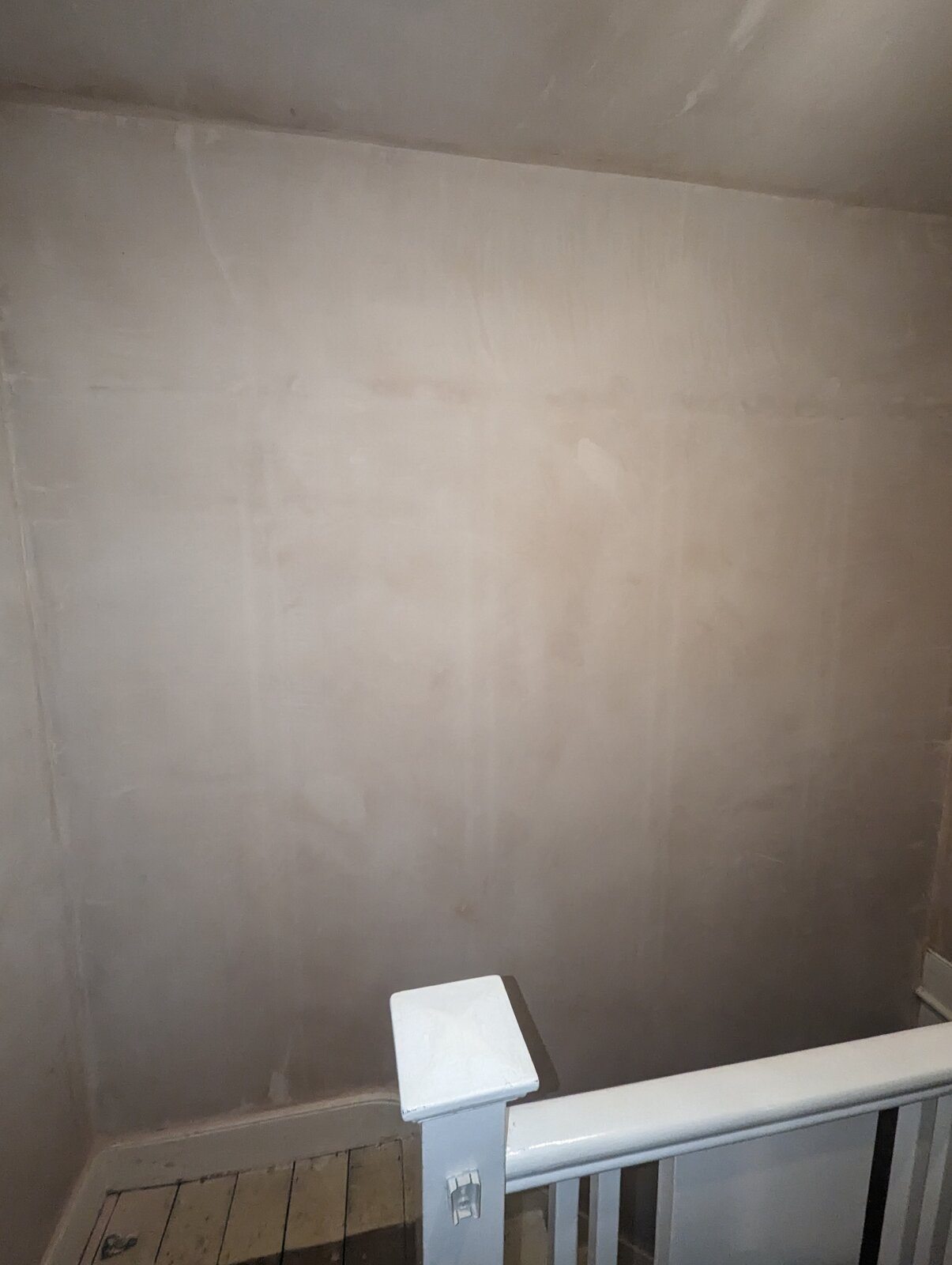

So I have attached images . I am absolutely gutted. Was the price he gave me fair ????

Those pics are poor quality themselves. The skimming looks poor as well. Have you tried a straight edge on any of it to see how flat he's got it.
And alas with all those online sites there is little or no verification of trades by the site. Next time, ask neighbours or friends if they know a good whatever-you-need.
Judging by the pictures, he's not a plasterer.
Not even a diy plasterer.
I don't plaster because it requires experience and specific skills but I would've surely done a better job.
Good grief.
Take some sanding with a block off wood down that door edge. What's that easyfill?
What plaster was on originally? Lime plaster maybe?
Oh dear, but don't panic, it's surprising what one can do with a tub of Wickes Plaster Skim and Repair. Actually doing some myself at present having removed wall paper and found a few dings and small cracks underneath. I use a blade around three inches wide or a plastic spreader arond six inches wide for larger areas. Keep it soft and "creamy" by adding a little water in the tub if it starts to get a bit dry. It adheres well and with a bit of light sanding will be really smooth. Helps to practice a bit until you get the hang of how to butter it on - mrs says it's like icing a cake, if that helps. Done it lots of times myself over the years so fairly skilled at it now. Having a go is not going to cost you much is it?
