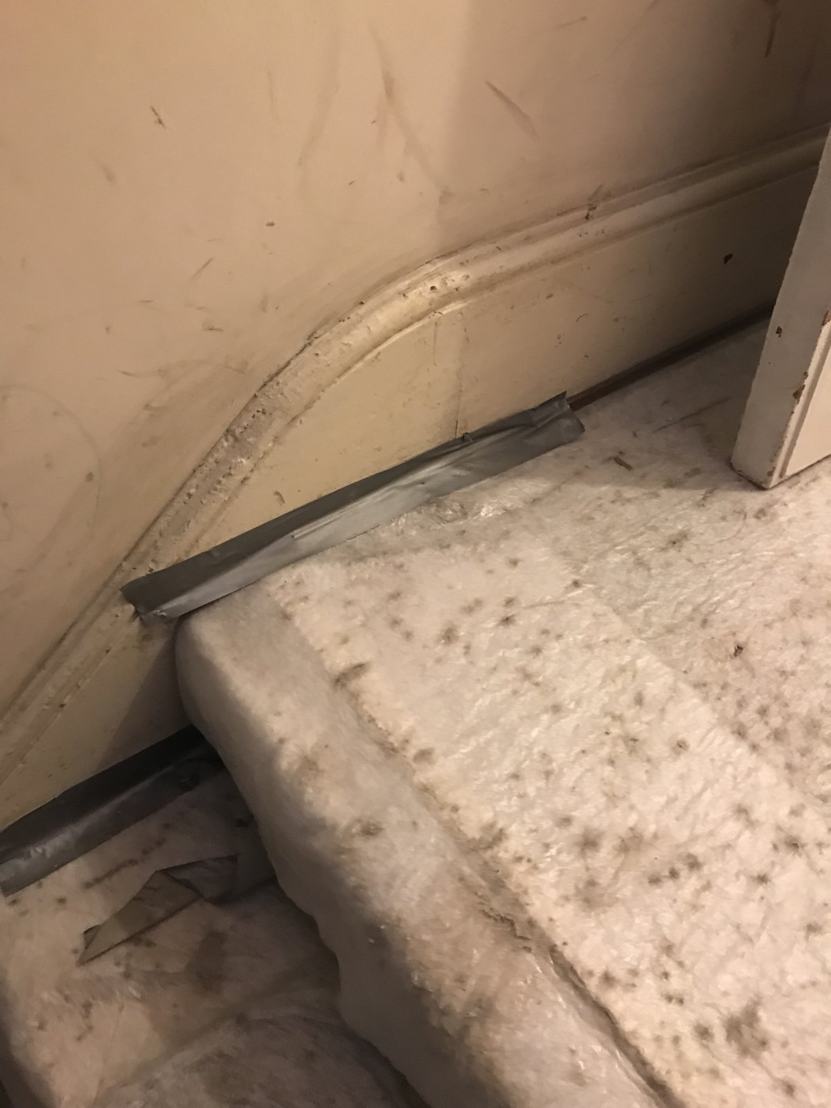

Skirting on the stairs
30 Apr 2013
14
London
hi
Just wondered if anyone might know where or how to get a skirting which is curved for the stairs. I have these in my house and need to get an additional one. See picture
Thanking you in advance
that looks like a straight bit of timber cut into a curve, stringer wise, and a bit of quadrant moulding added for detail.
You may be able to make it by getting a bit of the correct size and steaming it till bendy, then allow to cool in the correct arc.
even soaking might do it.
a wall paper stripper/home steam cleaner and a bit of plastic drain pipe,
