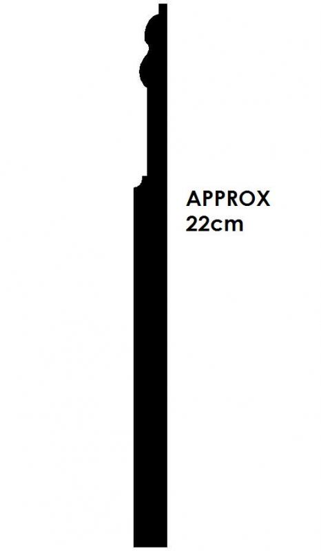

Does anyone have any ideas on what this skirting profile could be? Apologies for the crude paint drawing.
It's similar to Taurus but the 'in' and 'out' are more rounded. skirtingboards.com have a large selection but no matches.
The only additional info I can give is that I know the architraves are formed as part of the door frame - I'm not sure if this is specific to any one manufacturer.
Thanks.
There are many small variation on taurur skirting, if you are trying to match existing you could have it made up identical to your existing.
Don't understand your refernce to door architrave if you are searching for skirting?

Looks a bit like Ogee but different places have different styles.
even the same company but a different branch could well have a different shape profile,as was the case at jewson when i build a house a few years back.had to go to same branch to get more stock to match.
Take a piece of the moulding to a decent timber/joinery workshop and they'll be able to make the profile up.
Done just that a few times but it's only really viable in certain situations, such as restoring an historic building. The problem is that of cost. The machine shop will have to make up the cutters to match your profile and afterwards they are left with what is in effect a useless non standard set of cutters. The cost of the timber is a relativly small part of the cost.
If you can would it not be possible to replace all the skirting, if it is only one room,with as close a match as you can find off the shelf. That way there will be no noticable differences in the room and won't be at all noticable from another room altogether. This approach would most likely be both cheaper and quicker.

This is a rough drawing of the profile. Anyone recognise it?
[/img]
As I said in my former post the cost is theprice of a set of cutters that have to be ground to the correct shape. After cutting your metre and a half the cutters are for all intents and purpose useless, they're non standard and could sit on the shelf forever waiting for someone else to want that particular moulding.
As to making it yourself, that is probably the best option assuming that you are decent at woodwork. I've done it myself before now, it can be a little slow, you'll need a rebate plane, chisels, and plenty of sandpaper and patience but it won't cost you an arm and a leg.

I got a quote yesterday £40 +vat for 3m, thought that seemed pretty expensive really. I think if I needed more then it would work out more cost effective but otherwise it too costly.
I did find one website which had a closer match "st James" profile but still can't find the exact same section anywhere, which is odd as this house has a lot of this skirting! And I'm not convinced that it is the original stuff, because the condition of it it too good.
