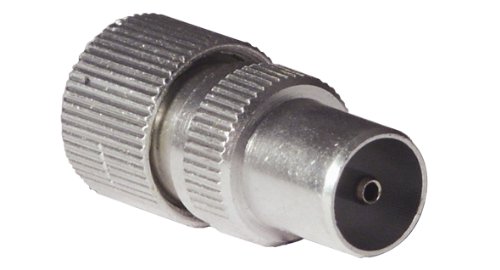

2x RF male plugs

Once you have all the bits, then start at the upstairs TV end. Switch the telly off, and unplug the existing aerial wire. In its place, plug in the Sky eye fly lead end. Put the little square receiver end somewhere it will pick up the remote signals from where you will normally sit. There's a sticky pad on the back. I usually fit them to the bottom edge of the centre of the frame of the TV. Now fit your coax plug to the WF100 wire you bought. Plug that in to the socket side of the Sky eye.
Next, run the cable downstairs. Clip it to skirting etc as needed.
When you reach the Sky box, cut off any excess from the cable you are running, then fit the other aerial plug. Then add the back to back (barrel) adapter. Switch off and unplug your Sky box. This wire with the barrel connector goes to the Sky box socket marked RF2. Put everything straight and plug in the Sky box. It will take about 10 minute to reboot. Good time to grab a glass of something chilled ;)
