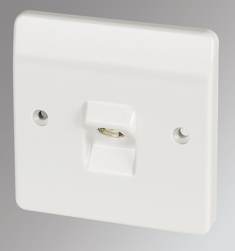

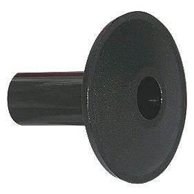

Does anyone know of a miniature flex outlet? It's to fix into a plasterboard wall.
There are these things:
But they don't have a cable clamp, and don't fix very securely to the wall. I'm imagining something a bit like those surface-mount TV aerial sockets:
but a (thin) flex outlet, rather than a socket.
Or something "architrave" size.
Any ideas?
I was wondering if some other country uses something smaller than our normal back box size that I could repurpose.
