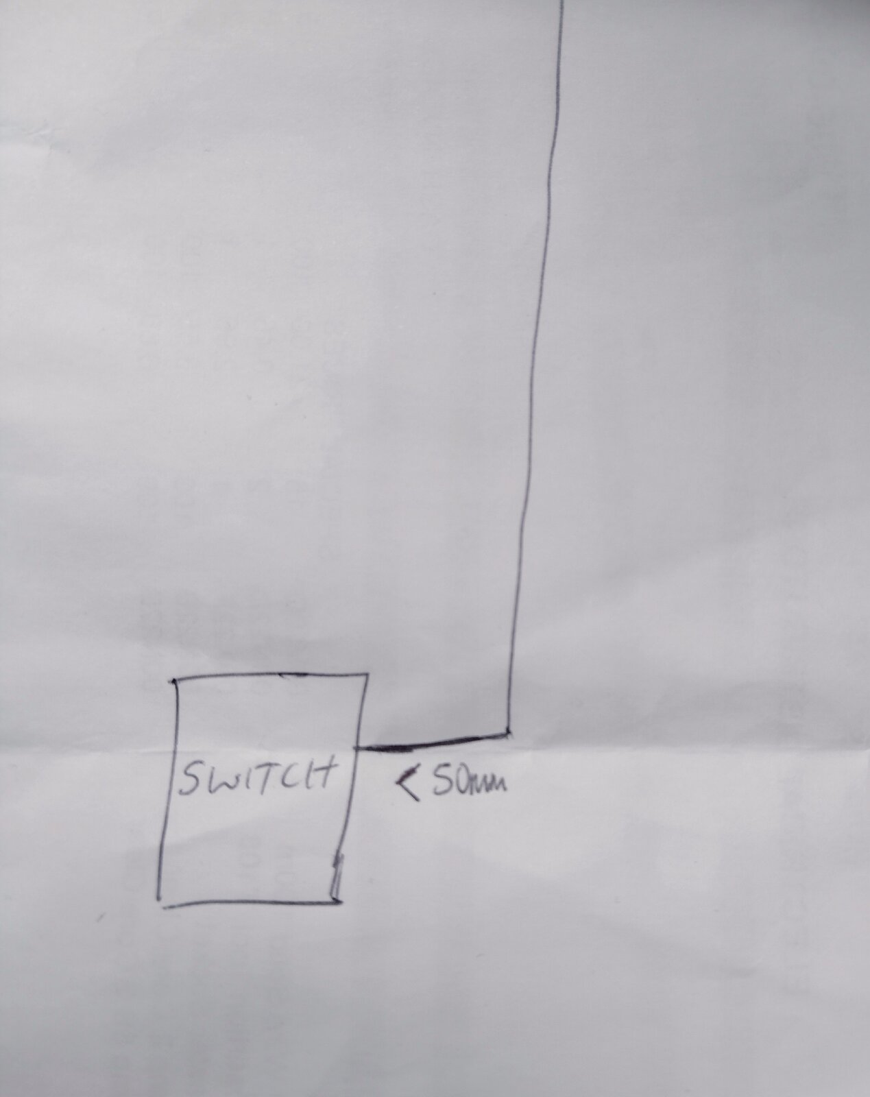

If you are moving the switch, remember that all cables must be in defined cable zones. The existing switch position will be a marker for the existing cables, and they will run horizontally or vertically from that point. If you move the switch then the cable run must move too.

My cable comes to the new switch like the pic.
Wire comes out of the switch horizontally (less than 50mm).
Then the wire travels vertically up towards the ceiling.
Is this okay or does the cable need to run straight up from the switch only?

To extend wires with quickwire the "splitter" box is your best option.
The wires can't come out of the side and go up.
They have to go straight up from the switch or they will be outside the safe zone.
Whichever side you take a cable out, it has to stay in that line, not dog-leg or go at an angle.
