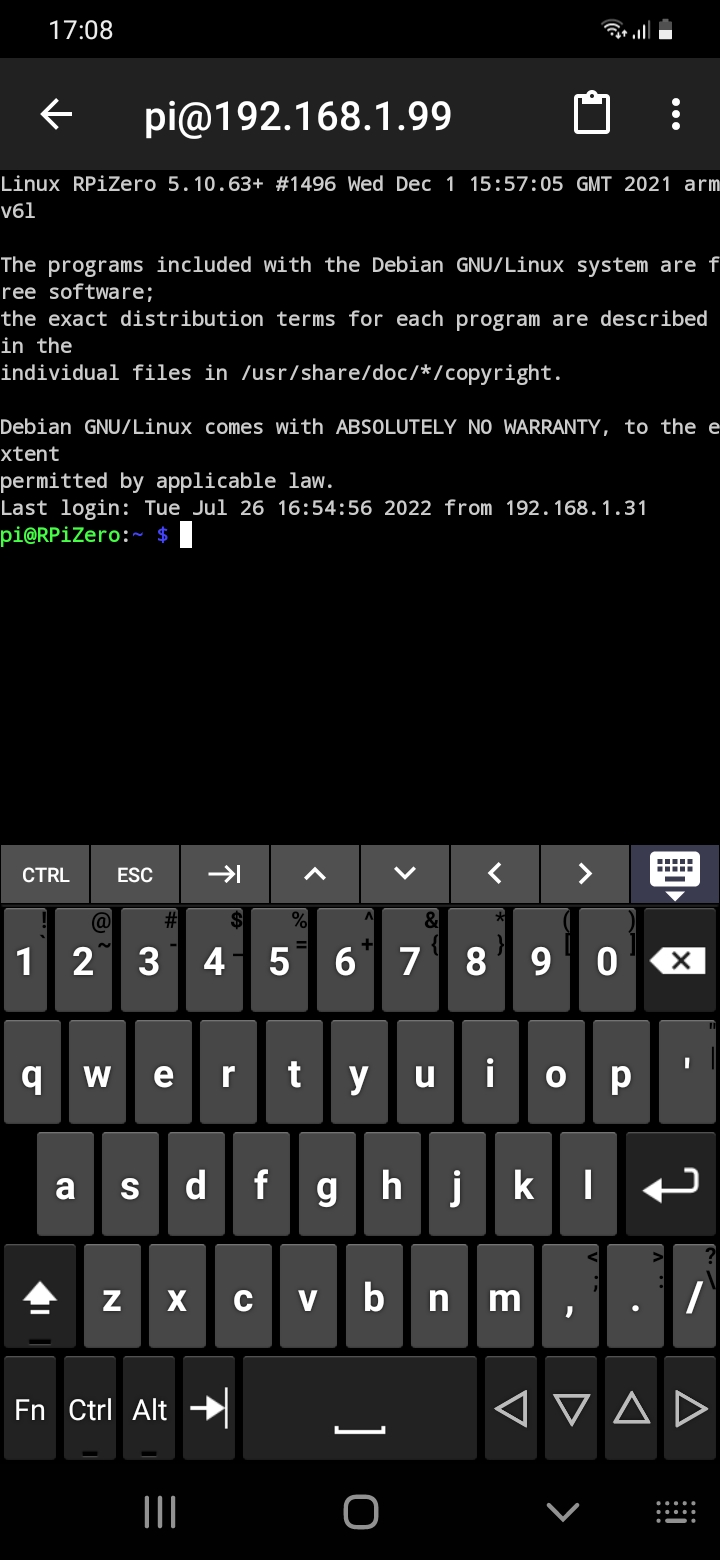

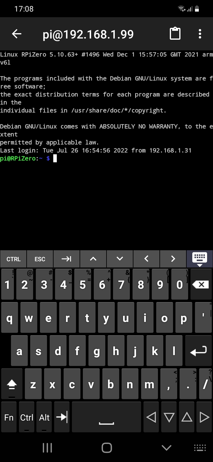

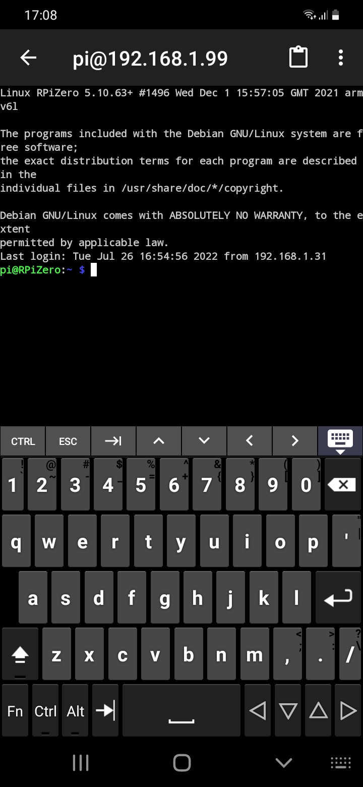

But as I say, an RPi Zero suffers poor performance when VNC'ing and my RPi Model B is extremely clunky when running a GUI, let alone a VNC session - the cursor lag is terrible.
...and for middle of the night tinkering, there is nothing better than opening a terminal on my phone, from bed!
