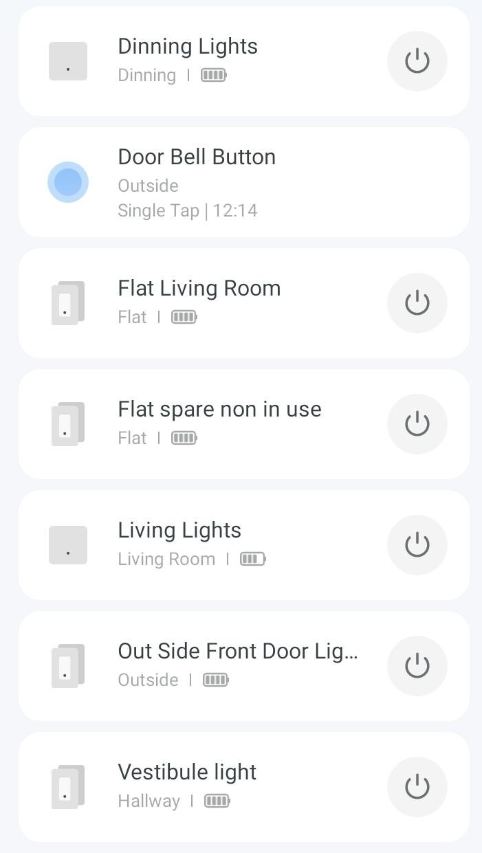

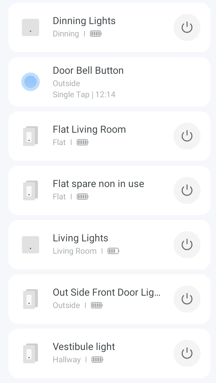

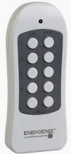

I have found having batteries is what makes them so much better if you have no neutral at the switch. Wife had a replacement hip, so dinning room turned into a bedroom while see recovered this was two years ago, not replaced the batteries yet. To date only the door bell button has had the batteries replaced 1734648089357.png the living room seems to be lowest battery, likely as lights on for longer than the rest, newest around 6 months old, oldest about 2 years, the Energenie MiHome they replaced turned into flasher units, only 2 of the original 5 still in use. The button when used as two way did work well, magnetic base, where the Energenie had a remote control 1734648489112.png there is an option for a master/slave with Energenie
master has LED to show on, slave does not, however the TP-Link button can come with a backing plate
so does same thing but does not need wires, using as a door bell battery lasted around 18 months. We started before Tapo and Kasa combined, so have two hubs, which double as door bells.
