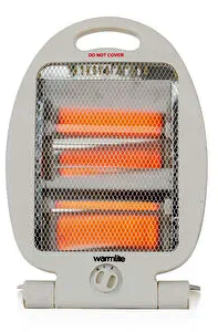

I agree in the main, does not matter what resistive method is used. Energy in = energy out. However this 1673177341399.pngsimple cheap heater is not simple resistive, it also sends out infrared energy, this does not heat the air but passes straight through the air, and heats what it is aimed at, it has also many disadvantages, the heat can pass through most windows even if double glazed, and it is hard to automate control. As a result often they have multi bars, so user can select how many bars, and rarely have a built in thermostat.

I agree in the main, does not matter what resistive method is used. Energy in = energy out. However this <pic> simple cheap heater is not simple resistive, it also sends out infrared energy,
If it's not "simple resistive", what do you think it is - do you think its load includes an inductive or capacitive component?
I think/presume what you're trying to say is that it heats, partially or 'almost completely', by radiation (radiating IR) rather than by convection from a very hot source?
.... this does not heat the air but passes straight through the air, and heats what it is aimed at, it has also many disadvantages, the heat can pass through most windows even if double glazed ...
If you're talking about the IR radiation, that passes very poorly through ordinary glass. That's why greenhouses work - the glass lets UV light in, which heats things and hence causes them to radiate IR, but the glass won't let the IR out. You're into photography - if you've ever tried to take an IR photo through ordinary glass, you will know that it is essentially opaque to IR!

agree in the main, does not matter what resistive method is used. Energy in = energy out. However this 1673177341399.png simple cheap heater is not simple resistive, it also sends out infrared energy, this does not heat the air but passes straight through the air, and heats what it is aimed at, it has also many disadvantages, the heat can pass through most windows even if double glazed, and it is hard to automate control. As a result often they have multi bars, so user can select how many bars, and rarely have a built in thermostat.
I agree, apart from, as pointed out by John above. In fact our first ever electric heater, back in the 50's, was of that IR type as were almost all back then, so nothing new. From what I remember it had two bars, wire wound on some sort of ceramic former, which a massive switch on the rear and portable. It had very exposed live hot parts, just a narrow guard directly in front of the element, and large reflector behind it.
Most, many, all fireplace mounted units are/were of the IR variety, because neither fan nor oil filled would quite fit the bill in a fireplace. I cannot really comment further, not having seen such a heater in the home, for many decades - though I keep a portable version similar to Eric's photo and a couple of fan heaters around for emergencies.
Yep, I also remember them well (might even still have an example in cellar or attic). As you say, almost entirely IR heating, so I also remember us huddled round (very close) in front of it, with scolding hot faces and very cold backs :)
The elements did, of course, get 'red hot', and therefore could have done some convection heating, but they seemed to almost be designed to minimises the amount of convection that could occur!
We also had, in the 60s, a 'drip feed' paraffin heater, which was conceptually similar, with a wire mesh getting red hot and radiating heat - again, huddles of nearby people with hot fronts and cold backs! The more 'traditional' ('tall') types of paraffin heaters (which we also had) worked almost entirely by convection, since the hot parts (flame) were hardly visible (probably only through a very small inspection window)
