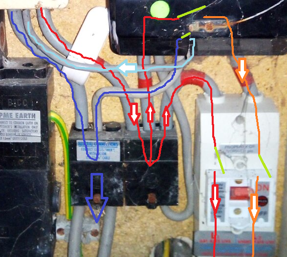

you have a switched supply and a permanent supply, see the switch at lower right, left side is permanent and right side of switch is switched via the black box above, with both cu neutrals joined together in the left henley block
Does this help at all with explaining how E7 works. This is a fairly standard installation but there are variations
Blue is neutral
Red is the live wire which is powered 24 hour a day and is expensive during the day, cheap at night. It ends up in your large CU
Orange is the cheap rate live wire controlled power and ends up in your small CU ie is only energised by a contact in the teleswitch
Pale blue is the signal from a contact in the teleswitch to change to the cheap rate part of the meter
The teleswitch includes a radio receiver for a time signal to do the changeover.

.... One interesting thing that I can't get my head round, though. The storage heaters will only warm up at night (if we use them). So if the whole house switches to E7 at night, what prevents the storage heaters from drawing power during the day as well? Their consumer unit must be on some feed that only goes live at night?
It would seem that your 'Radio Teleswith' not only switches the meter between day and night registers at the appropriate times but also contains a 'switch' (relay/contactor) which switches the storage heaters on only during the cheap/night periods. I presume that the isolator (white thing below the teleswitch) contrails (i.e. allows you to switch off) the storage heaters?

That white thing is a 2 pole isolator which isolates both the 24 hour power and the cheap rate line but not the neutral. Personally I'd have put it between the meter and henley
Yes, you're right, and it does seem an odd way to have done it - as you say, upstream of the Henley (and DP) would seem more logical. I suspect that the way it's ended up may be a consequence of the order in which things were done (over the years) and what was 'most convenient' at the time!
Kind Regards, John
That's how ours works. There are two separate consumer units - the normal one and a smaller one that only becomes live during the night. That used to run the storage heaters, but now is useful for running washing machine, dishwasher, dehumidifier, or anything else that can with advantage be run at night on cheaper electricity.
Switching on automatically avoids the need for separate timers, and the master timer in the E7 supply to the consumer unit runs on clockwork which is wound electricly, so has about a week's worth of normal operation so it can weather all normal power cuts. Ordinary plug in timers have to be reset after every power cut, which are frequent in west Wales.
Everything plugged into a socket on the ordinary consumer unit is cheaper at night, only the separate E7 consumer unit switches off during the day.
There are two meters inside the same box - I read them by flicking a button which displays each in turn. There are several other displays too, heaven knows what they mean.
The network of cabling for the previous storage heaters terminates in a separate socket outlet in each room - marked with dymo tape to avoid confusion.
Blue is neutral
Thanks, that's brilliant! Presumably the incoming supply is the heavy black wire at the bottom, left, and then it goes through that big black box with "PME Earth" written on it - which I guess is some kind of master fuse? Then it goes into the small, oblong black box above that (not sure what that is?) and then the oblong white one, before going through the meter, after which, your marked-up drawing takes over?
Kind Regards, John
Thanks. I've never actually tried turning that switch off, but yes, I think it probably would!
As Sunray pointed out (I had not looked closely enough) that switch/isolator actually turns off everything in your electrical installation, not just the storage heaters.
