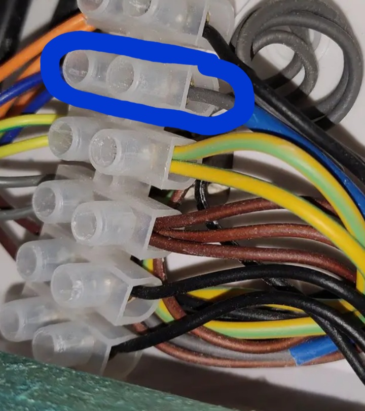

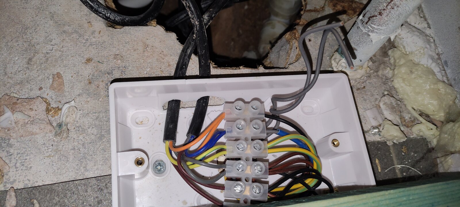

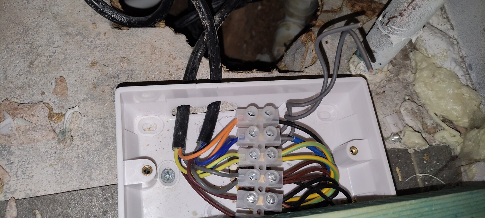

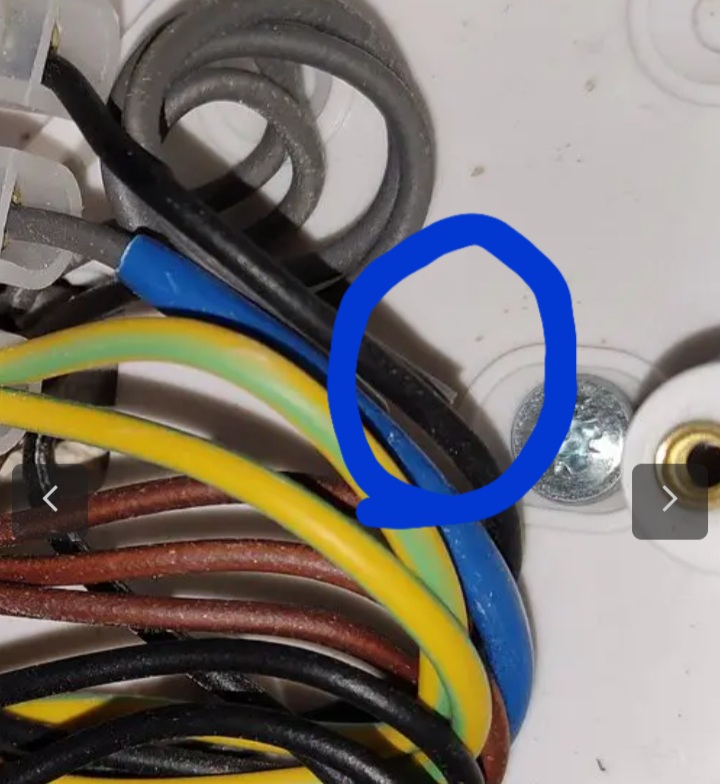

Smart thermostats receive no power after switching from battery-operated thermostats
So where are you saying it should be connected?
Assuming you will wire your Meross as in your earlier image,
I would suspect that the grey core is not connected as a neutral,
the coiled grey (disconnected) wire that needs to be connected to neutral
I think you need to connect the loose grey wires to a neutral! ;)
Try here...
And remember that these wires should be appropriately oversleeved.
Hello I'm back. Apologies for the delay. Needed to get some things sorted. So, I'm not sure if this is a problem but there's actually 2 coiled up grey cables. I'm assuming this is for the upstairs and downstairs stats but now I'm wondering if they can both go in that port with the oversleeved one?
