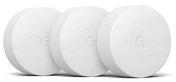

Nest in USA have these upload_2022-1-7_23-17-37.png temperature sensors to ensure heating runs if any room is under temperature, I think, as the way they work seems a little uncertain, but here in UK where most of the heating uses water, not hot air, we tend to have combined the temperature sensor and TRV head together.

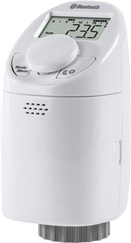

But also a couple of wall thermostats in parallel can ensure boiler runs when required and cheap (I paid £15 each eQ-3) programmable TRV heads EQ-3 Bluetooth Smart Radiator Thermostat.jpg can work very well, although will only connect to one phone and only when local as uses bluetooth not wifi. The blue tooth does mean where more than one radiator in a room they can be linked. But other than that likely the manual local controls are good enough, there is also the Terrier i30.
