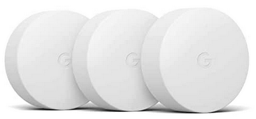

Nest in USA have these View attachment 256663 temperature sensors to ensure heating runs if any room is under temperature, I think, as the way they work seems a little uncertain, but here in UK where most of the heating uses water, not hot air, we tend to have combined the temperature sensor and TRV head together.
To my mind Nest and Energenie MiHome got it the wrong way around, with the wall thermostat telling the TRV what to do, most the TRV tells the wall thermostat what to do, and how also varies. Hive for example has a ceiling of 22°C under that the TRV can send a "demand for heat" and turn boiler on even when the wall thermostat is satisfied. Others use different methods, having a display showing 6 rooms seems good View attachment 256667 not a clue how well it works.

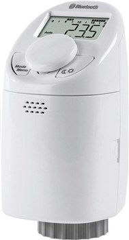

But also a couple of wall thermostats in parallel can ensure boiler runs when required and cheap (I paid £15 each eQ-3) programmable TRV heads View attachment 256668 can work very well, although will only connect to one phone and only when local as uses bluetooth not wifi. The blue tooth does mean where more than one radiator in a room they can be linked. But other than that likely the manual local controls are good enough, there is also the Terrier i30.
The idea of geofencing seems good, however I found speed is a problem, I can set the eQ-3 TRV heads to come on in sequence heating most important rooms first, and also with the Energenie cheat setting heat to 22°C for an hour then back down to 20°C, but the geofencing I have has no user controls to set at what point it turns heating up. Not a clue if when within 25 miles, 1 mile, or 500 yards, until google took over Nest it did work, but now has failed.
