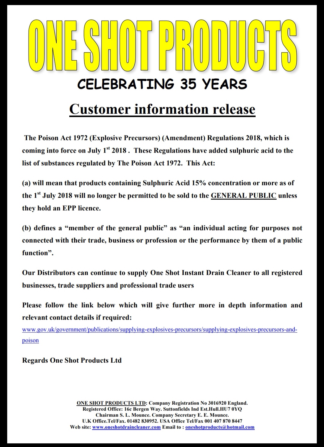

local plumbing shop offered me a bottle of 98% sulphuric acid as an excellent drain cleaning agent
Anybody suggesting using this type of product on above surface/internal/plastic pipework needs to be slapped repeatedly until they understand the stupidity of the suggestion. It still amazes me that acid of this strength can be bought by anybody and used with little understanding of the potential danger.
Absolutely. Should not be generally available.
It can't (or shouldn't be) seen my local shop refuse sale of 1shot to several disgruntled customers... There are 'other' outlets in the locale who are not so scrupulous!
