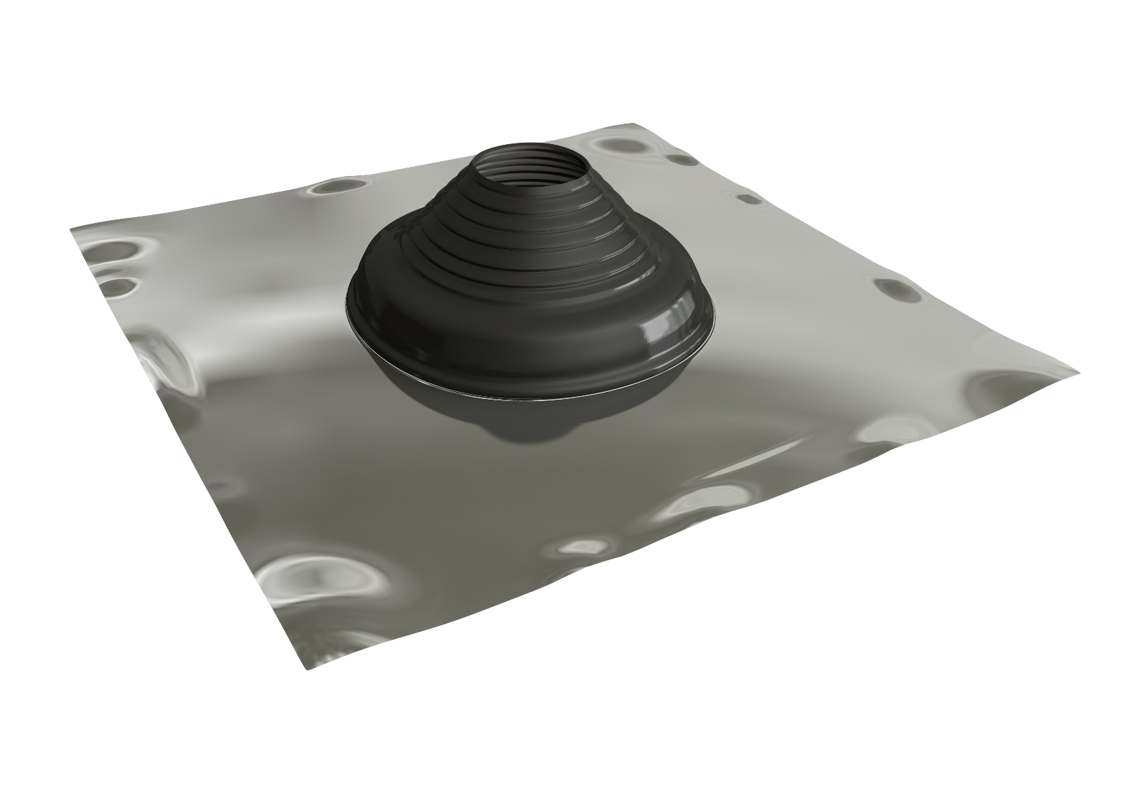

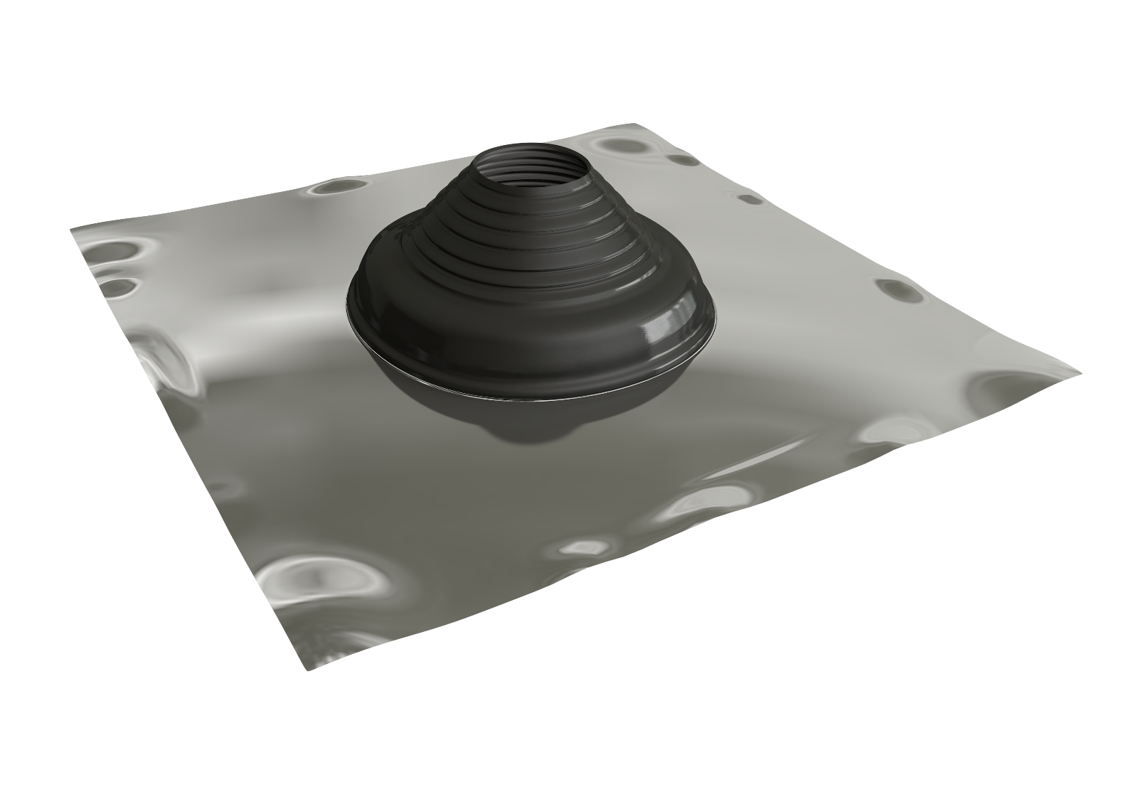

OK. Even though I've got the downpipe coming through the roof 40mm from the wall about halfway down the slope? At that point the lead will need cutting round the pipe and presumably open up a potential problem downstream.
I've got one of these weathering slate things (see picture) for the pipe which in my head was offloading onto the next soaker down. I suppose I could install a grp secret gutter, but just from the point the pipe starts to the eaves.
I go to a lot of leaks where for whatever reason people think its best to flash pipes into their flashing.
I don’t have the room to move the pipe unfortunately. This is a tight cubbyhole space down the side of the house bordering next door.
