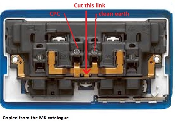

Hi, I would like to double check if the connection that I have done is ok. Please have a look at the images below. My concern is the diagram have to earth cable going out, which I don’t understand. Would appreciate if someone could advise.
You don’t need that green wire from the socket to the plastic back box. Plastic does not conduct electricity.
What is? Earthing plastic? Even if it was metal the flylead is not required if one of the lugs is fixed.
There are differences of opinion on this matter, personally for me if it's all metal I will add the additional wire betwix socket and box. It usually costs nothing apart from a few seconds of time.
I've always known a clean earth to be independant of the usual protective earth. Suitable sockets will have 2 earth connexions, one on the frontplate/screw holes and the other on the earth pins of the socket.
Same here. The clean earth and CPC were NOT connected together when the equipment required a clean earth.
MK produced a socket which could be used without a clean earth or by cutting a link it could provide clean earth to the socket's Earths
