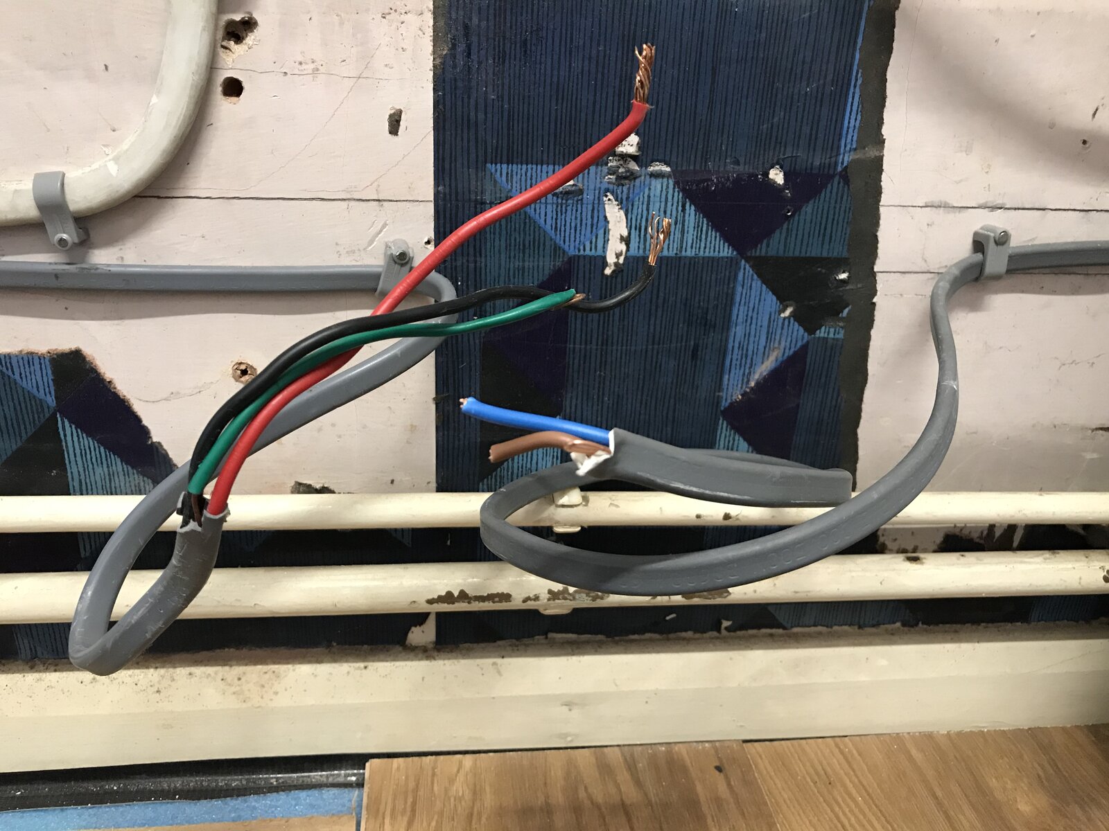

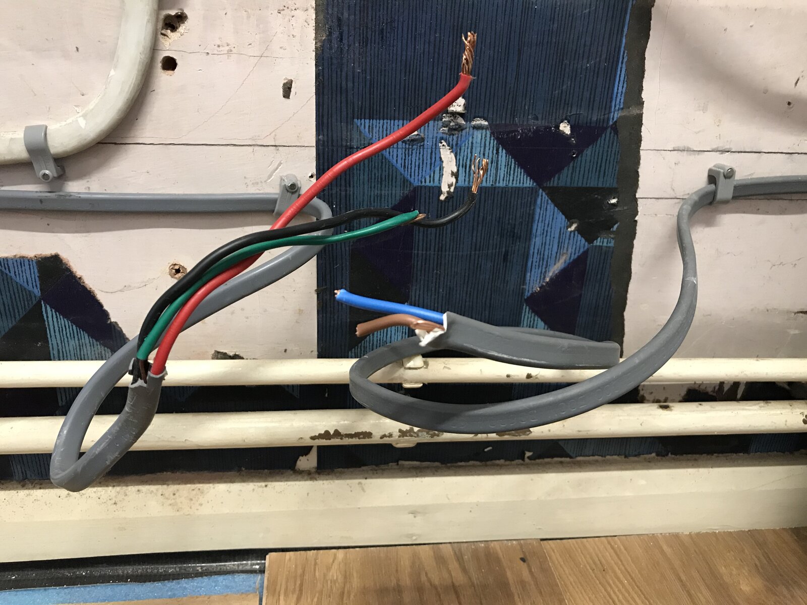

What would be the method to join this cable below that goes to the socket in this post?
What would be the method to join this cable below that goes to the socket in this post?View attachment 252976
To join the cables, typically you would use a 30 or 32 amp junction box.
You can use one with screw down connections, or if it is considered that the joint would be 'inaccessible', you would use a maintenance free type junction box.

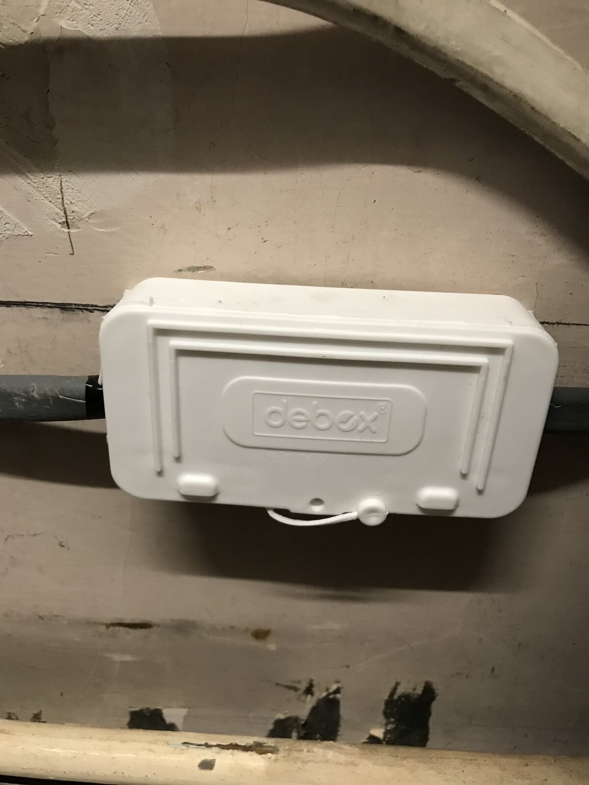

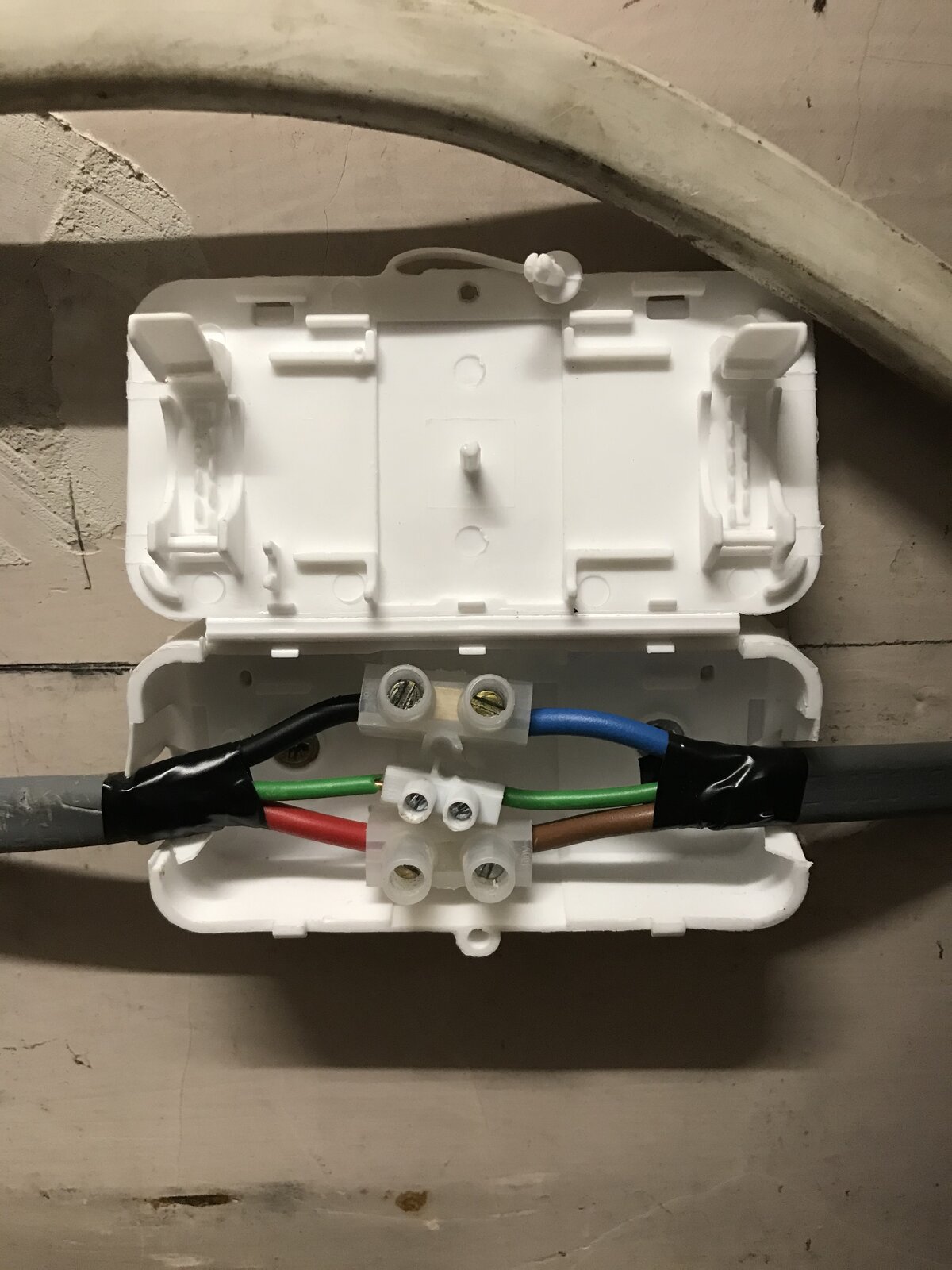

I bought one of the junction box, unfortunately it doesn't fit the cable.
So, I modified and done this- image below. Is it ok?
