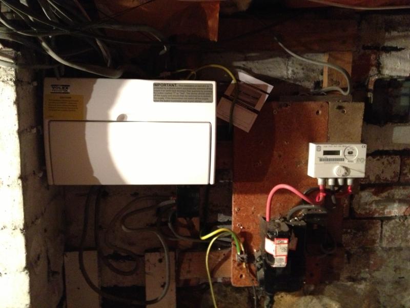

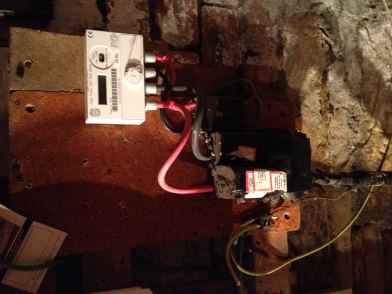

In view of what we've seen, that might be a little worrying - any chance of a picture of the new consumer unit and its surroundings?
Kind Regards, John

Will go and take a picture now...

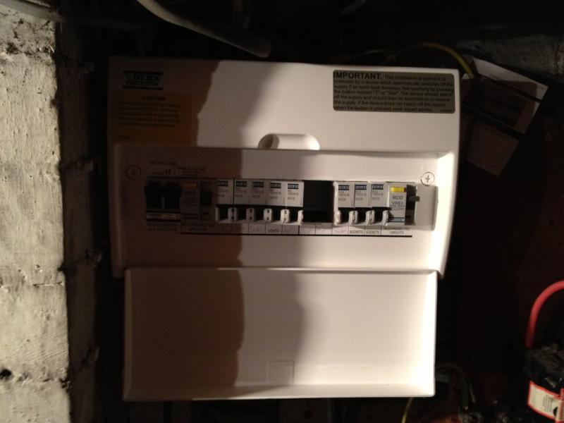

Picture with CU visor down showing MCBs, are the spares blanked or exposed?
Has the unit one RCD or two, difficult to tell as the pictures are shaded.
