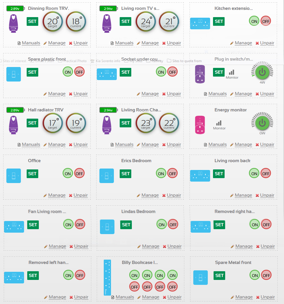

I watched about half of video, I know designed for office, but we have similar in the home. Mihome-used-crop.jpg I can control some sockets remotely and heating, so the cabinet display can auto switch off at bed time, and I can monitor some sockets use.

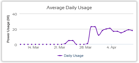

This upload_2022-4-10_10-58-11.png for example is power used by a heater that keeps my formentor at correct temperature, I use it so see if switching on/off, if it is then warm enough, if not need more insulation around it. I also use the sockets to show when battery charger has finished, and test fridge/freezer every so often.
