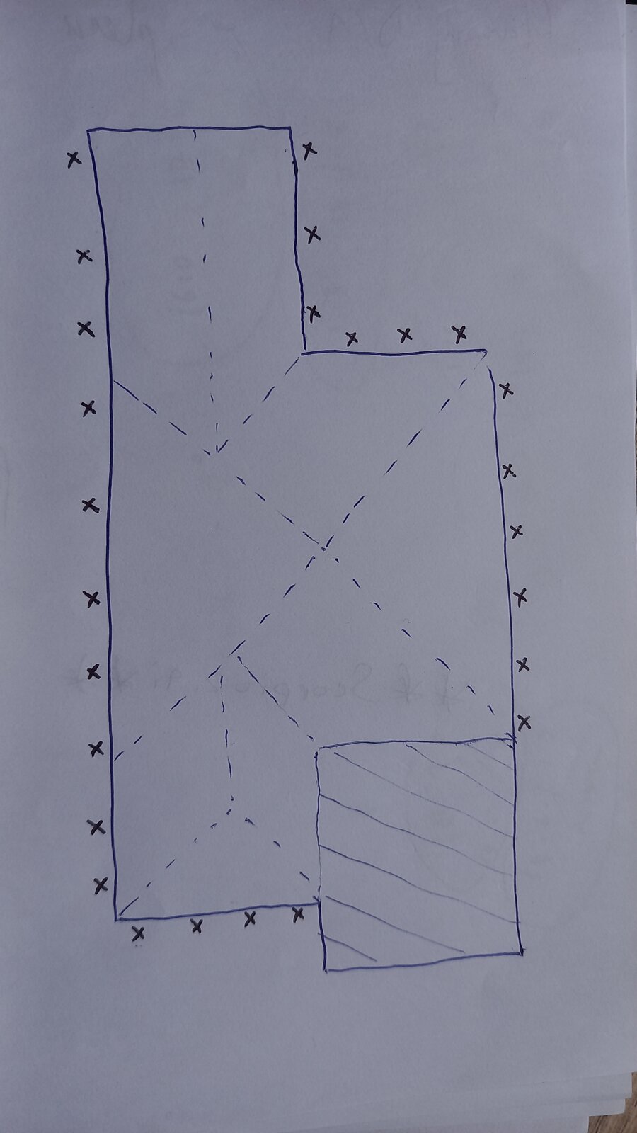

Just for some extra info - there is a flat roofed extension at part of the house where there are no soffits available for me to put vents in. I'm mindful that the ideal is to have vents on both sides of the roof to allow cross flow of air. Nevertheless, do you reckon this would be ok? Crosses are where I intend to put soffit vents.
