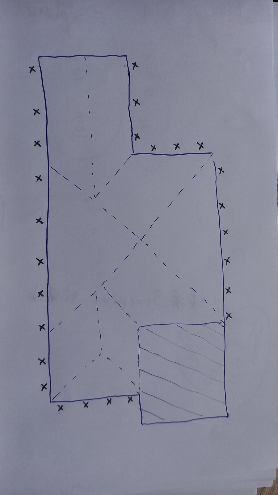

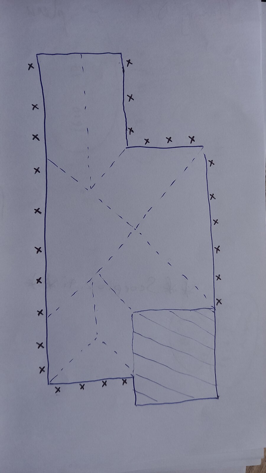

If I do find damp in the attic, then do I need ridge or tile vents? Are soffit vents sufficient on their own? As per the attached, the main roof is hipped with two lower pitch roofed outriggers. Then there is the flat roofed extension.
The problem with ventilating the flat roof is that I assume vents would be needed in the fascia along the side. However, I don't think there is much of a pathway for this air to reach the main roof space. Inside the main roof, chipboard stuff slopes down where the rubber membrane has been attached on the outside and the roofer filled between the joists with regular loft insulation. As I understand it, a 50mm head space would be needed above the insulation but I think he packed it quite tight. Am I screwed? The room below the flat roof is dry, and I have the vents above the sliding patio door permanently open.

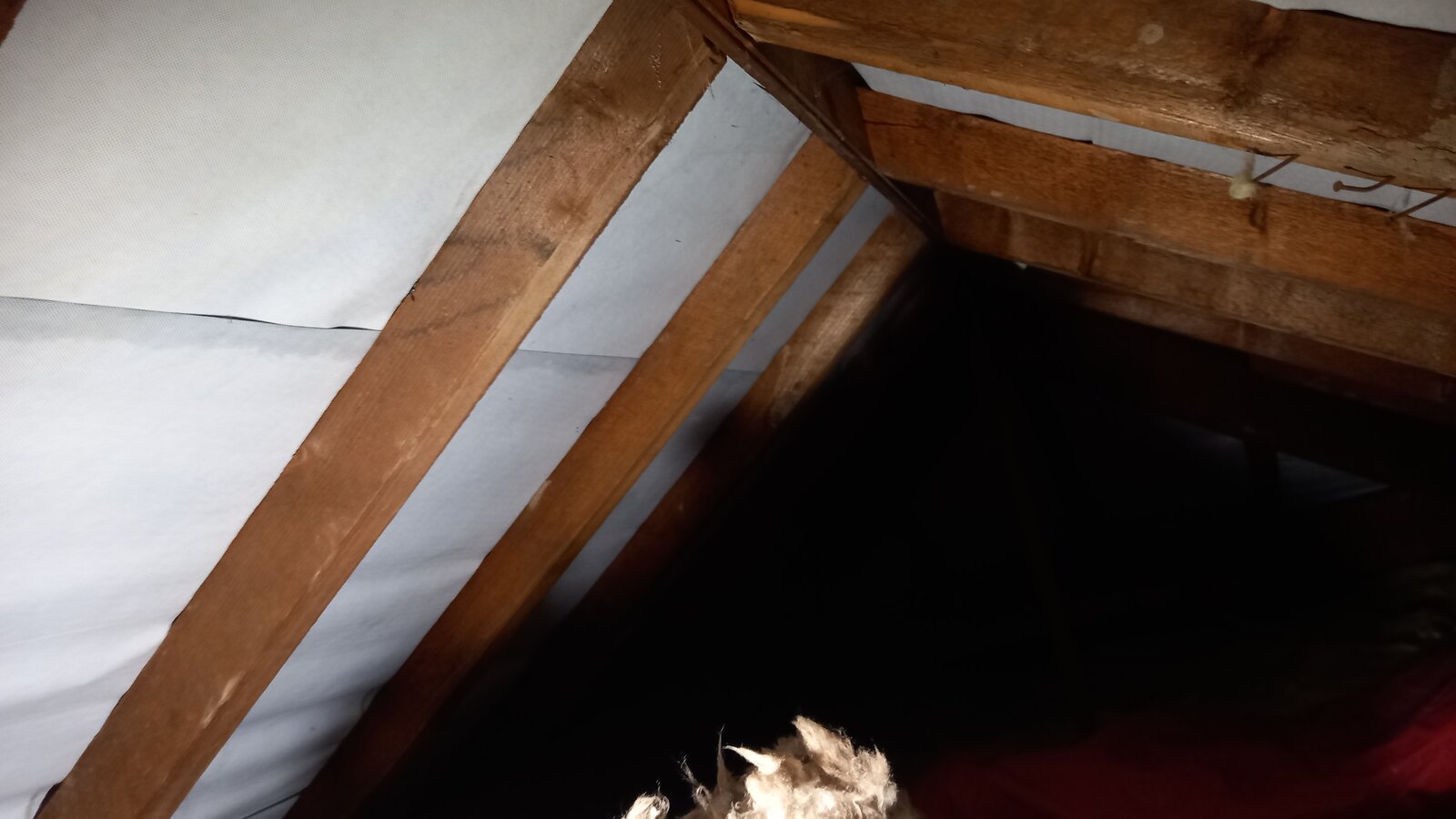

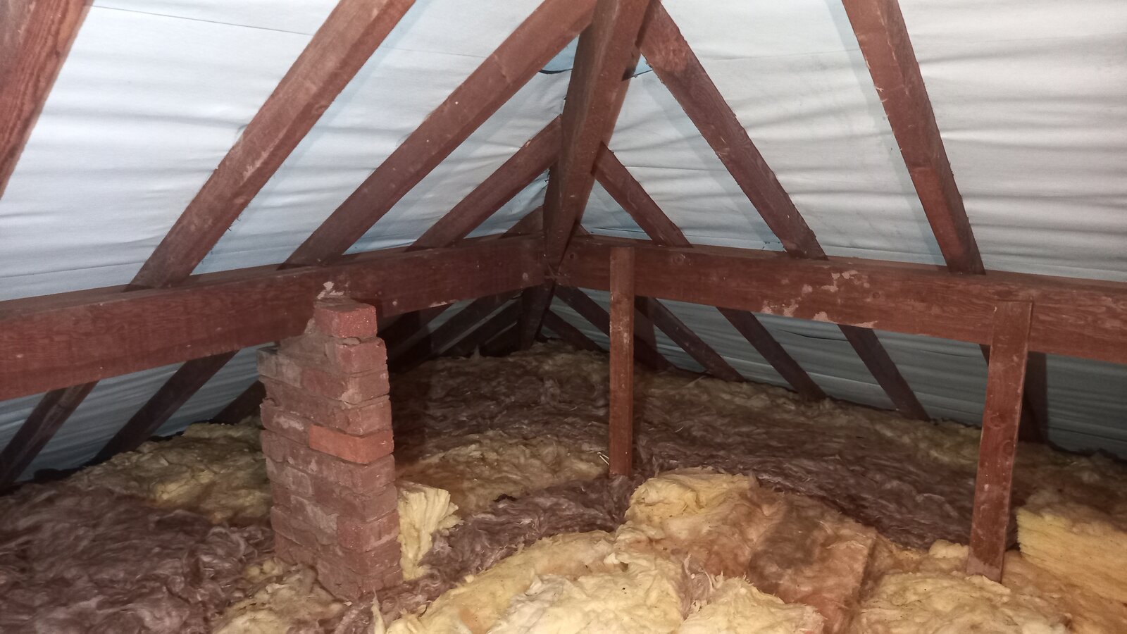

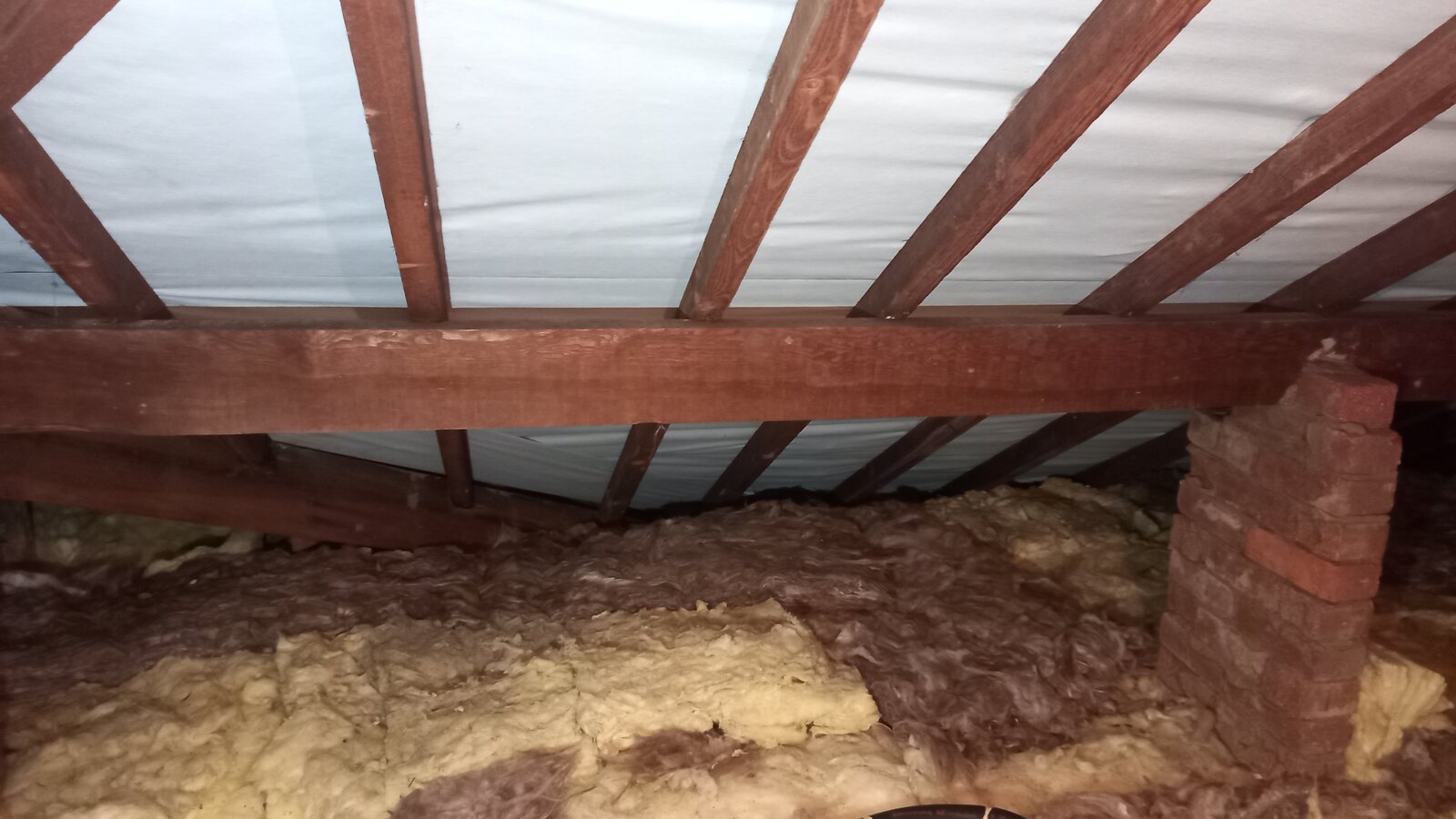

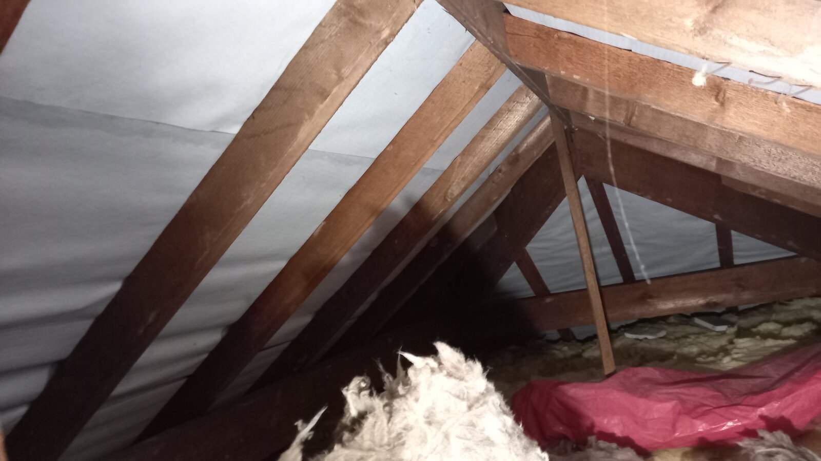

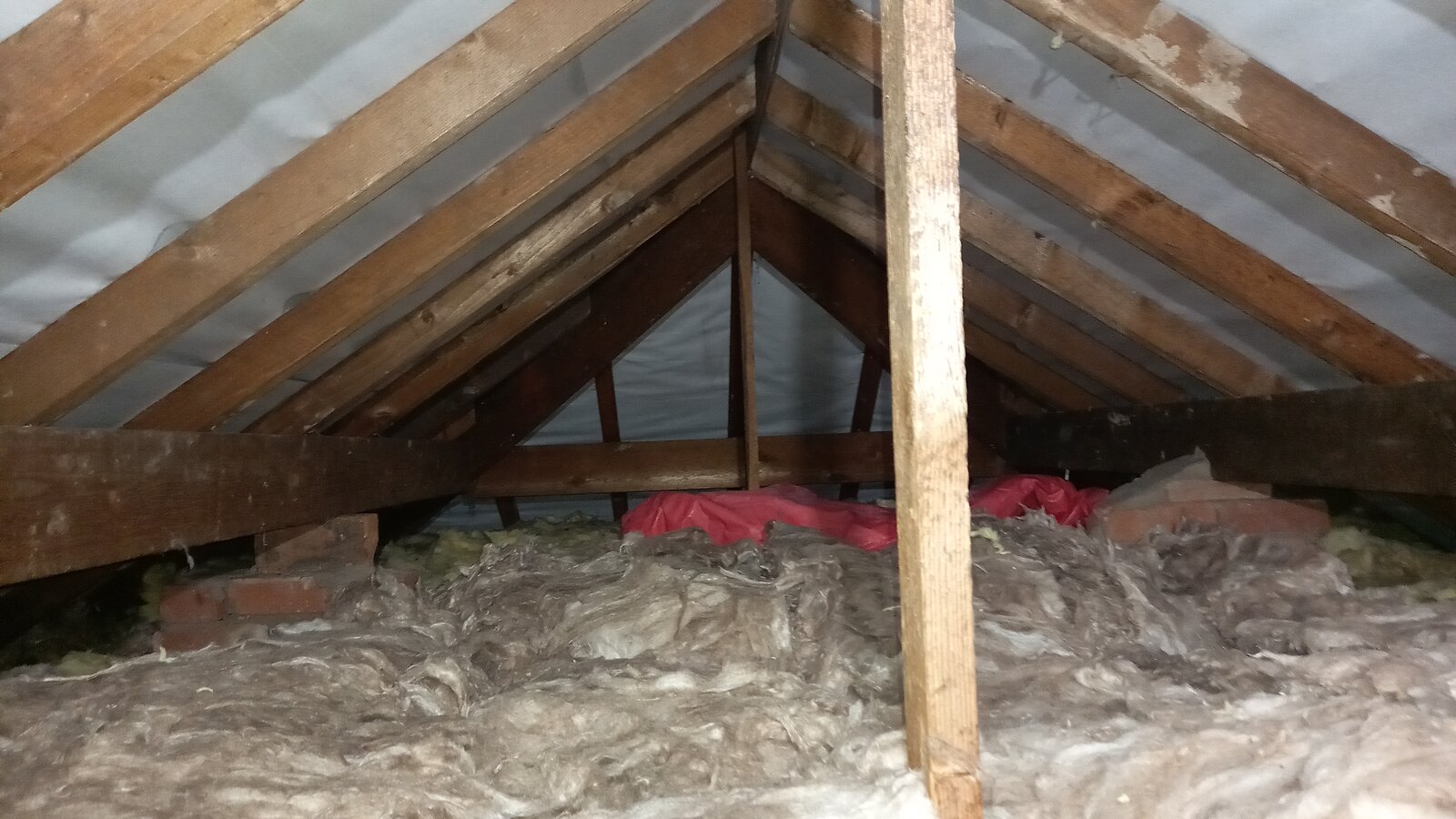

Ok, so I went back up into the wretched attic earlier, contorted myself into all sorts of cramped situations, and had a really good look around with a very bright torch, and had a good feel of the materials up there. I also took my hygrometer up there.
I attach photos.

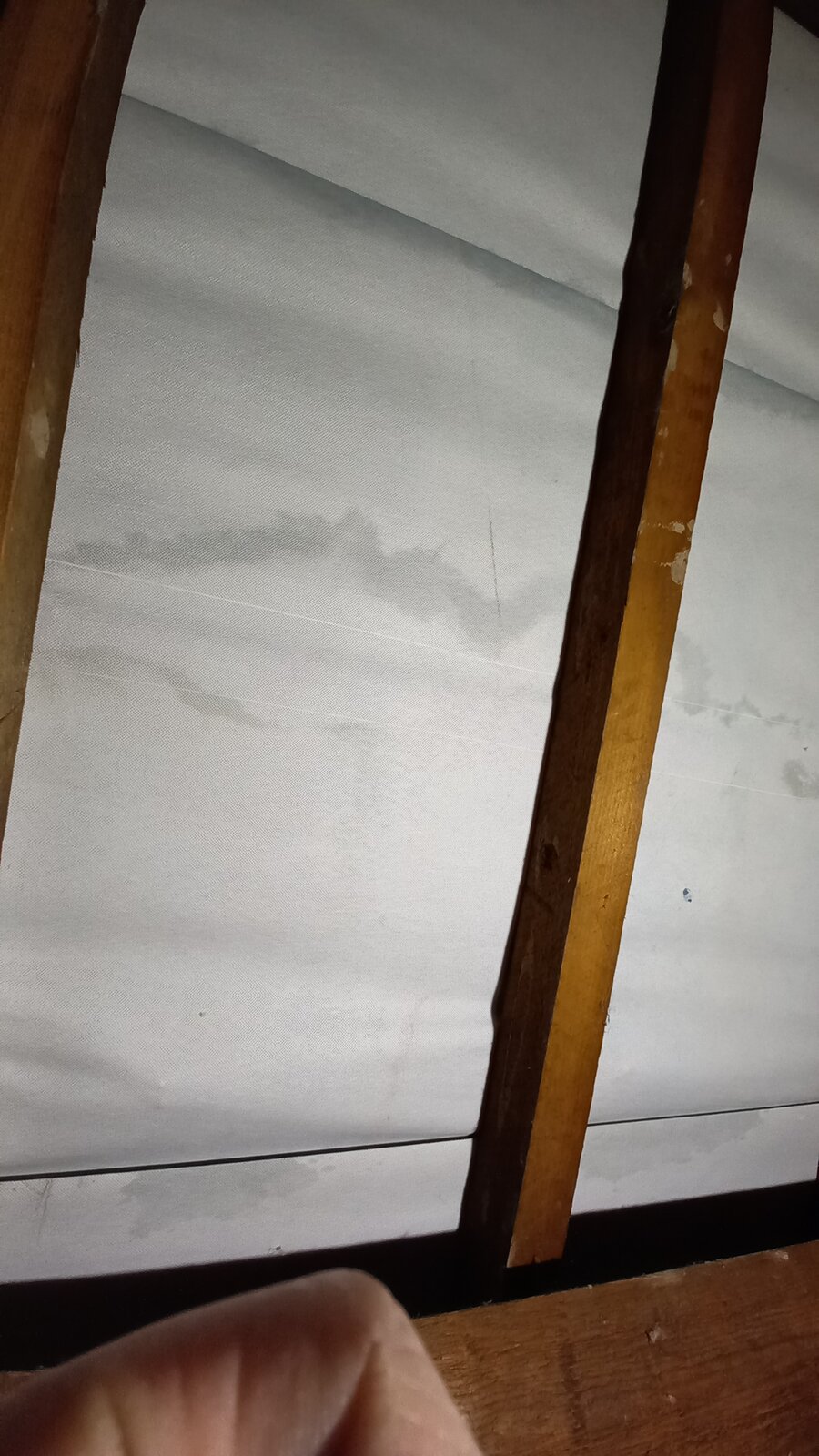

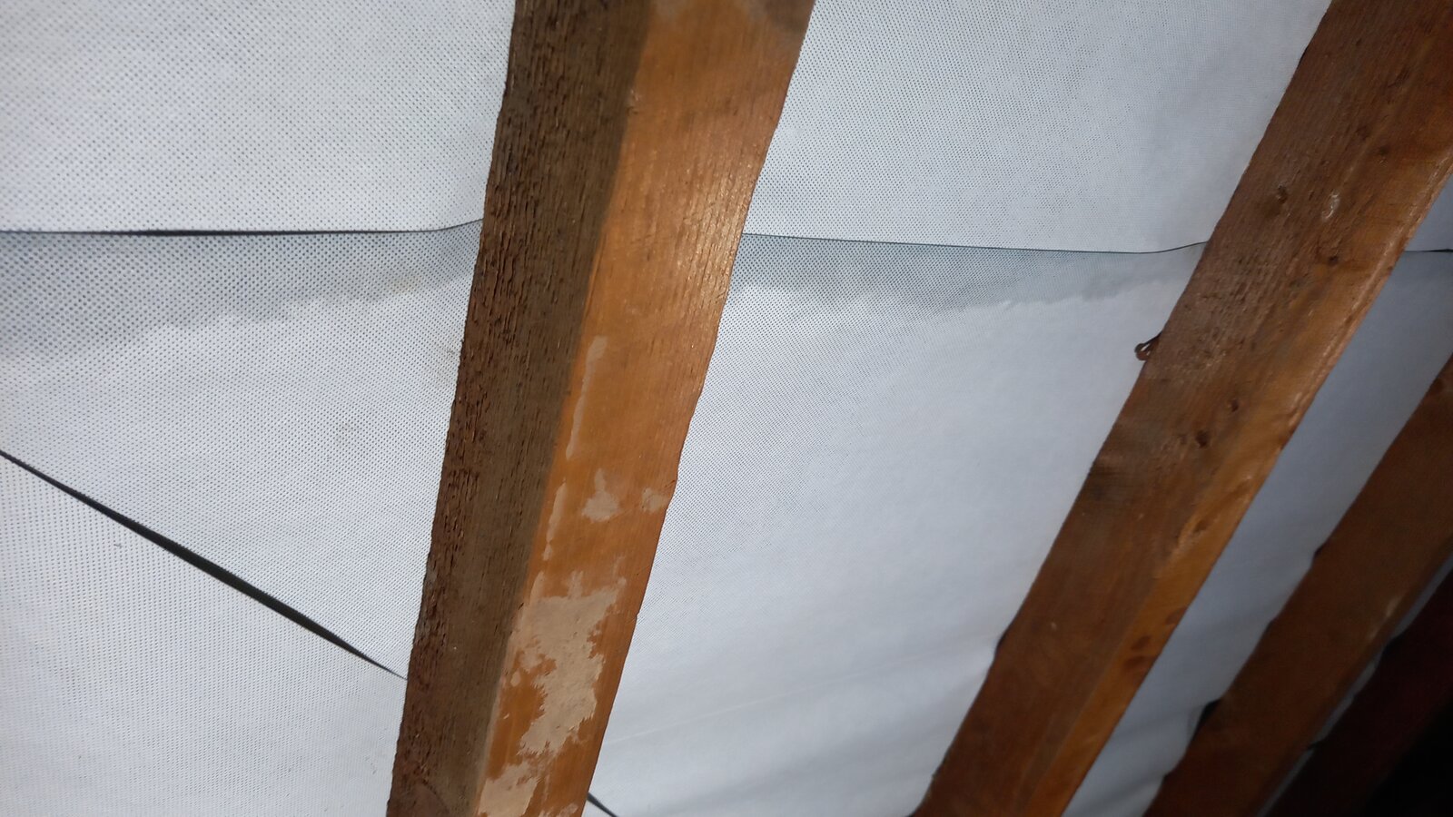

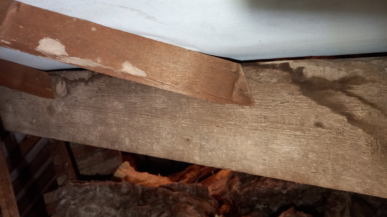

The white breathable membrane appears clean and dry for the most part. Except for one side of the outrigger, which is located alongside the flat roofed extension. There are what look like damp patches along the membrane on that specific side, noting that there are no soffits on that side or air flow because of the extension.
However... those apparent damp patches didn't feel damp to the touch. They also appear on one long sheet of membrane. Could it be a coincidence that there just happened to be grease marks on that sheet? You will see the darker patches run in a line along the top edge of the sheet... is this a level where moisture is condensing, or just an edge where the roll of membrane was sat in grease before installation? That said, there are random, discrete darker patches further along on the same sheet as well - but are those indicative of condensation? Again, they didn't feel wet.

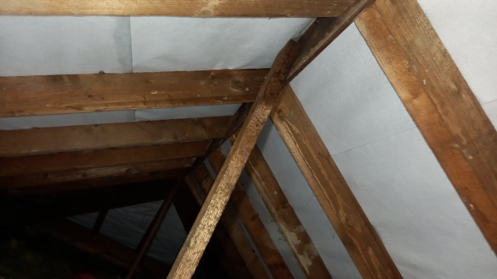

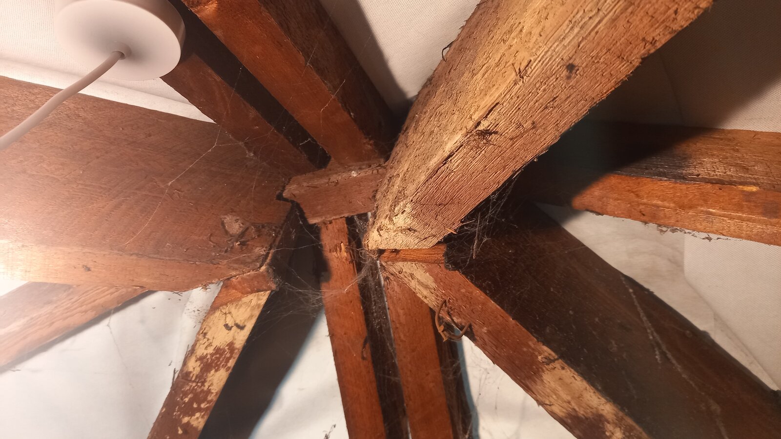

The timbers generally felt mostly dry, although there are stains in places. These, I suspect, are historic. The structure of the roof is 60 odd years old. I attach some photos. They look like they're from previous ingress rather than condensation. To the touch, they don't feel soaked or recently wet, despite all the rain recently. Just very faintly damp.
I could not smell any damp up there and didn't see any mold. Just the usual attic smell.
I wasn't able to too see or feel any damp around the perimeter of the flat roofed extension. I got my hand in there a bit. Difficult to be certain, and sometimes colder things can feel deceptively damp. But there was nothing setting alarm bells off, apart from the patches I've mentioned.
I attach photos for others to hopefully feedback on. Please note that it is a 1961 house and the old roof was very much at the end of its life when I got it all replaced in the spring. So if it doesn't look pretty in there or the timbers have marks on them, possible they're not recent.
The hygrometer read 79% RH and 12.3C by the time I was done up there. I was up there for nearly two hours and was sweating by the end so possibly contributed to humidity. Afterwards I put the hygrometer outside for a bit and the reading, after heavy rain had finished, was 83% and 6.6C.
So basically, the attic temperature is half way between the outside and the accommodation below.
Any feedback welcome.

The other thing I'm thinking is just to bite the bullet and install soffit vents at maybe one per metre. This would hopefully give some air movement and push factor to get humidity moving. Either through the soffit vents themselves or the breathable membrane.
What I'm not sure about is whether soffit vents are basically pointless without higher up vents as well, such as ridge vents? I read that one without the other doesn't do much. But maybe the membrane is a former of higher up vent?
The other issue is that it will be very difficult for me to ventilate the flat roof. Will putting soffit vents opposite this result in air blowing in from outside and then cause moisture problem on the flat roof side where those marks are already? Or will breathable membrane take care of this in addition to the rear soffit vents being along a different stretch? (See attached)

I've fitted 40 soffit vents over the past few days, mostly at 500mm centres, but some a bit further apart.
