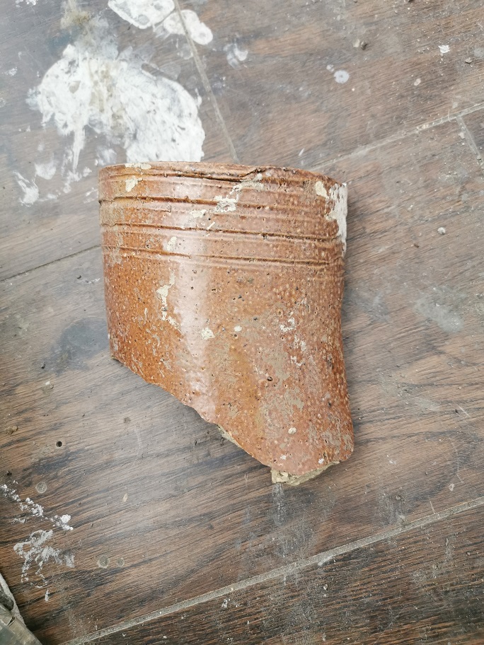

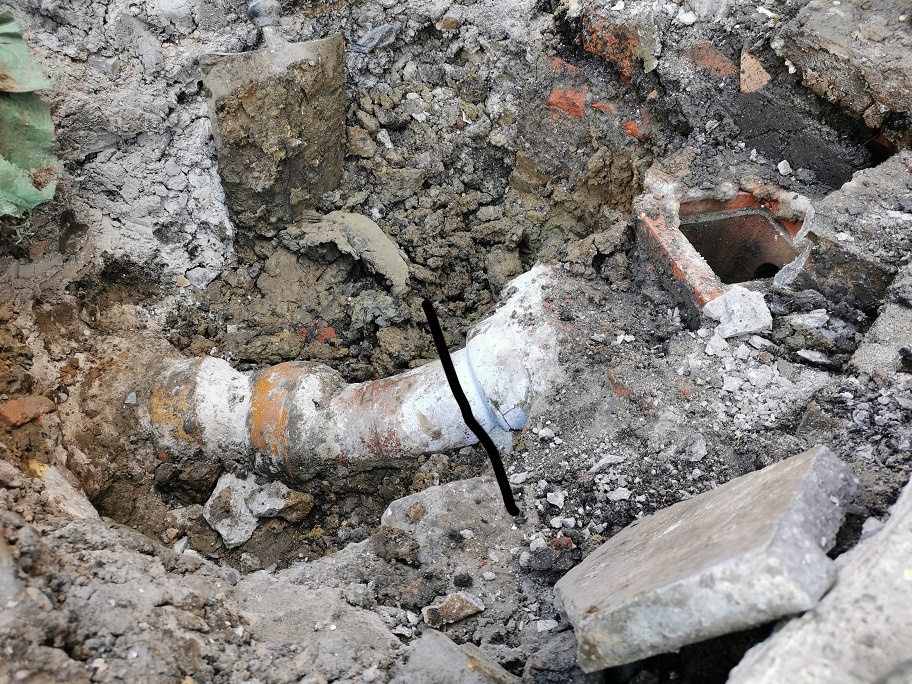

No haven't pulled any broken bits of pipe out in this hole, the other hole there one piece of a half of pipe, no other bits, so just assuming they left in there and it was of broken pipe they didn't lay, some parts are a little sodden, but on the whole, not, do you think this is the trap of the gulley, should i keep digging down? or can i cut the pipe in the picture and lift the whole thing out?? i haven't a clue??. thanks Hugh looks like this bit was never used ???
That's a spigot end, (or piece of one), which would have been inserted into the collar of the next pipe. Joint was then made by inserting a tarred rope, and filling the joint with a strong mortar mix. Possible both mortar and rope have eroded over the years and joint simply has fallen apart.

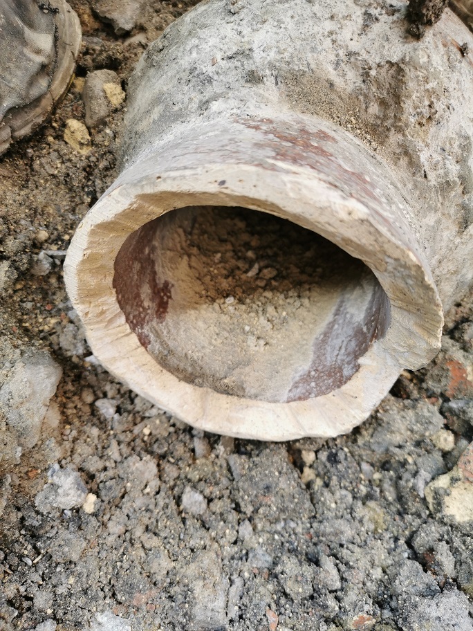

Carefully cut the pipe somewhere around the mark, and then you can left the gulley out and get rid. Put your clay to plastic adaptor on the cut end, then see what you've got. May need a very slow bend to get you right for the rest bend, we'll see.

Thanks Hugh, fantastic, i'll cut that now, and then let you know....many thanks
Hi Hugh, the first piece of pipe you said come off had cracks in it, i noticed this after i cut it, but it wasn't through the cut, they were already there, so i pulled the pipe, and it broke away, taking a piece out the final chamfered part you can see in the picture, the rubber flexiseal covers that broken part, but worried about snagging, and the other picture you can see where i am at the moment withy it all, that Gulley was set in a block concrete haha thanks Hugh

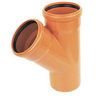

That's all ok, remove that debris from the pipe though, you dont want that getting washed into the drains. May need a very slow bend coming off the junction, might be better swapping that junction for one with a spigot outlet,

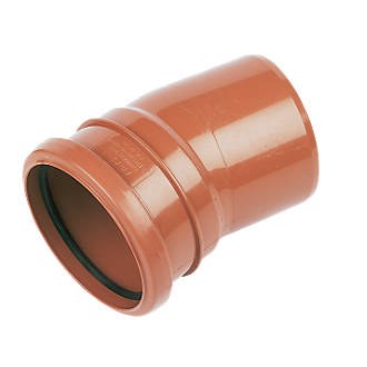

then a single socket slow bend,

Hi Hugh, That's great news, i'm finally on the right path, and all through your help Hugh, thanks, i was going to stick a tiny bit of pipe in the end of the i have got, can i not do this? or just buy one of those you put up, and do you have any idea of what that slow bend is?? like for e.g, you can get a 87.5 fitting, i have typed in slow bend, but can see anything that looks like that slight angle, my only other concern is, the setup you can see, needs to be raised to get the runoff gradient, trouble is then, the end that will will going to the waste roddable access, leans forward slightly. thanks Hugh
Screwfix links are working for some reason, item numbers are, 15° bend - 69177 (as in your link above), and junction - 22348. Junction is same as you've already got, only the outlet is a spigot, which can go straight into the socket on the bend. Spigot on the other end of the bend can go straight into the coupling on the clay.
It avoids having to cut and chamfer short pieces of plastic pipe to join the fittings, and given you're tight for room, allow you to get everything in place much more easily.
