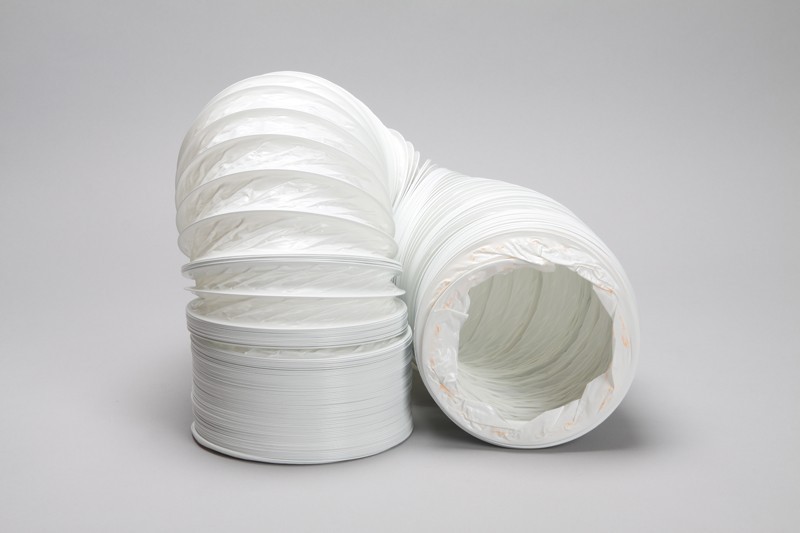

I see it the white or black as shown?
Just to be clear - this pipework is connecting a toilet to the external stack?
The photo you have posted is extractor flexible ducting.

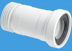

Is this the type of thing you're looking at?
I'm sorry to be dense but what is this pipework connecting to the soil stack?
Need to see the photos but sounds like a bodged up connection to an exterior SVP (soil vent pipe). If the flexible ducting has been used to come straight off the top of the highest branch to the wet soil pipe to wc then it's a bodge.
I've come to the same conclusion. Possibly SVP has been altered/extended in which case as @dilalio has already said, it's a bodge and the leak could be either condensation or rainwater.
A photo wold be very helpful.
As stated a photo would be best for us to inform you of what to do next. If you do have flexible extractor fan ducting used in a soil pipe then it must have been a very temporary repair carried out by a non-trade.
