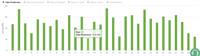

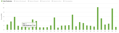

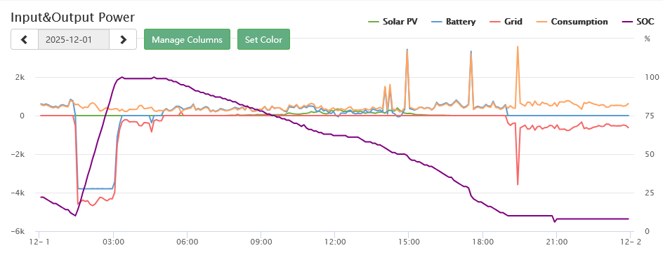

I tried to find out worse case, however the display will only go back so far, so from 16th January which is the limit I can go back, I have found one day 26th January where I ran out of battery at 5 pm, basic that day got no solar, for the days I can view, that seems only one where battery did not last until 7 pm. Looking at December last year
there were quite a few days when solar was awful, but June last year
excellent, so it is a case of taking rough with the smooth.
