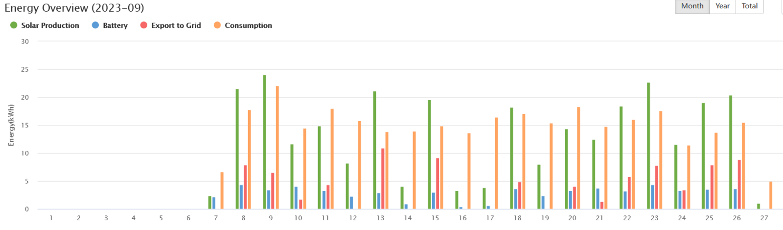

When people are referring to when to use appliances do you have batteries? I cant see me getting any discount on my electric bill since moving in as it went up. This is my meter
I do get an overview
But it does not help that much, one would think if the green line is higher than the orange line one would be using nothing, however it is down to:-
1) When the battery has enough so no import for low use.
2) If the spot use exceeds the combined solar and battery.
3) When the battery runs out.
So today dull, still importing at 10:30 am, but on brighter days by this time running completely on solar except for heavy loads like showers. But batteries are expensive, a second would mean importing less, but the question is would in pay for it's self considering a 6 year life on the battery?

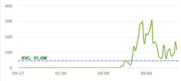

Today solar is very low around 350 watt, but some days 5 kW, so today the solar iboost and the battery are doing very little, my software shows the solar output 1695809635074.png but without that data can't see how you can work out what will help?
