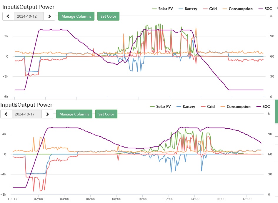

Main gain is the battery, I went for 14 panels, an inverter, and a 3.2 kWh battery, I see 5 kW some days, but also had bad days, Before and after second battery.jpg the two patterns are top 3.2 kWh battery, and below 6.4 kWh battery. The battery does three things, one it bridges the gaps when a cloud comes over, and two it allows use of off-peak during peak times, and three it allows selected items to continue working when you get a power cut. In my case, central heating and freezers.

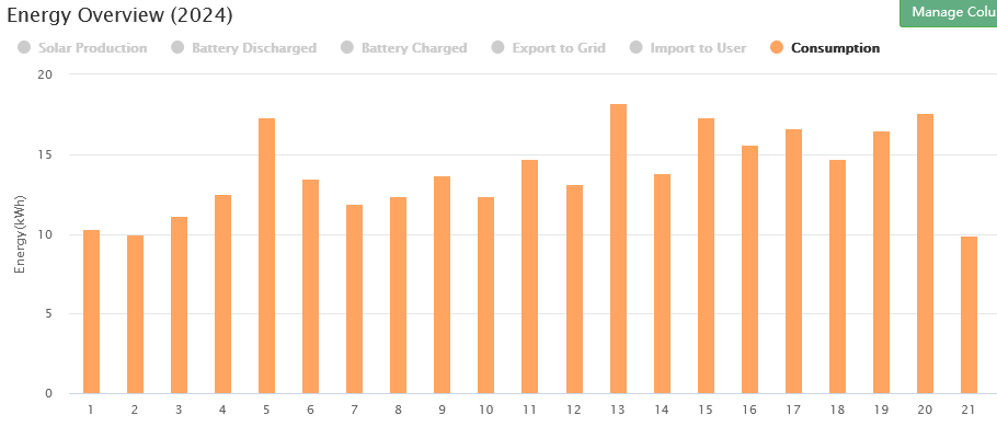

So I would say look at your daily minium use, not worried about using shower, washing machine, dishwasher etc, as you can adjust your times when you use them, so looking at my usage 1729528818500.pngrarely below 10 kWh per day, so I need around 5 kWh of battery, since 10% held back for emergency use, my 6.4 kWh is 5.76 kWh useable, maybe not quite enough in heart of Winter, but more than I need in the summer.

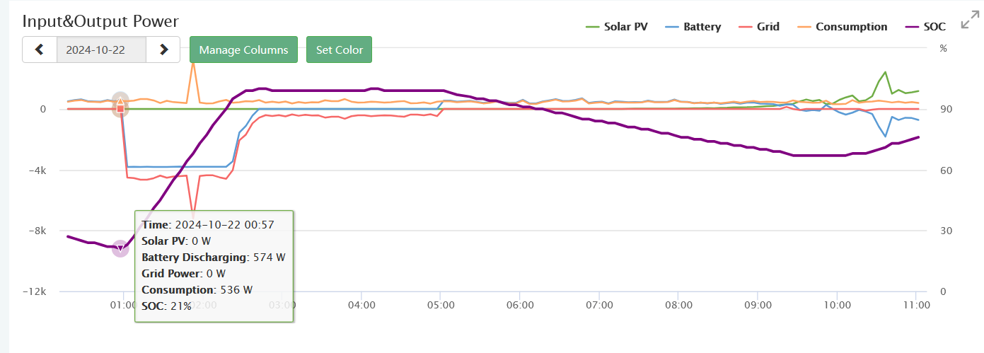

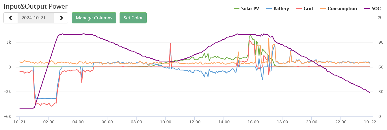

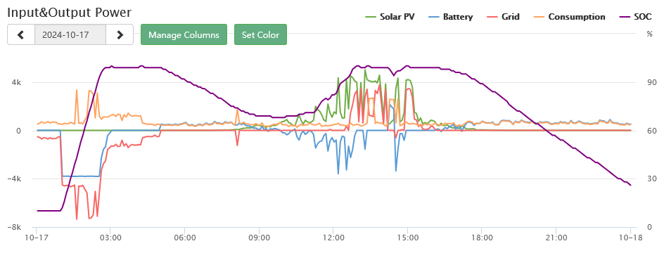

Look as purple line 1729529113849.pngthe state of charge, that day we got very little solar, the 16th but to have batteries big enough to cope with that, not likely to get your investment back, next day 1729529261165.png more typical and the second flat top is where I was exporting, 4.5 kWh that day. And still after a year not being paid for export.

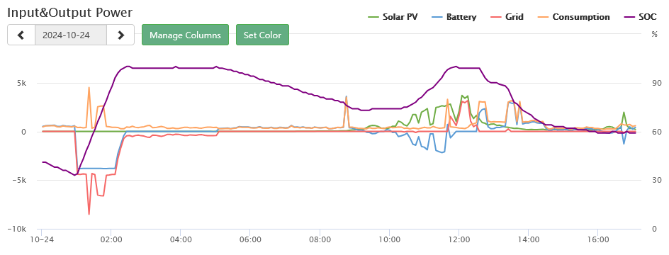

This is what I aim for, the battery did not fully discharge (drop to 10%) and the sun has taken over at 10 am, recharging the battery. The day before 1729591858926.png we were sitting at 10% before off-peak came in, but the time that we were exporting was short, 2.3 kWh in total, and it is the variable nature of solar which results in the need for a battery as well.

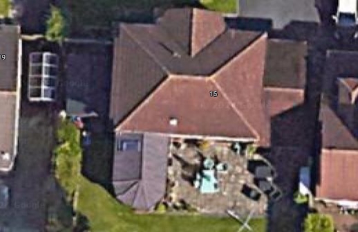

I have a low roof which means I can only fit 5 panels on my south facing roof and 3 each on my east and west faces (total 11).
Feedback from potential providers have different solutions.
One option includes microinverters which ensures each panel works independently so any shading on one panel does not affect the performance of the others.
Another cheaper option states my x3 roof faces would have 3 strings of panels. This suggests any panel in the shade would affect the performance of all panels in that particular string.
Now waiting for detailed proposals to establish performances.
It will be interesting to establish whether their performance figures reflect the reduced performance of my west/east facing panels compared to my south panels.

This is my house with my rear garden facing south. Unfortunately the white blob on the south face is my vent stack.
Talking to providers, it appears that they use google maps to determine the m2 of each face to calculate the number of panels
( all subject to site visit obviously).
Not keen to use my garage roof as it is only single storey and is in partial shade from the neighbour's house in the morning (as shown) and by my own house in the afternoon.
Initial feedback suggests 5 panels (south face) and 3 panels each (east/west faces)
sounds reasonable. you will get a nice constant feed as the sun moves form east to west. I have 3 panels south facing and 5 panels south east facing. so in the afternoon generation goes down quite quickly as the set of 5 gets shadowed early.

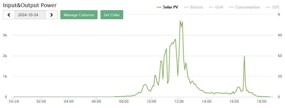

out of interest.. for today, what is the total solar generation today? so excluding grid charge, basically the cumulative total of your green line.
is this what you are after? That is to 18:40 as said not a good day for solar, wife did run washing machine and tumble drier, not sure about dishwasher. The battery will not work in isolation, it uses the same inverter as the solar panels, but we have saved more money based on investment with the battery to the solar panels.
Or was this 1729792118936.png what you were looking for, it shows how good the morning was, and how poor the afternoon.
