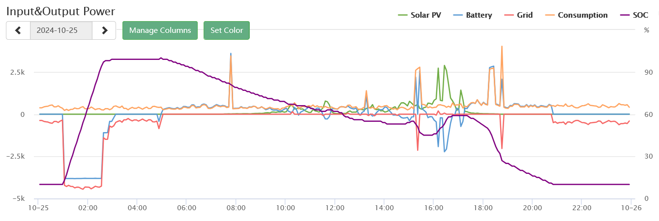

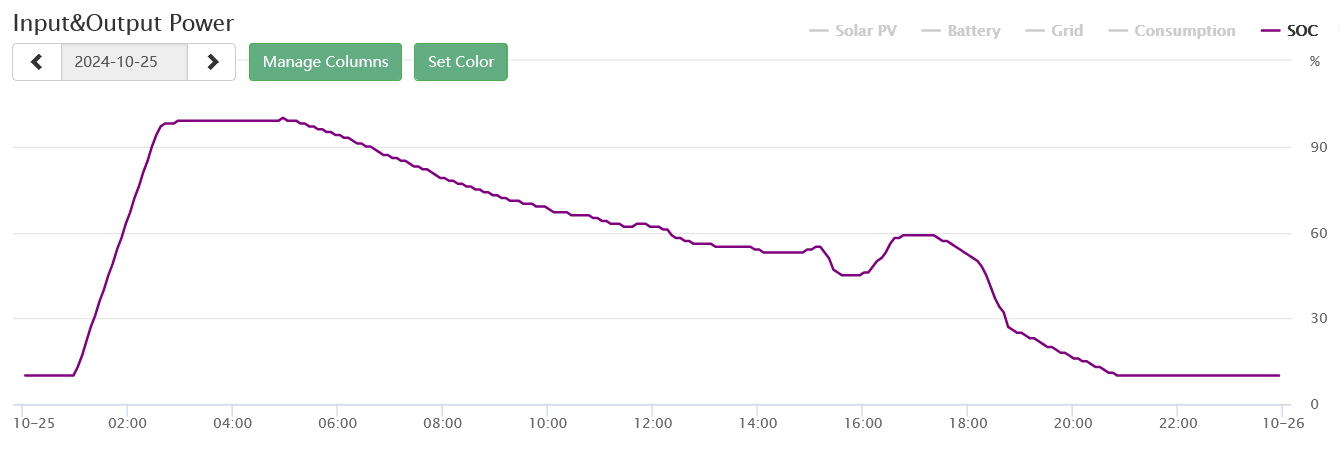

is typical state of charge curve for the battery, the drop 5 am to 12 noon rarely gets near to the 10% cut off point, the evening it happens less now with 6.4 kWh to what it did with 3.2 kWh, but that curve can easy hit the 10% cut off point (reserved for UPS in case of power failure) before end of day. Yesterday for example 1729939265254.pngran out of battery before end of day, and unlikely any amount of solar panels can help when there is a lack of sun.
It is easy to miss judge the day, showing all factors 1729939443478.png we did do some cooking which did not help, but there is a balance, my batteries have a guarantee for 12 years, so need to pay back in that time, solar panels can last a lot longer, so to have enough battery not to ever use peak power would not pay, I expect as the days get shorter to have more and more days when the battery does not last out, I with my system have an option of 1 to 4 batteries, at fitted £1,200 each, and they are 3.2 kWh each, one was essential, but as to second, waited a year to see how it went, then got the second, once sure it would pay for its self. I don't think will ever be worth getting a third or forth unless I get more payment for export to what I pay for off-peak.

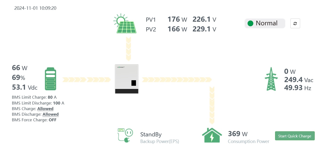

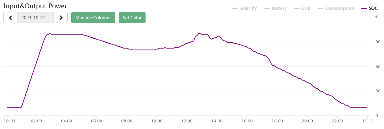

Yes that is on going, still trying to sort it out. Today looking at solar production since clocks went back, and when off peak runs has changed I realise last year did not have a smart meter, so no off peak, the result today is one looks at the battery slowly discharging in the morning. Morning 1st Nov.jpg I realise some days I will never recharge the battery during the day, good in one way as it means not giving away energy, but also means one will likely run out of battery as I did yesterday 1730457517318.png so one is looking at use v battery size.

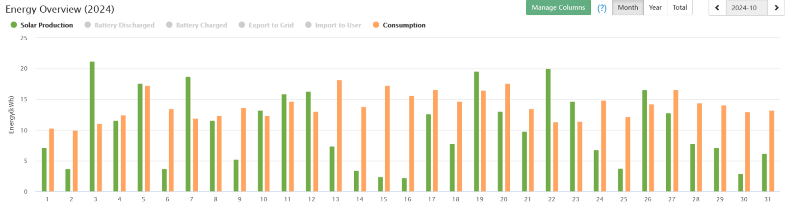

Last month we clearly got it wrong 1730457807098.png we did not match the use to solar production, theroy is OK, but in practice if there is washing to be done, one want to do it, and on dull cool days one wants a hot meal, so even with double the battery to what we had last year, still not getting through the day with out using some peak power.
So 2023 and 2024 but does not show how much peak and off peak, not counting standing charge 2024 month 10 bill £39.39 for 282.26 kWh so either solar or smart meter is out a bit, but average of 14p per kWh I would say around 63.183 kWh peak and 219.077 kWh off peak in October 2024. Second battery fitted 15th Oct 2024 so really need to work it out for ½ month, but as the sample gets shorter more down to weather than how battery has helped. And BG app gives day or month, not ½ month.
Before second battery it was around 50% peak and off peak, after around 18% Peak and 82% off peak each battery around 3.2 kWh. Clearly moving into winter so 15 days used to get average, which could be as much to weather as second battery, but unlikely.
