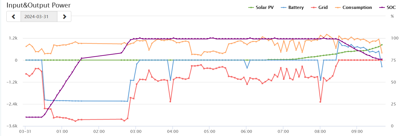

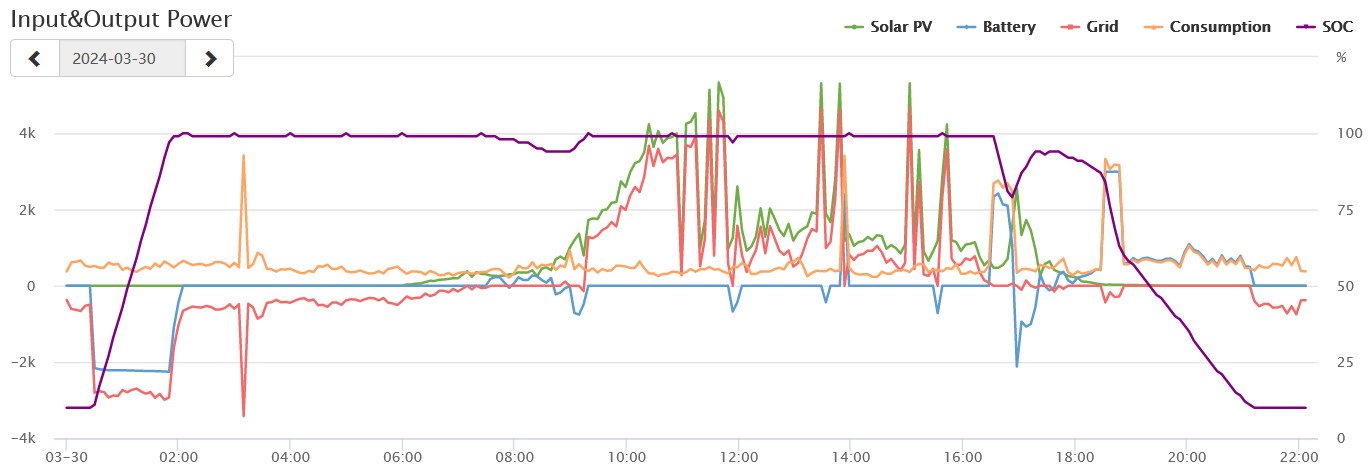

I know my panels are rated at 6 kW and my battery 3.2 kWh and max charge is 2 kW and max discharge is 3 kW and also LUX. As to how much the inverter will handle I have not really looked, my display shows this
From 0.30 am to 7:30 am battery is being charged, so start the day with fully charged battery, but clearly over around 6 kW even in sunlight it will draw from grid, but this only happens when having a shower, so we were using cheap rate or solar until 9 pm today. The time from 9 pm to midnight we don't use much power, I have set tumble drier and washing machine with a 3 hour delay, so they will not start until I get into the cheap rate.
Solar produced 17.5 kWh's of which 11 kWh were exported, but costing is hard, it shows imported 12.2 kWh but it does not say what was at 8.85p per kWh and what was at 31.31p per kWh and the phone app is only showing total kWh not the use in £ so it is a bit hit and miss, we should get 15p per kWh for exported power, but not seen any payments yet.
So one battery should pay for its self, but a second one is uncertain as to if worth while, the inverters seem to be rated for maximum battery discharge rate there is a 4kW, 5kW and 6kW version, but my battery is limited to 3kW so it really does not matter what the inverter can do, in my case the battery is the limiting factor.
Since I should be buying at 8.85p per kWh and selling in the day at 15p per kWh it does not really matter if I start the peak time with a fully charged battery, and being fully charged means if we get a power cut central heating and freezers will continue working unless power cut between around 6 pm to midnight depending on time of year when battery may be already discharged. It holds back 10% but that would not last long.
My thoughts are battery live around 7 years, so any pay back has to be within 7 years, one battery no problem, but with two in heart of summer likely not needed and in winter not enough solar to fully charge them, so the gain is the over night charge only, and not really done the maths to date to if worth it.
The purple line seems to be capped at 4. What is SOC?
What is the brown line?
You mention a power cut. Surely your inverter will close down? Or do you have an off-grid socket for the freezer?
Purple is power in the battery or state of charge (SOC) brown is what I am using.
With a power cut I have one FCU and two double sockets still powered, they feed the central heating and freezers only, did think about lights, but running in my living room 100 watt of lighting during a power cut is not really a good idea, so use plug in rechargeable touches which auto switch on in a power cut.
The inverter also connects neutral to earth during a power cut, so I have a TN-S supply, when there is power it is a TN-C-S supply.
So the inverter will island for essentials, but would loose most things, the main CU would go dead. If sun light then the freezers would likely work for weeks, the battery being charged in day to keep freezers running, but if it happened in the evening when battery down to 10% then clearly it would not last long. Uncertain what would happen when the sun came up, never tried it, but when smart meter was fitted the central heating was still running. Clearly the thermostat and every thing else to do with central heating needs to come off the one supply, using USB to power a thermostat is clearly not going to work.
