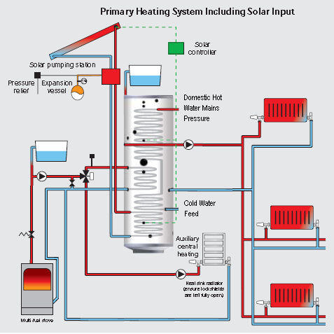

You can get mains hot water pressure without pressurising the cylinder. Torrent pipe example.PNG However, the systems can be rather costly, and I am no plumber, so I will let the experts expand on this.

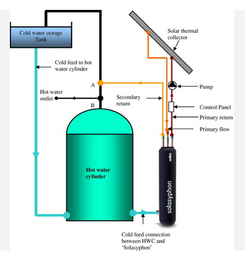

There are a few methods to use PV solar panels to heat domestic hot water (DHW).
1) The iboost+ can use spare solar power to heat the DHW.
2) The Willis system allows heating the cylinder from the top down.
3) You can run two immersion heaters from the iboost+

You can get mains hot water pressure without pressurising the cylinder. However, the systems can be rather costly, and I am no plumber, so I will let the experts expand on this.
Heat banks - a modern take on what is basically a thermal store with more modern kit.

The other method is to fit the immersion outside the tank, with the Willis system, this results in the tank being heated from the top down, theroy wise by far the best system, however unless you live in Ireland, finding a plumber who knows how to set them up, may be a problem?
This is a question for @Madrab is it likely a mainland plumber knows how to install the Willis system? I am sure @Madrab does, I feel from his posts he is a very knowledgeable man, but what about the run of the mill plumber?

Gosh, there's a blast from the past Willis, haven't seen one of them for years, certainly not a standard - I would reckon there would only be a few that know about them and ever fewer that have ever fitted one. I have only ever fitted 2 of them and they were replacements. They are generally superceded now and are pretty old tech. Could they find a new life given renewables/self generated energy, possibly but there are more efficient single package solutions now and they can only be used with Vented systems, if I remember rightly.
We actually looked at them when I was doing my papers, like 35odd years ago - those were designed to draw cold from the bottom of the cylinder and through convected flow transfers the heated water up to the top of the cylinder. Typically those cylinders only had a single full length element and this was a way to time heat just enough water as a boost for low HW use requirements say for dishes, basins, maybe even a quick shower without heating the whole cylinder.
Willis is marketed as for use with solar
I think the main thing was it would work with tanks with no boss to take an immersion heater. I know quite common in Ulster, but do not seem to have left the island to any great extent. The version with an immersion heater
again it seems only used in Ulster.
Ah right - that's a different thing. The original Willis was/is basically a metal can with an electrical immersion element in it. Can certainly see the benefit of a solar PV feeding the element but hadn't seen a Solar Thermal version - called SolarSyphons it seems. I guess things have moved on since I've come across them.
Must be honest, it's always good to see old tech being repurposed for modern use, sometimes is shows that we don't need to re-invent the wheel to bring things up to date, though it does look quite a niche product TBH.
