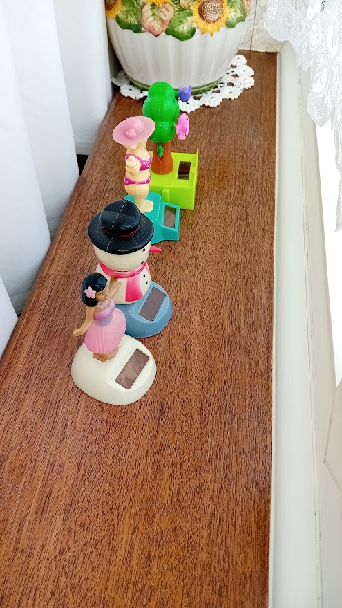

Is it not apparent that the only reason I've been 'playing' with these ridiculously cheap toys is to get an initial feeling as regards the viability of generating a useful amount of solar energy with an indoor ('through window') solar panel
Yes it is clear to me.

Is it not apparent that the only reason I've been 'playing' with these ridiculously cheap toys is to get an initial feeling as regards the viability of generating a useful amount of solar energy with an indoor ('through window') solar panel - something which many thought was probably a non-starter when we discussed this last year.
I have now ascertained that, in roughly mid-summer, a 'useful' amount of solar energy can be generated even with a tiny indoor panel.
The next experiment will involve a much larger solar panel. probably with a much higher voltage output, to enable me to determine how much solar energy I can reasonably generate, particularly as the days become shorter. Armed with that information, I will eventually hopefully design a definitive system, with a solar panel of adequate size, and with a battery of appropriate capacity feeding appropriate light sources, probably with some sort of 'control system.
