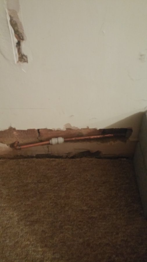

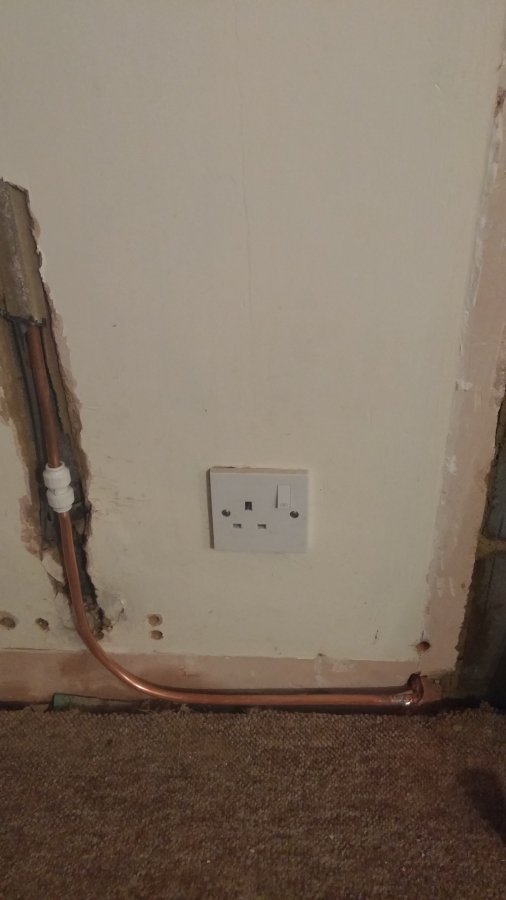

Cheers for the suggestions. This wall is going to be concealed by a kitchen. I'd still rather not go chasing the pipe up the wall in case I damaged it.
I won't have access to anything to freeze it, but I have bungs and an old vax wet and dry vac which maybe could be adapted to suck out some water.
Job done, in the end I bunged the header tank and done one side at a time.
I chased the pipe up and on the other side chased horizontally cutting off the existing elbows. For times sake any potentially wet joints were done in speedfit as it will be concealed by new kitchen units and the rest in copper on the other side of the wall where it will be visible.
Two 10mm chrome speedfit service valves (seem to be the only ones) on the other side for when rad goes in later.
Thanks for all advice,
Dan
Got any pics of the finished article?
Could have got away without the speedfit but I'd already bought it in case of drippy joints. Haven't done any soldering in about two years which was a bit nerve wracking.
It isn't pretty but seeing as the kitchen's going over it it serves its purpose.
