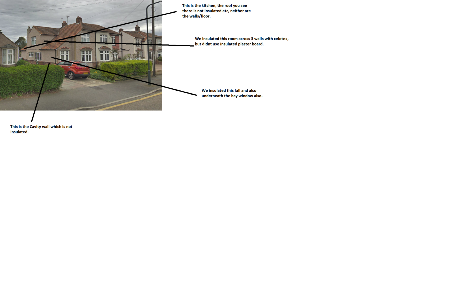

The huge extension massively improves the u value of the house, as the upper part of the house will be wrapped around 100m of insulation with insulated plaster board on top of it. I want to use the opportunity to see what I can do to improve downstairs also.

Yes we do, even though they dont look nice at all. Once the works are done, the plan is to have shutters. I dont know what they are like.

Definitely, I plan to demolish the kitchen and build the wall again, this way proper insulation.

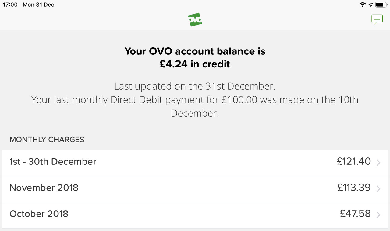

We have ours at 23.5/24°C and people comment that that is high although I suppose it depends on (a) whether your thermostat is accurate and (b) where it is fitted. Ours is a new digital one (although the analogue one it replaced read the same) fitted in the lounge on the wall opposite the radiator with no other heat sources nearby (TV, lamps etc). It is fitted about 5ft from the floor. Go a foot higher or lower and the temperature will be a good few degrees different. Our bills are £100 a month throughout the year and we are never cold. 3 bed 60’s semi. TRV's in all rooms except lounge. Hot water on constant, heating on 5:30-8:30 am and 1:00-10.30 pm weekdays and all day at weekends.
Edit: Looks like I’ll be behind with my payments next month. Lol.
(We were on holiday for a week in October so nothing much used that week).
Being a 60's house, would I be correct in saying you have got cavity walls ?
We have the heating on at internals when we feel the temperature drops, say 17/18 etc. When I went to a house that was extended in the way I described, it was so warm with no heating on for a long period during the winter/spring.
Yes, but just the flank wall which has cavity insulation. The front and back are windows from wall to wall and the 'wall' between the top and bottom windows is some sort of foil backed board that has been rendered. Loft insulated.
