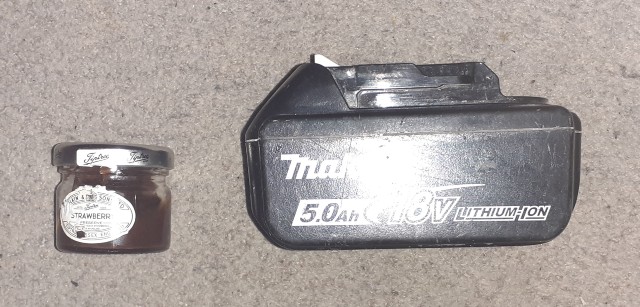

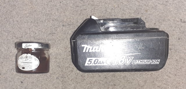

Who keeps marmite in their toolkit?
Well, when I'm locking out, I do - in one of those tiny one portion jam jars you are offered when you have breakfast in a posh hotel:
(Taken from my tool kit not 10 minutes ago)
Don't you have a lead pencil?
Yes, and I even still have lead in my pencil ;) ... But I don't ever use those stupid, big, numb so-called "carpenter's" pencils which are a pain to sharpen and which simply can't be used for accurate work. Anyone turning up to install doors or ironmongery with one of those gets first fix, if there is any, or is politely shown the door. I also find that graphite doesn't transfer well to newly gloss painted surfaces - but Marmite (and for that matter axle grease) does.
