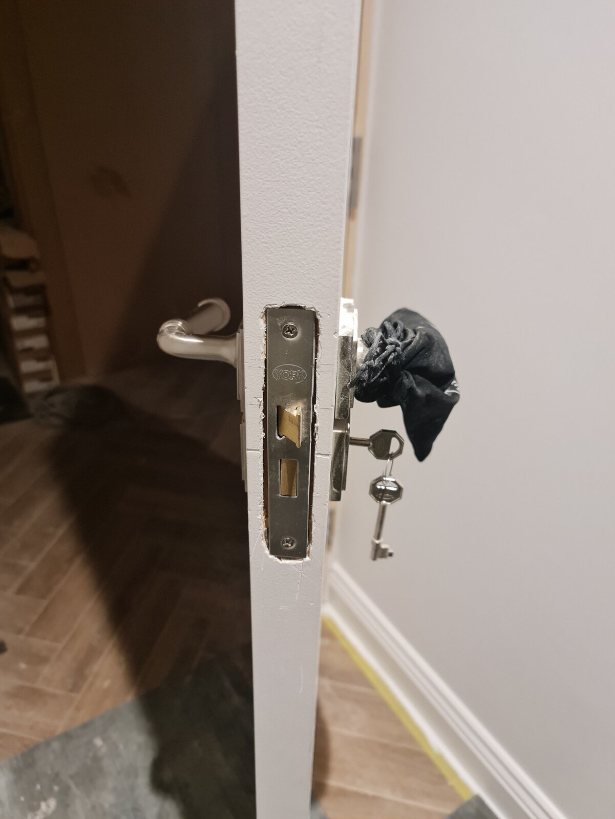

Used it for the first time yesterday. The door was a cra.p hollow door. It definitely made the slight rebate, and main rebate more accurate.
My choice of drill, however, is far too heavy. It is an old Metabo 705w drill. At a guess it is over 2.5Kg and quite long.
I had to use my hip to apply pressure whilst guiding the drill up and down. One hand to hold the trigger, one hand to hold the round uppy downy guide. Unfortunately, my hip is not the most accurate when it comes to applying the correct level of pressure

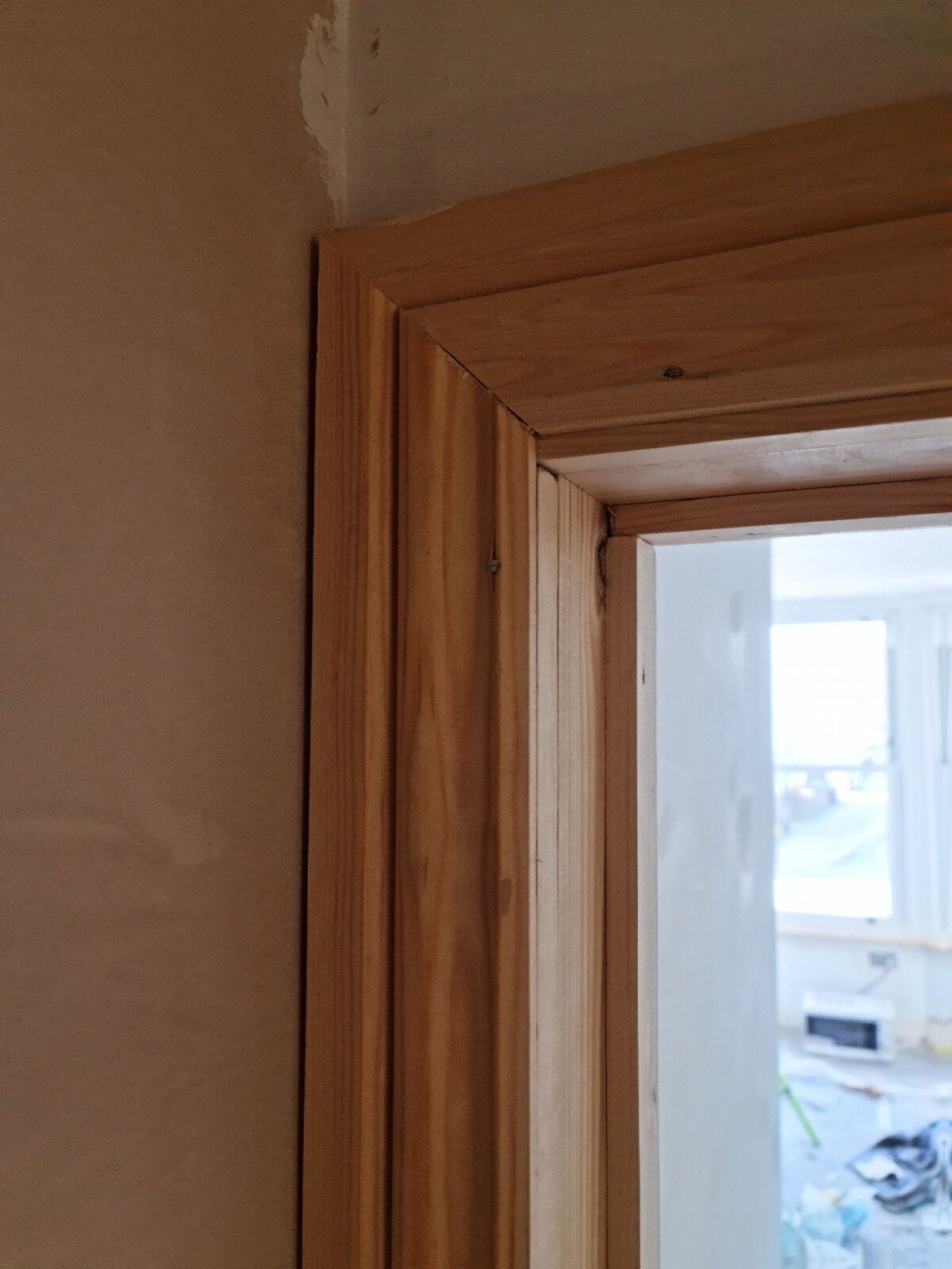

The above is not the only face palm moment. Door architraves with joins half the way along (unglued joins).
Architraves that don't maintain a constant distance from the door liner.

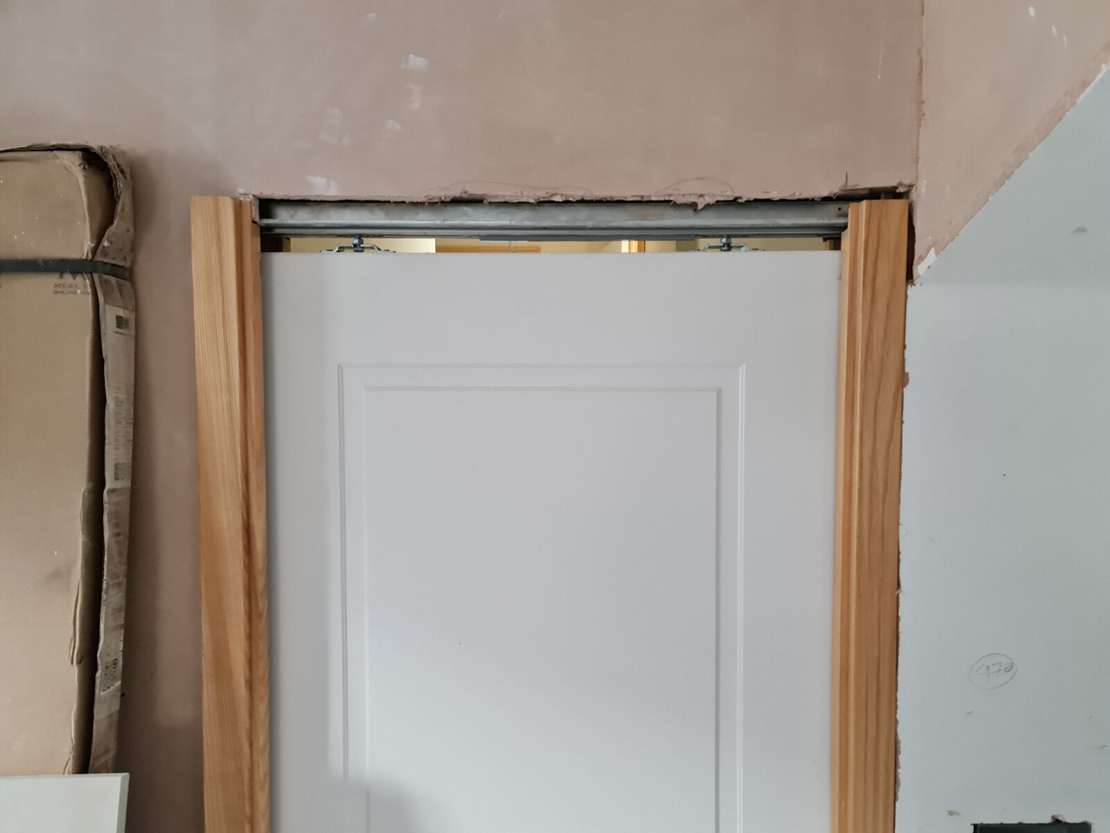

Pocket doors that can't be fully closed because the customer specified finger pull handles that are flush.
Pocket doors, the frame of which has been cut in to the plasterboard on one side but not the other.
