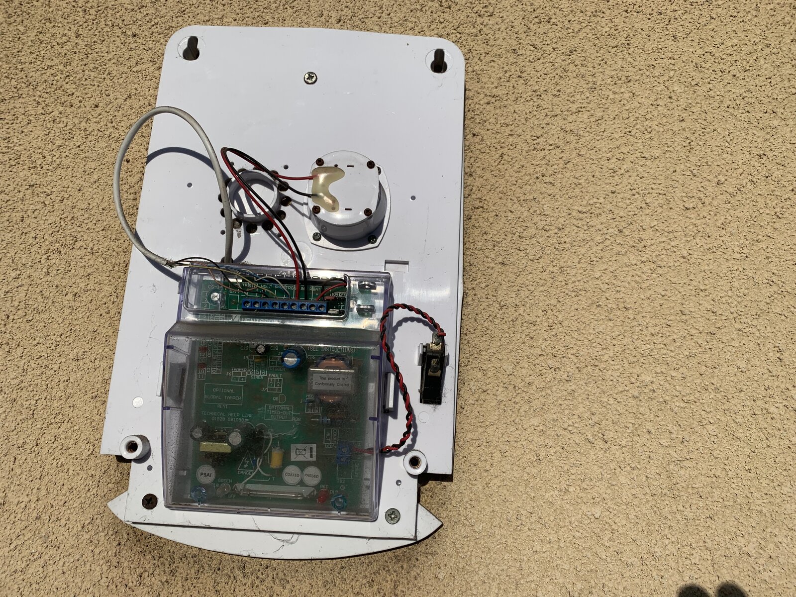

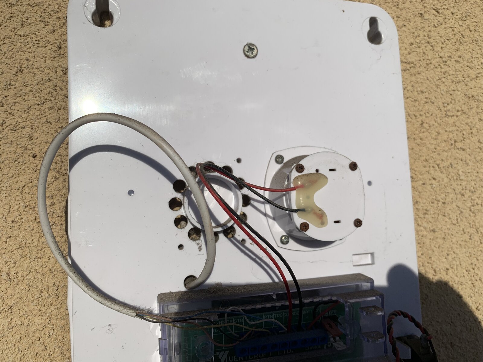

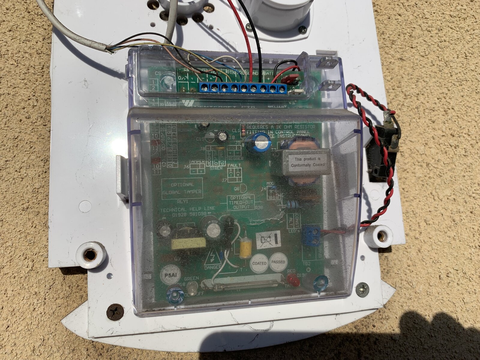

Please see the photos below of the inside of my sounder.
After removing the front cover, it didn't sound but it all looked pretty clean inside with no evidence of any water ingress that I could see. All of the cables are intact and there didn't appear to be any signs of corrosion on any of the cables either.
I've left the front cover off for now, just in case any additional photos might be needed.
Did you pop out the pcb and check on the back for water damage ? Might be wise to replace the bellbox
