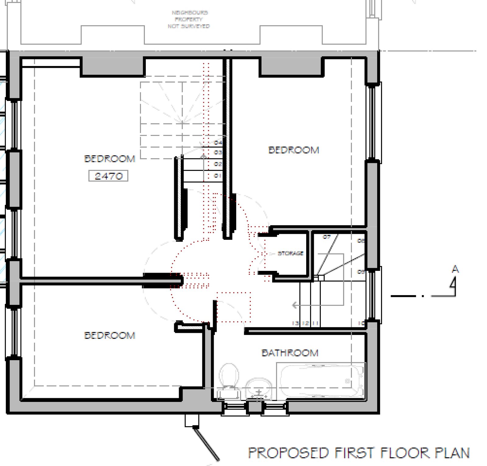

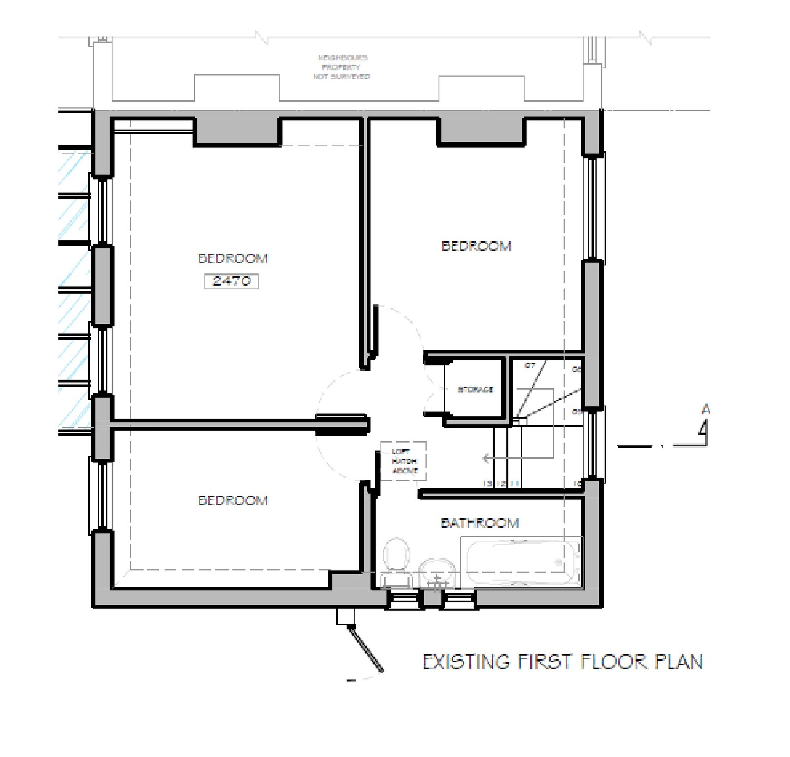

Space saving staircase to loft

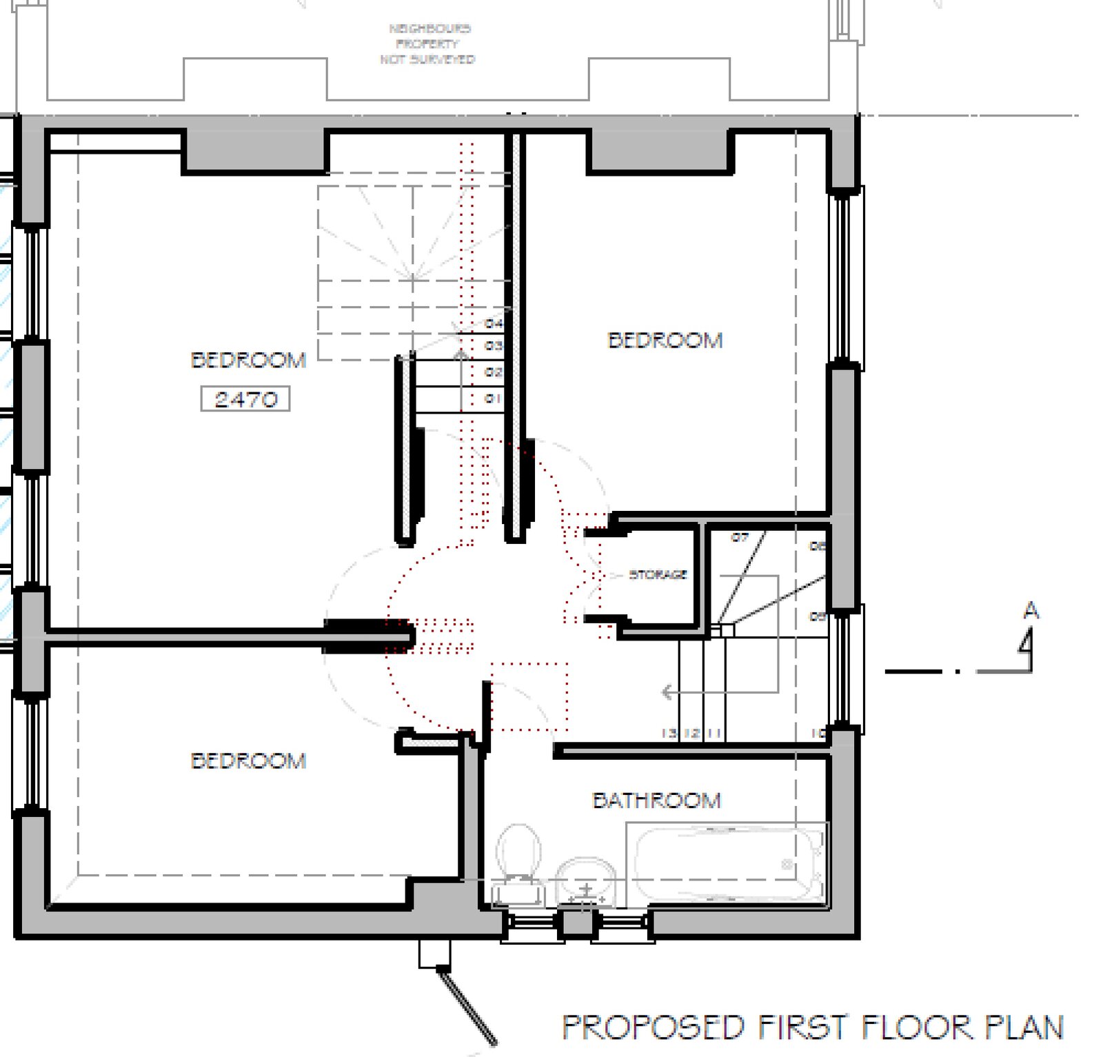

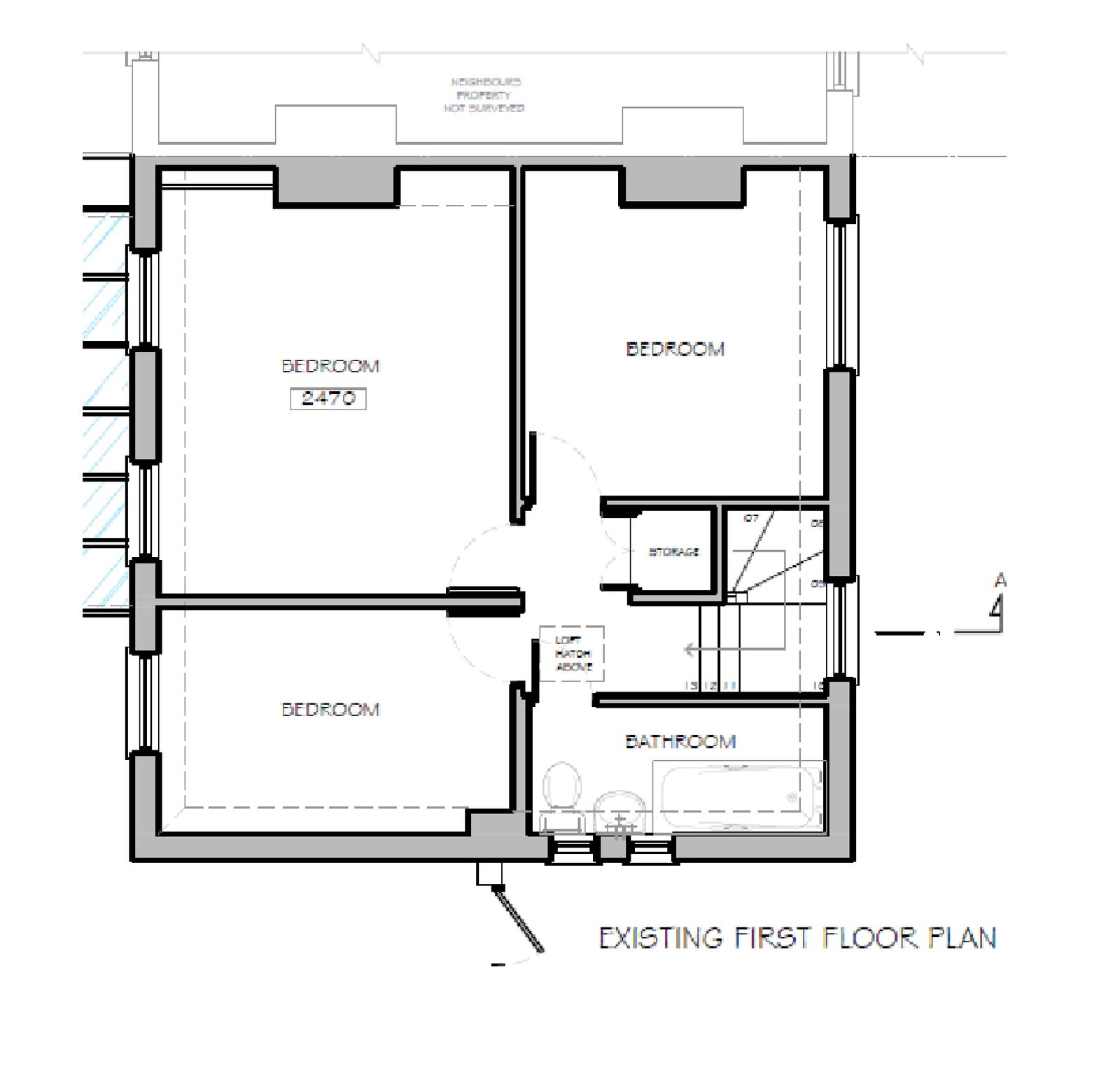

Sorry for the delay but been chasing for the drawings from the architects. He's drawn a proposal of where he thinks the stairs might go. Involves taking spaces from the 2 bigger rooms to reduce the impact on the medium room.
I'm thinking that the alternating tread staircase will fit in the space where i have storage area beside the existing stairs. It'll be a squeeze but i think it'll just about fit.
no expert but dont you need a space about+50-75% larger than the tread width on a space saver so an opening would be 600xsay 1000mm ??
