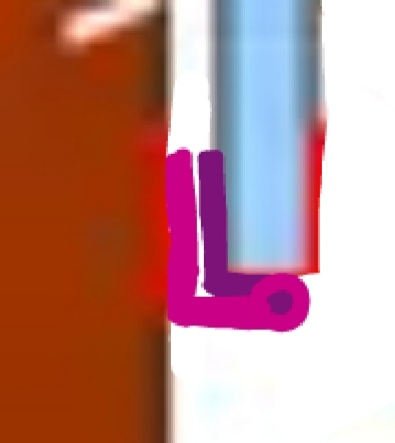

I wondered if there would be enough offset, if they were mounted like this?:

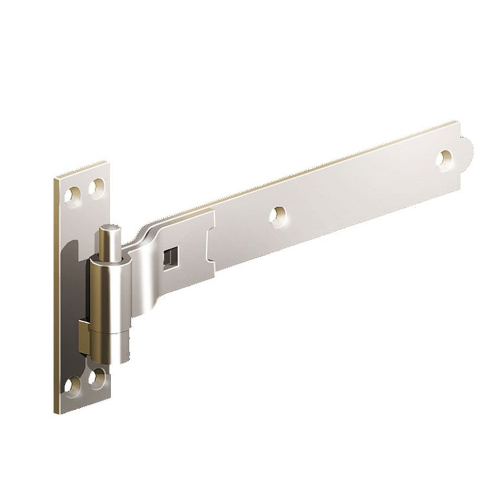

I wonder if a cranked hook and band hinge would do? It puts the hinge pivot outside the plane of the door or hatch.
Galvanised ones are very durable if you paint them before fitting.
Yes, I suppose that is a definite possibility - I need to look carefully at the dimensions - and, as I said, there are lots of them around (at sensible prices) for me to look at and choose from.

I wonder if a cranked hook and band hinge would do? It puts the hinge pivot outside the plane of the door or hatch. Galvanised ones are very durable if you paint them before fitting.
Thanks. Yes, I've been getting a lot of variations on that theme whenever I search with 'cranked' in the search term, and have been pondering whether I could easily make use of them.

I found a few with detailed dimensions, and it looks as if they might well work. Nearly all the ones I've seen have been 63mm (2.5") but maybe three or four of them would do the trick. Most are dirt cheap, so I'll get some and do some playing!
Thanks again. As I said, I'd looked at these quite a bit, but didn't get my head around how they could be used to achieve what I wanted - I think I had the fixed idea in my mind that the leaf of the hinge would have to attach to the outside of the lid - although I now realise that it's only the offset of the pivot point that matters, not what the leaf of the hinge is attached to!
