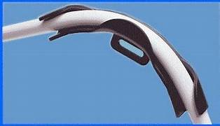

My question is with the speed fit, if I run it into the area where it needs to be how should I get it back above the finished floor level? If I was doing it in copper Id run it to the wall where i need it then chuck and elbow in the corner, lag it / lay on a bed of sand prior to screed ?
Does it simply 'bend u' in speedfit ? (with a curved rad of course? or can I bury a speed fit elbow in the screed?

Ideally you wouldn't use any connections under the screed, apart from soldered and even then they should be avoided. Alternatively you would have to radius the plastic up out of the screed hidden say in a cupboard or similar, certainly wouldn't put push fit elbows into the floor unless they could be got at easily. The other option would be to bury it in the wall.

When you say radius it up do you literality mean what you say? So clip it to the wall in a nice even sweep ?

Yes - you can get cold formers that will hold the pipe.
That makes so much more sense.
I can now T off the upstairs bathroom hot and cold (under the sink) gun straight out of the external wall, drop down the external wall (that will be dot and dapped eventually) cold form into the floor then bring them up again where the new sink will be.
I guess I just need to lag the speed fit pipe into another pipe by the looks of it though?
