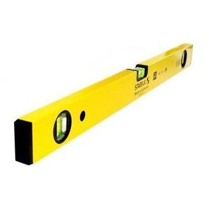

but isn't that the attraction with something like Stabila? You can be sure about what you are getting?

stabila 96-2??

Us brickies use a 600mm and a 1200mm Stabila. 50mm wide solid bar. Plumbing vial at EACH end. Horizontal vial in the top edge and NOT set in the middle of the bar.
Big thick levels are unwieldy.
Having a pitchfinder at one end means having to flip the level all the time. Utter pants.
Having the horizontal vial set in the middle of the bar is equally as pants. Us brickies use our levels a lot.
I use Stabila R-type levels for carpentry (several) - but I have a 96-2 magnetic 1200mm for metal lath, etc. Good level which whould last a lifetime and was accurate out of the box - one of the things you pay for

I ordered a Stabila from Screwfix as per earlier post but when I went for collection, I was informed that they are out of stock. Since I needed a level for the weekend, I checked on what was in stock and funnily enough it was the exact one you mentioned. Im very happy with its use thus far. Thanks
