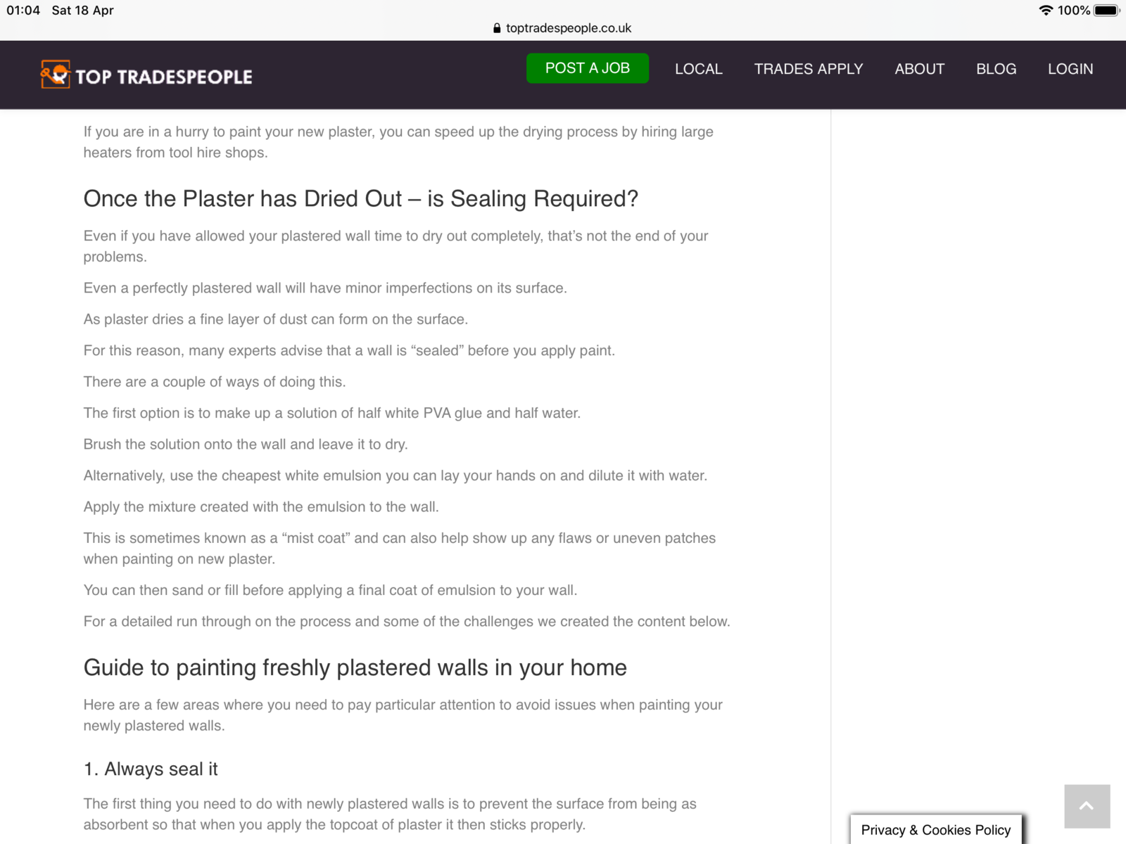

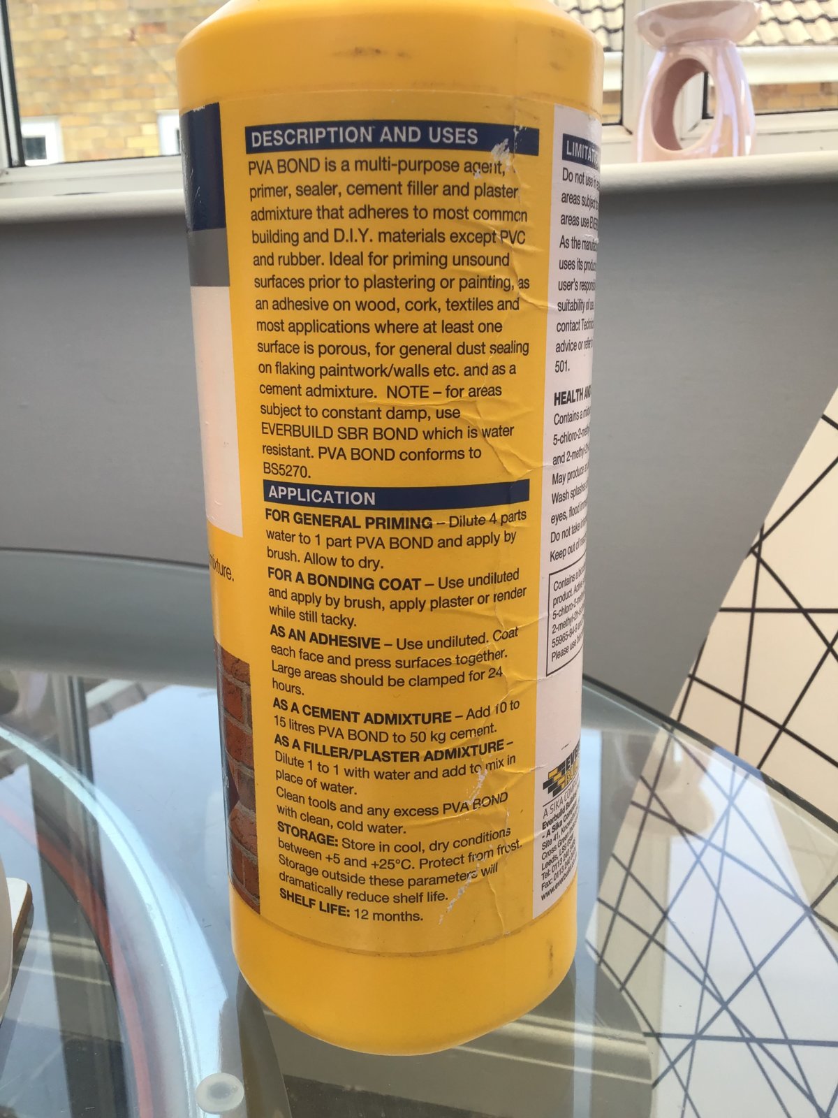

https://diy.evo-stik.co.uk/product/general-purpose-pva
Scroll down to the question about using it as a primer for paint and the answer is a resounding no.
I don't know why your Everbuild PVA recommends it's use.
I have no idea who wrote the article in your screenshot. Perhaps it was a plasterer. Actually I doubt it was a plasterer (and I seriously doubt it was a decorator), they recommend hiring heaters to dry plaster but omit to mention the importance of opening the windows to increase airflow. In my experience air flow is even more important than heat.
AFAIK PVA will invalidate most paint manufacturers warranties. I am happy to believe that it has never caused you any problems but I frequently see people recommending PVA as a primer for tiling as well. They claim that they have never had any problems. When you tell them that causes the formation of ettringite crystals they just repeat that they have never had any problems.
I can only imagine that the amount of PVA that you add is so low as to not be a problem. The fact that it isn't doing harm doesn't mean that it is doing anything positive though.
The following link demonstrates what happens if someone uses 1 part PVA to 5 parts water. The roller ends up pulling the previous coats of paint off.
https://groups.google.com/forum/#!topic/uk.d-i-y/GLD8mcnm_Hg
