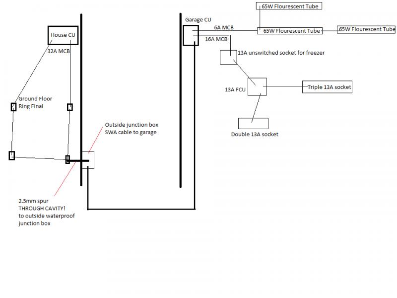

[In fact some people don't think that a potential 5kW load on one point of a ring circuit is necessarily unsafe.
'some people' , you mean idiots like you.
A bit of a dogs breakfast, it doesn't comply with regs, but is not necessarily unsafe.
BAS how do you get a "potential 5KW load" from that arrangement? Afaict other than the lights everything in the garage is going through a 16A MCB.
