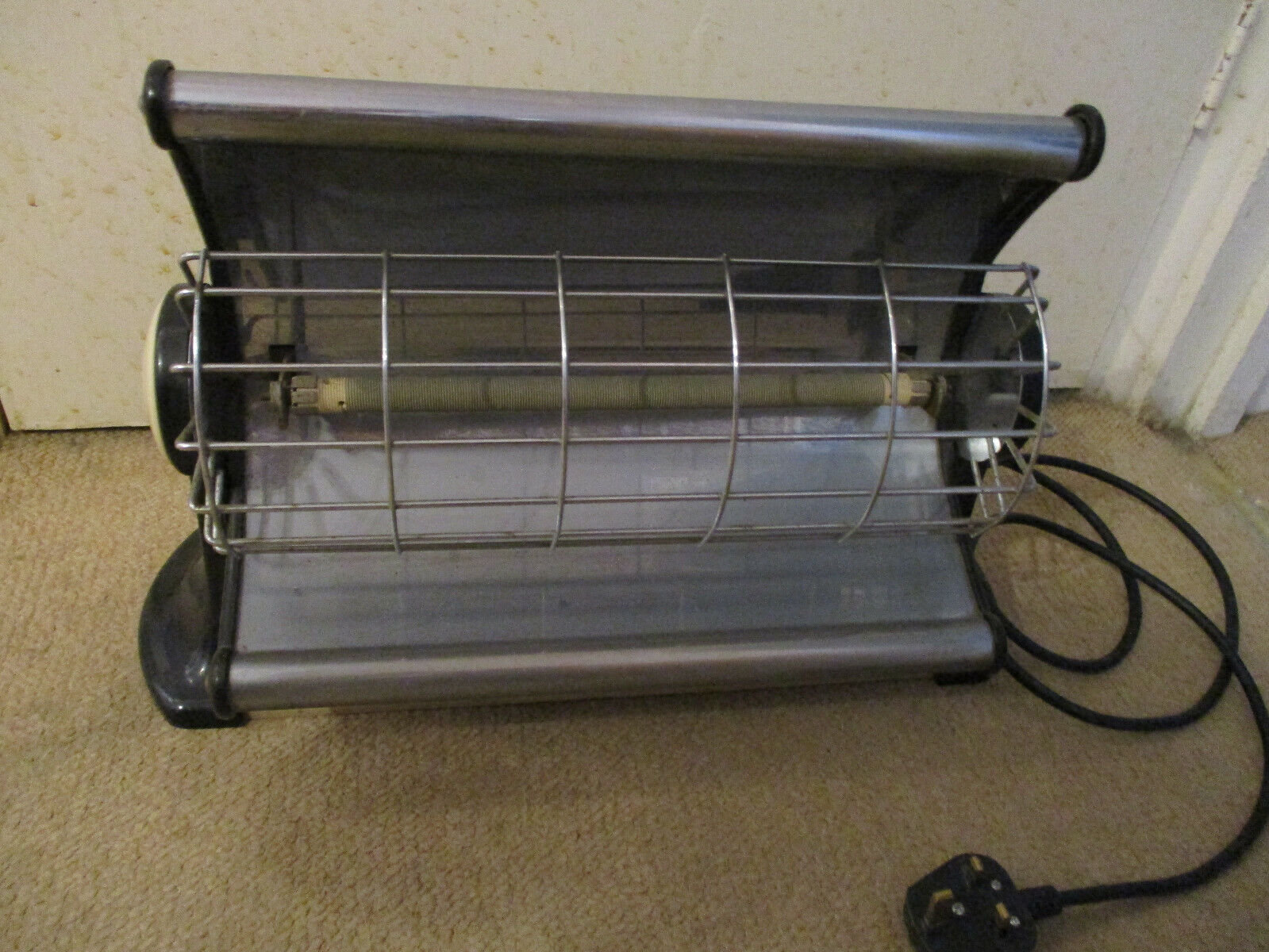

I think we are a similar age, so would have gone to collage at least first time around, around the same time, and we were told how the ring final was developed at the second world war to assist with the rapid rebuilding program, and shortage of materials like copper, and how the idea was to have an all electric house, with a 60 amp supply of that time, it was really a pipe dream, it would be like today saying we can all have electric cars and heat pumps, some times governments do need to come back to earth.
The idea we could heat or homes with these 1683360191370.png with no thermostatic control, single glazed windows, and no cavity wall insulation was never going to happen, and with the few home with all electric heating they had an independent supply for the storage radiators.

The idea we could heat or homes with these with no thermostatic control, single glazed windows, and no cavity wall insulation was never going to happen, and with the few home with all electric heating they had an independent supply for the storage radiators.
Exactly.
