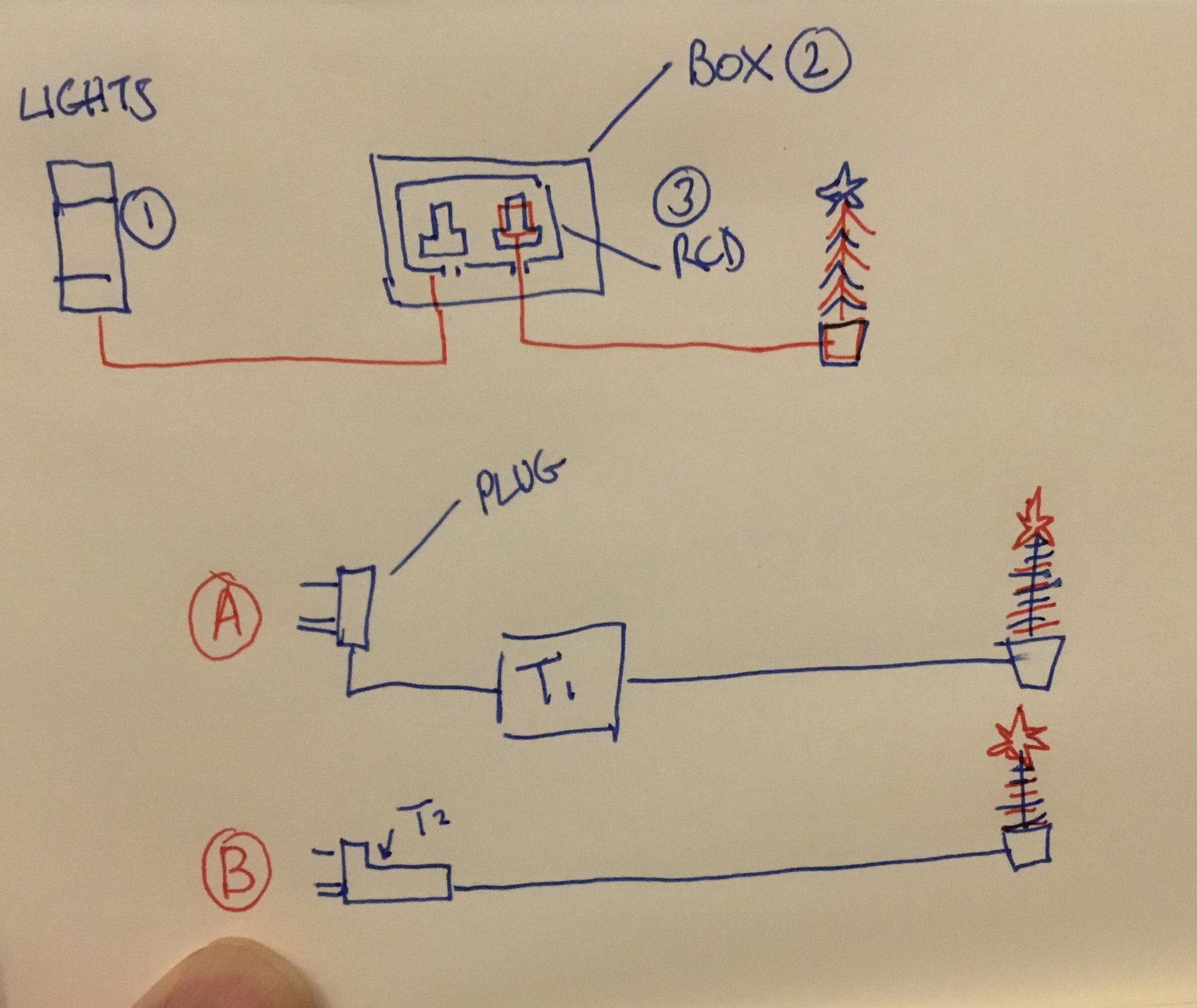

You miss the point. One RCD protecting lights and power ( from earth leakage ) will result in the hazard of no lights if an appliance develops an earth leakage.
Indeed, that is why at least 2 RCDs are recommended.

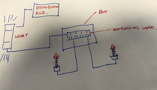

Please take a look Ebenezers
Spur from outside light
Run to waterproof box screwed shut
inside box (box under eves of house around 7 foot off floor) rcd twin sockets
Some lights have a plug and then a transformer, so would place that inside box
others have transformer in plug head, like a mobile phone charger
lights will be led
ok
do I need rcd sockets? House has a rcd board for light, sockets etc
What size cable
what power can be drawn. Only plugging in a few lights, but want to know.
