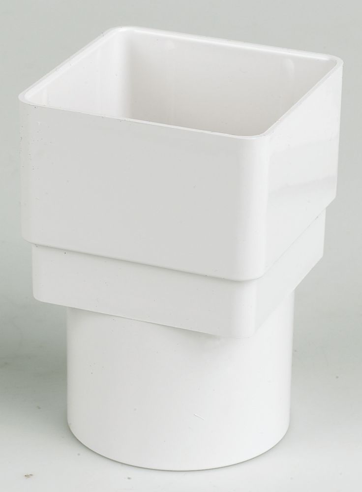

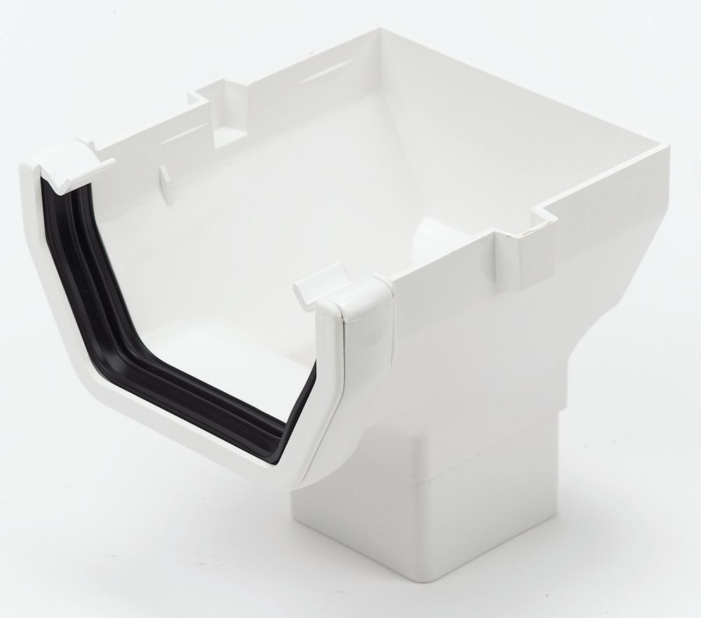

Hi there,
I'd be really grateful if someone could advise the best way to connect this:
ae235
to an existing round 40mm PVC waste pipe? I know I need an adapter (squareline to roundline) such as this:
ae235
but the problem is as you can see, the round outlet is still too big to connect to the 40mm pipe.
Any ideas?
Just incase you're wondering what I intend doing with it, believe it or not, I'm installing internal guttering to my leaking conservatory! And hooking it up to the kitchen sink's waste outlet :mrgreen:

one of these should fit.
ae235
Didnt realise you were connecting it to waste pipe,you will have to make something up

Incase anyone has similar problem, what I'll have to do is use "68mm - 50mm pipe reducer" and then use a very short 50mm bit of pipe to connect to a "50mm to 40 reducer" where I can then use a 40mm adapter to connect to my existing 40mm drain pipe. Not the best way but the only way it seems.

I'm getting a 68mm to 50mm adapter and then I will get a bit of pipe (50mm) and then on the end of that I will get an adapter so I can put the 40mm waste pipe on the end of that and go from there. Would this not work?
EDIT: Ok I think I get you, you mean the 50-40mm adaptor is for waste pipes only and can't be connected to the 50mm rainwater pipe. Damn. This is crazy! Ok what about using a hopper with a 40mm outlet (bet it doesn't exist)?
